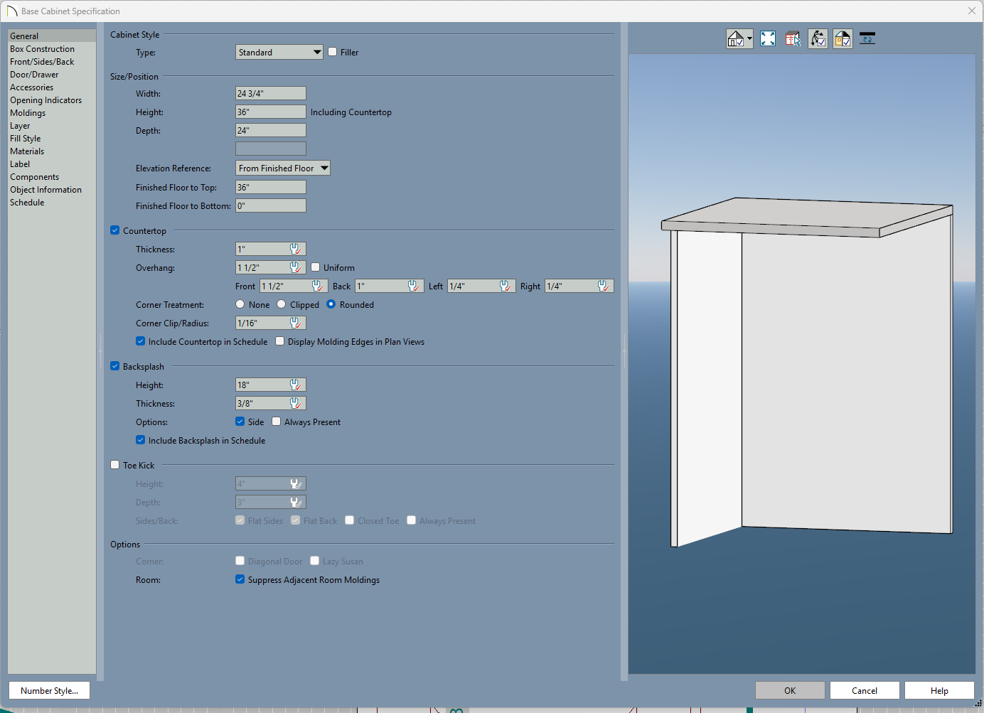

robdyck Posted August 27, 2025 Author Share Posted August 27, 2025 Link to comment Share on other sites More sharing options...
