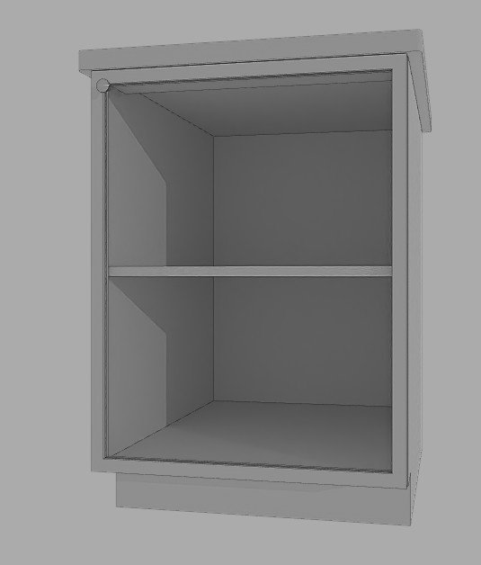

Ryan_M Posted August 25, 2025 Share Posted August 25, 2025 I'm using framed cabinet doors with "glass doors" option selected in x17. I'm trying to adjust the size of the frame to allow for a larger glass window in the door and can't for the life of me figure out how to do it. I can make them slab doors, but it's not really the look I'm going for. See attached image for reference. Thanks for any help! Link to comment Share on other sites More sharing options...
