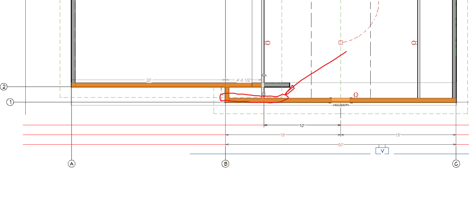

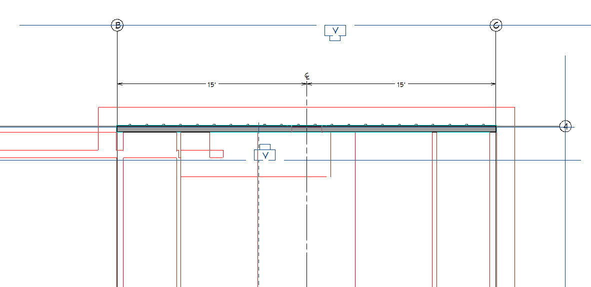

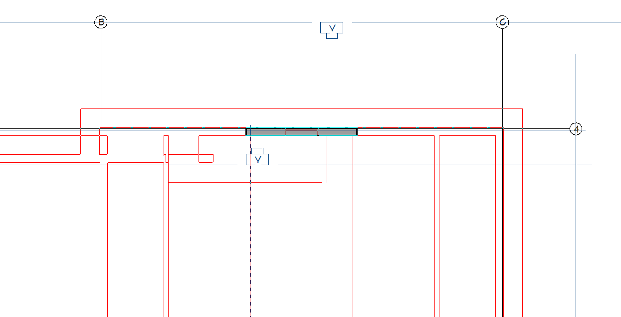

mtldesigns Posted August 16, 2025 Share Posted August 16, 2025 Scratching my head on this one.. done this a hundred times, but for some reason the shed roof where it overlaps the 10/12 roof looks right, but as the title states, the fascia nor the drip edge come in. I have stretched the planes back and then into position, I have even deleted the plane and put in a new one. Typically if there was an issue my frieze or soffit wouldn't show, but its there as well. I know this must be a setting issue.. I'm just not seeing it. Any ideas? Thanks in advance Recording 2025-08-15 220313.mp4 Link to comment Share on other sites More sharing options...
mtldesigns Posted August 16, 2025 Author Share Posted August 16, 2025 I think I figured out the "why"... the overhang is 18", and it lines up perfectly over the interior lower garage door wall, if I moved this overhang 1" in either direction, the fascia appears. Besides going with a 17" or 19" overhang, I'm not sure how to fix it. 1 Link to comment Share on other sites More sharing options...
Mark3D Posted August 16, 2025 Share Posted August 16, 2025 I would submit a bug report on that 1 Link to comment Share on other sites More sharing options...

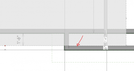

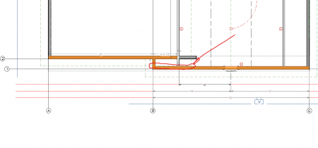

Kbird1 Posted August 16, 2025 Share Posted August 16, 2025 19 hours ago, mtldesigns said: I think I figured out the "why"... the overhang is 18", and it lines up perfectly over the interior lower garage door wall, if I moved this overhang 1" in either direction, the fascia appears. Besides going with a 17" or 19" overhang, I'm not sure how to fix it. is there perhaps a break in the Attic wall at that point both sides? if and auto attic wall perhaps try drawing your own too. M. Link to comment Share on other sites More sharing options...
mtldesigns Posted August 17, 2025 Author Share Posted August 17, 2025 1 hour ago, Kbird1 said: is there perhaps a break in the Attic wall at that point both sides? if and auto attic wall perhaps try drawing your own too I thought that too, at first. But no breaks (highlighted walls in orange). And most plans I turn off auto attic walls anyways, and model my own. To get this approval set out, I just brought the plane edge in 1".. Def. will need to fix at CONDOC time. I've never sent in a bug report in all these years, if Chief actually finds the issue and fixes it, do they fix that model and send it back, or inform me of the fix..? I am just thinking if I move forward on the CONDOCs, how they communicate a fix if what they have is outdated? I hope that makes sense. Link to comment Share on other sites More sharing options...
Kbird1 Posted August 17, 2025 Share Posted August 17, 2025 38 minutes ago, mtldesigns said: I thought that too, at first. But no breaks (highlighted walls in orange). And most plans I turn off auto attic walls anyways, and model my own. To get this approval set out, I just brought the plane edge in 1".. Def. will need to fix at CONDOC time. I've never sent in a bug report in all these years, if Chief actually finds the issue and fixes it, do they fix that model and send it back, or inform me of the fix..? I am just thinking if I move forward on the CONDOCs, how they communicate a fix if what they have is outdated? I hope that makes sense. I thought perhaps the Garage Wall was somehow causing a break in the Attic Wall , there is a setting "allow lower Roof planes" (paraphased) but it doesn't always seem to work for some reason. Tech Support can be pretty quick, they'll send your plan back and usually tell you the fix etc which you should be just able to incorporate into the Plan you are working on, and the Layout should update when refreshed (update all views button). M. Link to comment Share on other sites More sharing options...
mtldesigns Posted August 17, 2025 Author Share Posted August 17, 2025 Tech support ticket issued. I will wait to see their response and repost. 2 Link to comment Share on other sites More sharing options...
mtldesigns Posted August 19, 2025 Author Share Posted August 19, 2025 @Kbird1@Mark3D After reviewing your case, it appears that your issue is being caused by an attic wall that’s extending too far. The easiest way to fix this that we’ve found is to:1. In your plan view, go to floor A2. Delete the gable end wall (shown in the attached screenshot)3. Go to Edit->Default Settings->Walls->General Wall4. Check the box for Auto Rebuild Attic Walls5. The program will generate a new attic wall of the correct size where the old one was removed – this new wall should allow the fascia to properly generate.After performing these steps, you can optionally go back in and turn off Auto Rebuild Attic Walls if needed.Please let me know if this helps! On 8/16/2025 at 7:40 PM, Kbird1 said: Attic wall at that point both sides You were mostly right Mick. The floor I was concentrating on was the second floor, not the attic. As I mentioned above, I usually turn off the attic walls and draw my own. This design, I added the "true" 2nd floor attic" after the fact when client wanted more storage. This moved the full length gable wall up to the "A" floor. Making it too long as Support found out. Thanks to you all. Link to comment Share on other sites More sharing options...
