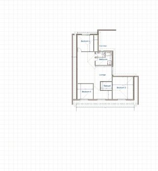

NeilofOZ Posted May 5 Share Posted May 5 Having issues with placing Dormer's, have placed two on the upper level ( just as practice ) but need to place some on the lower level which is over the entry & Garage. System keeps telling me it can't work, but I don't understand why. Have looked at several CA tutorials and none of them make sense, ie it extracts some walls from the "Auto Floating Dormer " and "Auto Dormer' but when I do this it sends me a standard wall associated with normal walls, nothing to do with Dormers. Have attached a pdf pic, file is too large to send a cad plan. Link to comment Share on other sites More sharing options...

NeilofOZ Posted May 8 Author Share Posted May 8 Having no luck with your suggestions. Managed to view another Chief video on "Creating a False Gable" and thought this would be my saviour as it looked so simple and exactly what i was looking for, but alas no luck with this. After examining the second floor roof outline it appears that the hips over Bed 3 & 4 are in the wrong place and could be the reason why I keep getting problems when placing the locations of the False Gables to both lower and upper floors, as when i place a Gable general walls and roofs are displaced, creating a head ache. Is there a simple way of sending my Chief Plan, as this would help me with your diagnosis. Link to comment Share on other sites More sharing options...

Doug_N Posted May 11 Share Posted May 11 This is best handled with the roof in auto rebuild. There is a porch with invisible walls to generate the front overhang. The pitch of the overhang roof is reduced by adjusting the pitch using the roof dialog in the wall DBX. The peak over the door is created using the gable line tool (only works if the roof is in automatic). I nearly forgot to mention that the preferences was set to ignore upper floor. Turn that off.) The floating dormer is adjusted by setting the wall height to allow the dormer roof not to exceed that ridge height of the main roof. I included the file that I worked on for your review. Hope that helps. (All done in X-17) Michael's House.2.zip Link to comment Share on other sites More sharing options...
