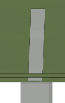

SHCanada2 Posted April 11, 2025 Share Posted April 11, 2025 Terrain retaining wall bottoms seem to follow the curve of the terrain on the low side of the wall. Is there a method to show a horizontal bottom. I am trying to show it in elevation view and it currently looks like kind of ugly. I tried a normal wall but it has a flat top Two of them are shown below. bottom one shows the issue: Link to comment Share on other sites More sharing options...

Mark3D Posted April 12, 2025 Share Posted April 12, 2025 If you are still using retaining walls make sure the default top and bottom are selected as if you have adjusted the wall top or bottom chief will no longer auto adjust there top or bottom positions to match the terrain Link to comment Share on other sites More sharing options...
SHCanada2 Posted April 12, 2025 Author Share Posted April 12, 2025 5 hours ago, Mark3D said: If you are still using retaining walls make sure the default top and bottom are selected as if you have adjusted the wall top or bottom chief will no longer auto adjust there top or bottom positions to match the terrain It looks when I made the, change to the bottom, only the bottom check box deselects. The top remains checked. If I move the terrain down say 20", the top still moves with the terrain but the bottom does not. see below But is there a better option? A solid would needs its top changed to match the terrain, and in thinking about it maybe that is better as one could step the solid like a real wall, and if the terrrain moved up and down as a whole, the solid would move with it, maintaining the bottom of the wall. ...per usual... a couple options...each with their benefits and drawbacks Link to comment Share on other sites More sharing options...
robdyck Posted April 12, 2025 Share Posted April 12, 2025 4 hours ago, SHCanada2 said: A solid would needs its top changed to match the terrain, A solid would need the top adjusted to be relatively close to the terrain, depending on retaining wall type. What I was referring to was a 3d solid that represents a concrete retaining wall, formed with either: a straight, consistently sloped top slightly higher than the high side of the terrain a straight stepped top, formed in even increments suitable for concrete form work What I was not referring to is a concrete wall with an undulating top and bottom as determined by Chief's terrain modelling characteristics. I prefer something useful for my modeling and my builders. I also don't care about Chief adding a footing to my retaining wall unless it is required for the particualr wall construction...which varies by builder preference, jurisdiction structural requirements, overall retaining wall height, retaining wall location relative to property line, structural engineering (if needed), etc. And for retaining wall con docs, I'm just going to be using one of my cad details, already completed or ready to duplicate for a unique application. Link to comment Share on other sites More sharing options...
Mark3D Posted April 12, 2025 Share Posted April 12, 2025 Is that what you want Link to comment Share on other sites More sharing options...
SHCanada2 Posted April 12, 2025 Author Share Posted April 12, 2025 2 hours ago, robdyck said: a straight, consistently sloped top slightly higher than the high side of the terrain a straight stepped top, formed in even increments suitable for concrete form work yes, that is more real life, I understood it to be a 3D solid, which is why I commented probably the better option. 52 minutes ago, Mark3D said: Is that what you want I dont need a footing, but that is interesting. Did you just pull down the footing (if so I suppose the footing could be set to the same width). Ultimately what I was trying to do was while I was adjusting the terrain, the wall would come along with it, but keep the bottom (below the terrain flat). Ironically in the end for this project, the terrain region was almost flat, so a 3D solid with a terrain break would have worked just fine. But it did get me thinking for the next one how could I do it dynamically. For this one I just put in a CAD box masking the ugly below the terrain terrain retaining wall, and for the moment, have yet to step the bottom. But I had to send it off Thursday so it went like that.. (...the workaround 3rd option..which is not my preference going forward) Link to comment Share on other sites More sharing options...
Mark3D Posted April 12, 2025 Share Posted April 12, 2025 Forget dynamically just build terrain then turn of auto build terrain edit the retaining wall jobs is done, editing the retaining wall is a bit strange but it works, it seems like it is crossing over it’s self but ignore it as it does not seem to matter Link to comment Share on other sites More sharing options...
Mark3D Posted April 12, 2025 Share Posted April 12, 2025 Also the footing just turn it off under wall dialog foundation tab. Link to comment Share on other sites More sharing options...
