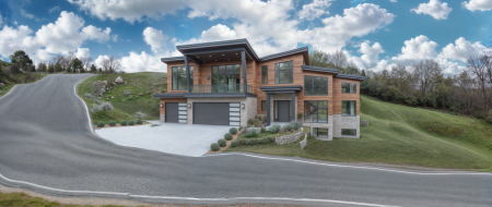

Renerabbitt Posted April 16, 2025 Share Posted April 16, 2025 Another testament to this method that Steve goes through diligently in these 6 pages of posts: 1 Link to comment Share on other sites More sharing options...

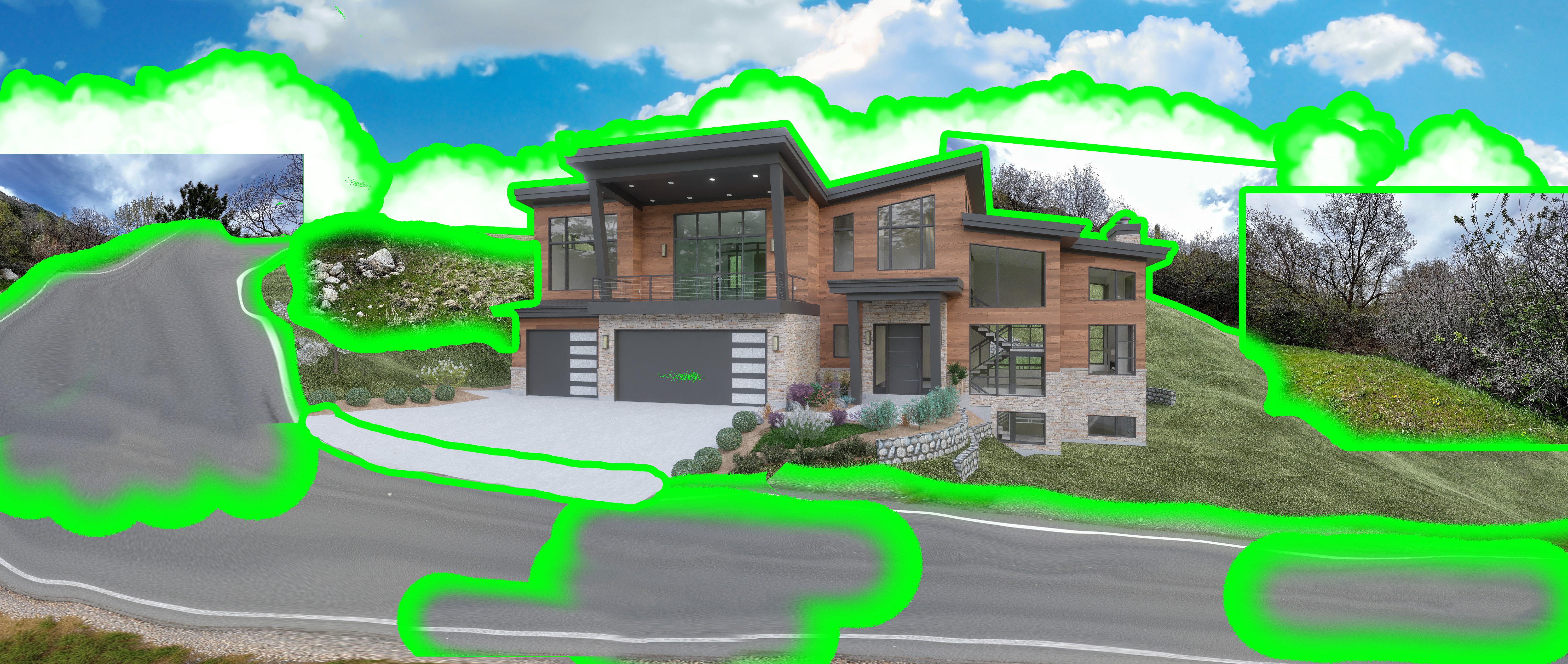

Steve_Nyhof Posted April 16, 2025 Author Share Posted April 16, 2025 13 minutes ago, Renerabbitt said: Another testament to this method that Steve goes through diligently in these 6 pages of posts: Wow! Now that is some amazing grade work. Is the grading actually done in Chief? Or is this an image of the property before there was a house? Very impressive! I cannot think of how you did this Link to comment Share on other sites More sharing options...
Steve_Nyhof Posted April 16, 2025 Author Share Posted April 16, 2025 I looked closer at your green outlines and it looks like you took pictures of various areas and put them together - maybe with photoshop? Very cleaver! Link to comment Share on other sites More sharing options...

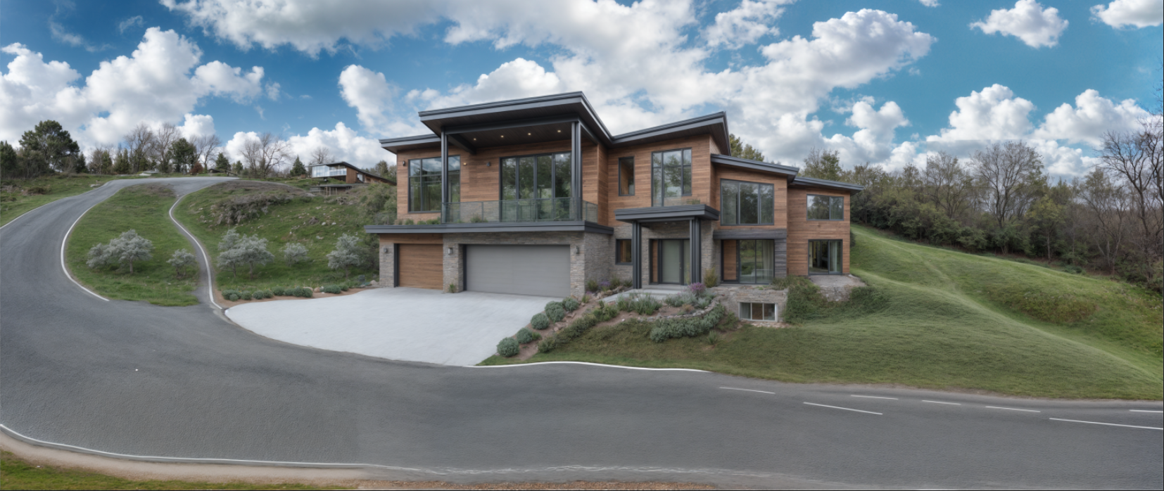

Renerabbitt Posted April 16, 2025 Share Posted April 16, 2025 1 hour ago, Steve_Nyhof said: I looked closer at your green outlines and it looks like you took pictures of various areas and put them together - maybe with photoshop? Very cleaver! Hey thank you, this is pretty much the same method as what you post in the first post. This is called photo manipulation/bashing, if you wanna watch one of the best in the world, hes just a young kid: BTW this is the shot from Chief: Link to comment Share on other sites More sharing options...
Steve_Nyhof Posted April 17, 2025 Author Share Posted April 17, 2025 13 hours ago, Renerabbitt said: BTW this is the shot from Chief: Very nice. Photoshop is pretty straight forward. I do like the idea of the extended terrain. That is a nice touch to blend in with a distant background. Great work! Link to comment Share on other sites More sharing options...

Renerabbitt Posted April 17, 2025 Share Posted April 17, 2025 3 hours ago, ACADuser said: That photo editing was amazing. Would AI be able to add landscape & sky to your Hill House? So the sections highlighted in green, think of that as Clipart. I used them in order to get Ai to generate the landscape I wanted. And to Steve's point yes Ai messes with the house but you mask the house out of the Ai image. Then you can layer in more and send it back through Ai. You cna also send the house through Ai and take what's good and mask the rest back to the source image. I have a post here somewhere about material ID masks.. That's what I'm doing with this project. Makes it easy to select an element and mask out if Ai messed with it. 1 Link to comment Share on other sites More sharing options...
Steve_Nyhof Posted April 17, 2025 Author Share Posted April 17, 2025 34 minutes ago, Renerabbitt said: So the sections highlighted in green, think of that as Clipart. I used them in order to get Ai to generate the landscape I wanted. And to Steve's point yes Ai messes with the house but you mask the house out of the Ai image. Then you can layer in more and send it back through Ai. You cna also send the house through Ai and take what's good and mask the rest back to the source image. I have a post here somewhere about material ID masks.. That's what I'm doing with this project. Makes it easy to select an element and mask out if Ai messed with it. Hi Rene, What AI did you use? I know more and more AI image apps have masking so that would be the thing to use. Link to comment Share on other sites More sharing options...
chiefuserids Posted April 17, 2025 Share Posted April 17, 2025 This thread was very helpful Thanks 1 Link to comment Share on other sites More sharing options...
Renerabbitt Posted April 17, 2025 Share Posted April 17, 2025 50 minutes ago, Steve_Nyhof said: What AI did you use? I use Krea, but I am doing the masking in photoshop This is what I sent to Krea for round 1. I used a cloud brush to cover up some problem areas. This is why I love the new ai workflow, I didnt have to do what I used to have to do which is tedious masking and bashing. I used the puppet warp tool on a straight road along with liquify to get the road markers setup. I knew that part didnt have to be perfect: This is what I got back from Krea with low "resemblance" and high "strength"...I masked out and kept the background from this image: Then with high "resemblance" I got this..which i Used this image as the basis for the road the front yard and the house: which resulted in this image where those two previous images are bashed: From there it was just fixing problems before sending it to Krea one more time and then adding a camera raw filter in photoshop where I touched pretty much every setting: 1 Link to comment Share on other sites More sharing options...
