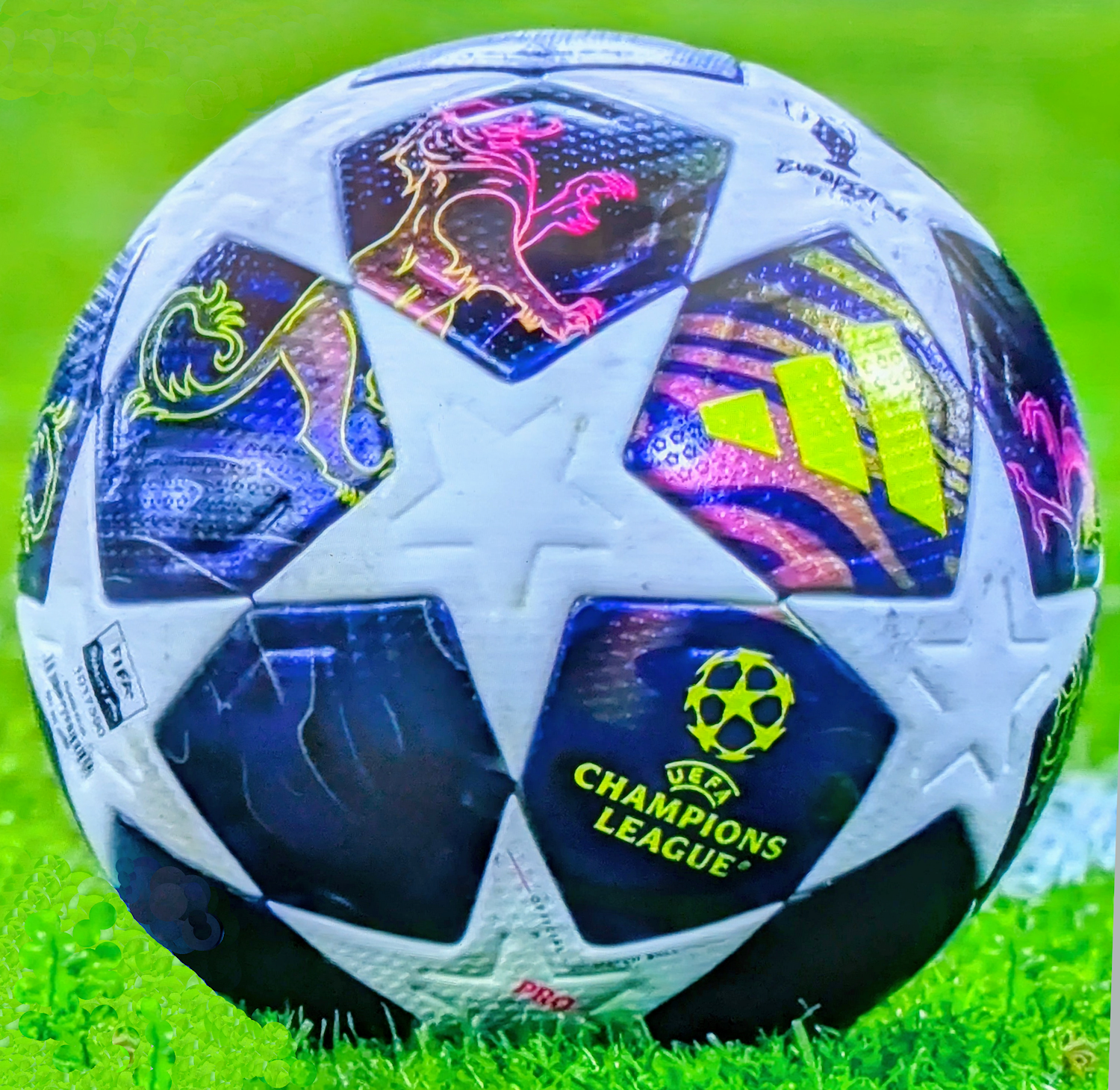

Rich_Winsor Posted February 19 Share Posted February 19 Can these tools generate a seamless material that can be applied to a 3D Sphere? I have been having a play with creating a globe from a 3D sphere with a world map applied as a material. Actually turned out better than I had expected. Then today I was watching some world cup soccer and they showed this close up of the ball they were using. Is there a way to generate a 2d texture of stars that can be seamlessly applied to a sphere? Link to comment Share on other sites More sharing options...

CADustin Posted March 2 Share Posted March 2 Your globe looks terrific, good job! So just to be brief, yes the builders can make materials that wrap around a globe but not because they are made to do so. instead the important part of the process is the UV mapping of the globe itself. UV mapping is just a setting under the hood of all 3d assets that dictate how materials lay on a 3d surface, kinda like wrapping paper on a present. The UV mapping will take the image and slice it up and lay it as the 3d artist dictates to try and make the asset look good/correct without a bunch of seams or distortions. This can get complex, kinda of like wrapping a box vs wrapping a soccer ball. Couches, trees, countertops, all of them have UV mapping. There's a few different ways to map a sphere, but here's an example of what the UV mapping of the globe could be doing to an image to get it to lay correctly on its rounded surface, again kind of like wrapping a ball... It's be very difficult for artists to make an image like this with the proper angles, so we keep the images square and us UV mapping to slice it up under the hood. Therefore the Builders in Chief CAN make you images that would fit on a globe but they aren't special in that regard, any image would lay on a well mapped globe decently as long as its the right size. If you're interested in the nitty gritty, e mail me at Dustin@chiefarchitect.com or investigate UV mapping online. Link to comment Share on other sites More sharing options...
