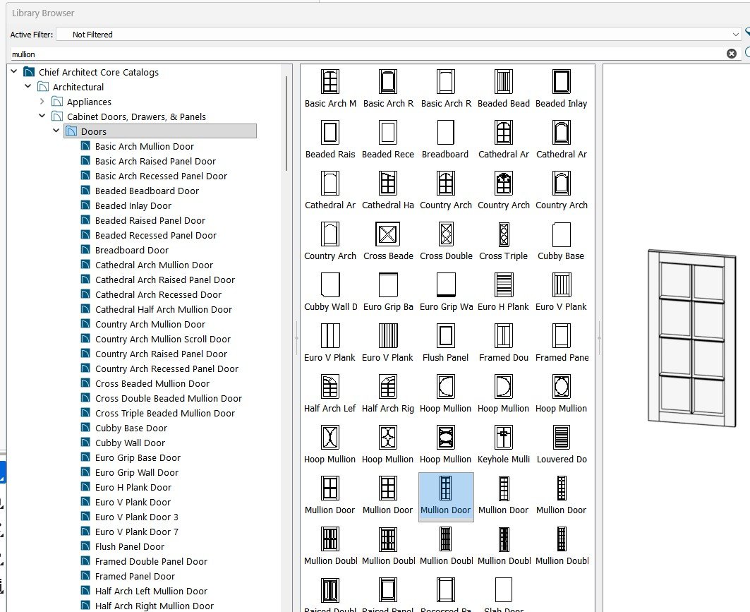

Connecticut Posted November 18, 2025 Share Posted November 18, 2025 Chief Architect Core Catalogs - Cabinets Doors Drawers & Panels - Doors - Mullion door (2 over 4) I know this thread is old, but I was looking it up myself because I forgot where some of these great things were located. Link to comment Share on other sites More sharing options...
