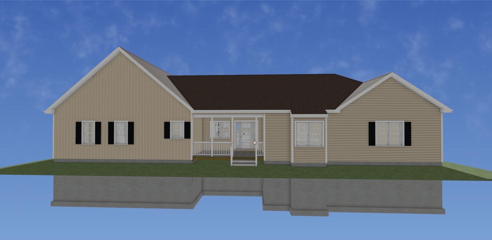

  11. You won't be able to change one pitch to something different if you have auto-build roof on. You're not very clear on what you are trying to match up. If you want the rear wall to be where the roofs start, then change the fascia to the same heights, lock it, then change the pitch of the middle roof, if that's the one you want to change.
  12. Change the pitch right in the roof defaults. Spend some time reading the reference manual
  13. With the picture you showed, it looks like the 2 sides are the same height, while the middle is taller. So set the 2 side rooms to whatever rough ceiling is needed, and the middle room taller. You can keep the pitch the same for all of the roofs.
  14. Looks like 3 shed roofs. Nothing to over think about it. Adjust the room heights for each room, set your pitch, and off you go.
