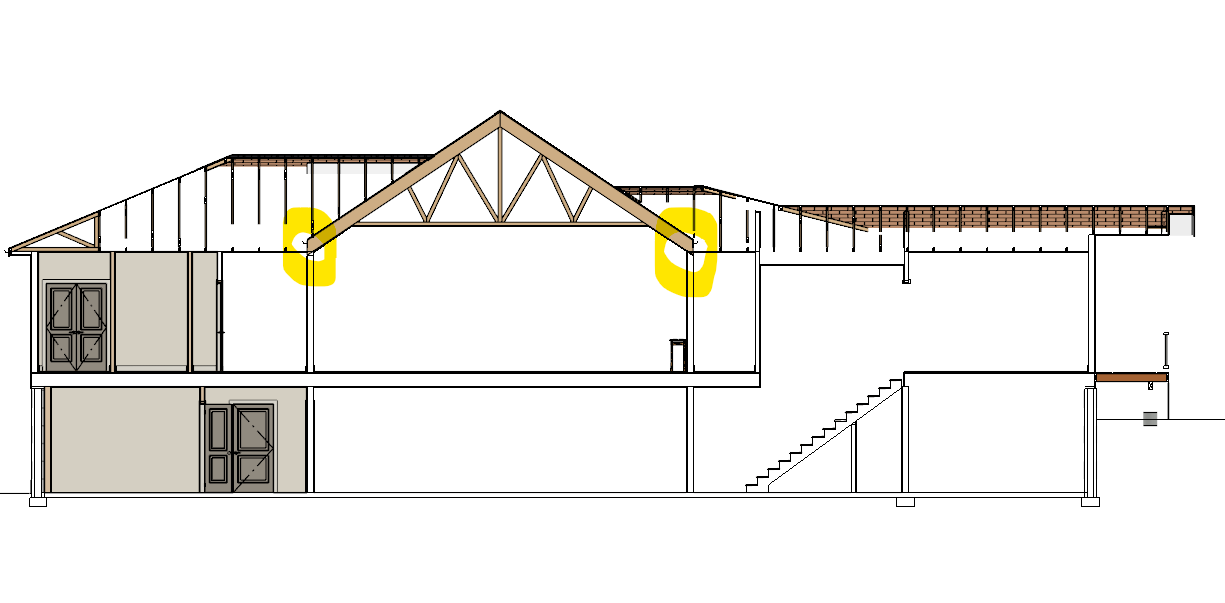

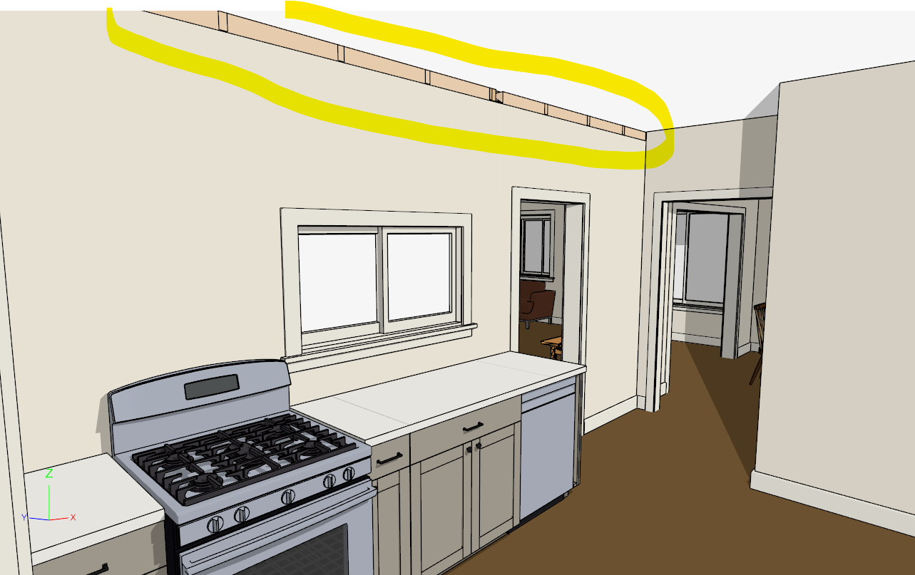

GeneDavis Posted October 22 Share Posted October 22 I've drawn this plan with a central bay roofed with trusses that bear on their 2x12 top chords. The program does not cut a seat cut on the truss ends. Something makes the walls on the outboard side of the truss bearing walls lose their drywall finish near the ceiling, and I think it relates to the uncut truss ends. Plan attached (X18). Here is what you see when in a room on the outboard side of a bearing wall. Here is a building section in which I highlight the truss bearings. https://drive.google.com/file/d/1lX_BYEhU96gJ2DW4hxAUBqi2nwAWK-rz/view?usp=sharing 1 Link to comment Share on other sites More sharing options...
ChristianA Posted October 22 Share Posted October 22 (edited) I've had this problem from day 1 with roofs. I can not get finishes to extend upward on any wall with a roof plane on it, even though the the truss tail is removed and truss terminates at exterior face of stud. The only way I've gotten it to work is to move the plane to inside face of stud. I have this condition all the time where there is a gable overlay on top of the main roof. I'd love to be wrong on this one. Edited October 22 by ChristianA Link to comment Share on other sites More sharing options...

GeneDavis Posted October 23 Author Share Posted October 23 Open the plan. Open plan view Roof Framing. Select all the center bay trusses. Open for spec and lock envelopes. Select the center bay roof and zoom in to the edges where the center bay trusses with their 2x12 top chords bear. The edges, both sides where the drywall cut is happening, align to the wall's outermost layer, the drywall layer. Move the roof edge to the main framing layer edge, then in 1/8" more. That's what fixed it for me. 1 Link to comment Share on other sites More sharing options...
