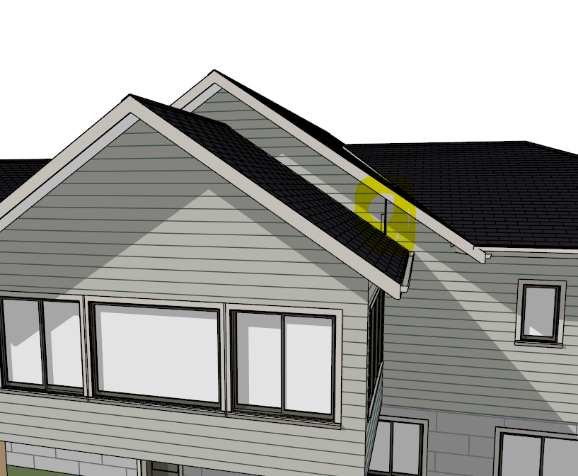

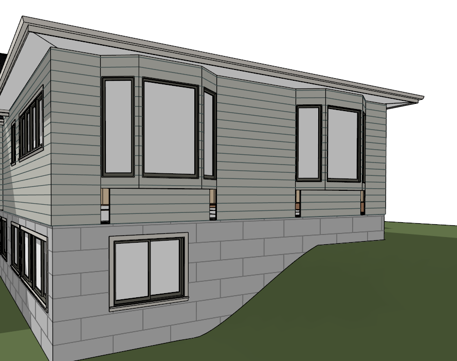

GeneDavis Posted 21 hours ago Share Posted 21 hours ago Plan file attached in X18. At plan top, a pair of bedrooms each have a bay window. I did exactly what @Renerabbittdoes in a video to raise the floor of the bays, but the siding below has voids at the joins. What is wrong with my build? At plan right, a bumpout room with no basement under it has its walls somehow fiddling with the siding above. This image shows one side, and the same condition is on the other. What is the fix here? fixsiding.zip Link to comment Share on other sites More sharing options...
Mark3D Posted 19 hours ago Share Posted 19 hours ago With the gable gaps your roof planes are not against the cladding Link to comment Share on other sites More sharing options...

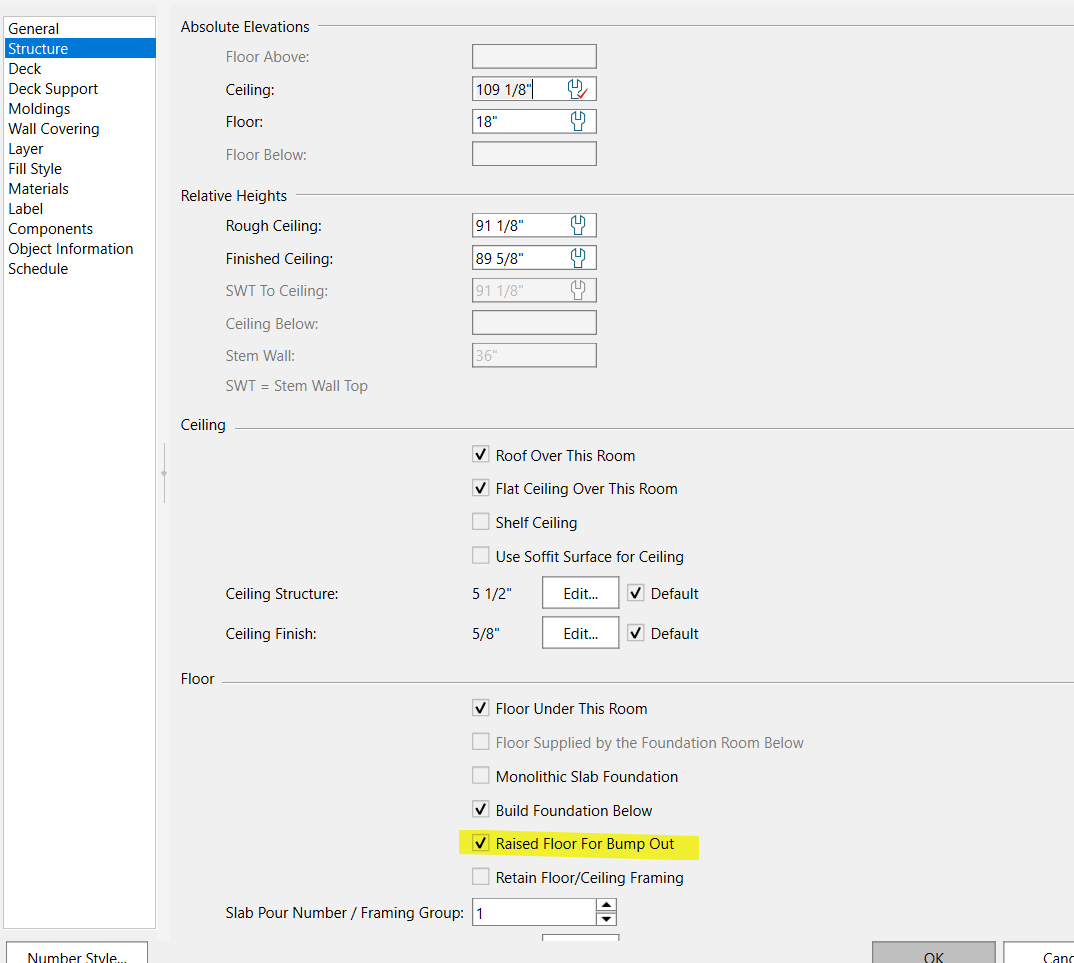

Solution Mark3D Posted 17 hours ago Solution Share Posted 17 hours ago Bay windows select room and turn on raised floor for bump out Link to comment Share on other sites More sharing options...
