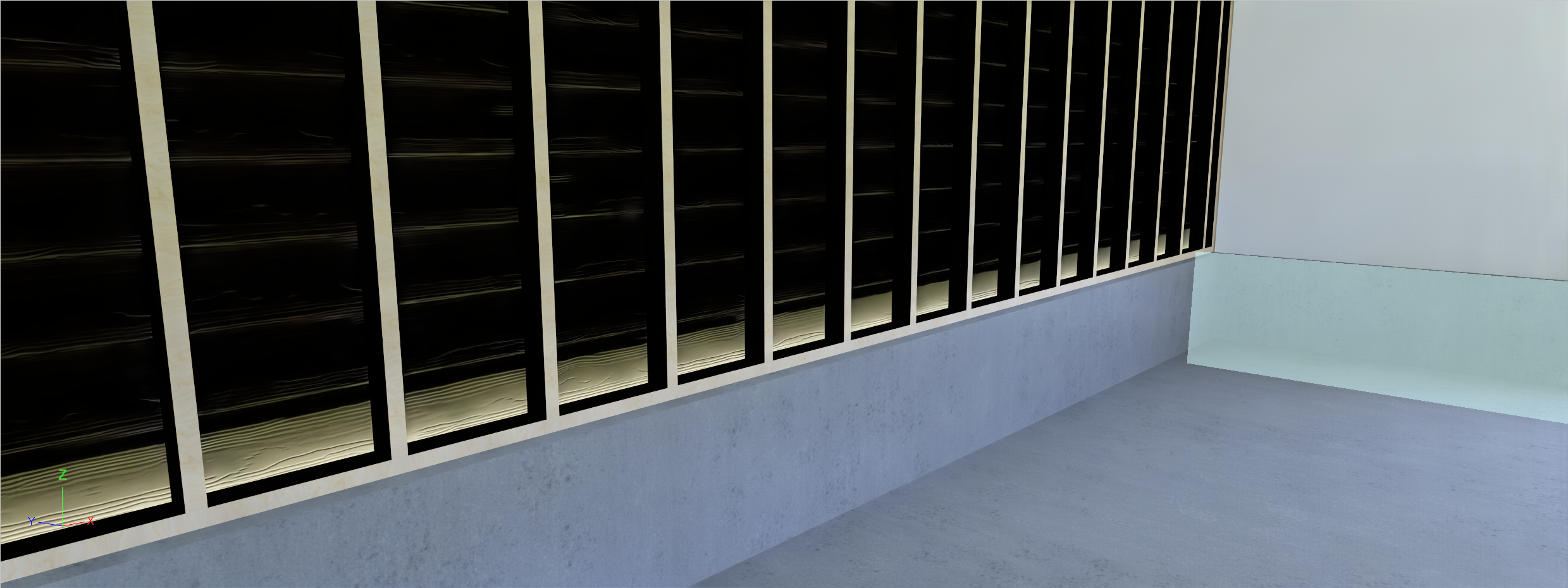

jtcapa1 Posted September 8 Share Posted September 8 I may be missing something obvious, but in playing around with deleting surfaces I noticed that it seems to change how the materials are shown. For example when I deleted the drywall and the plywood, it leaves the studs (which is what I wanted) and the siding beyond, but it looks like there's been a fire? the edges of the framing are shown in black?! and the siding looks like it is in the shade, which it might be. Why? Link to comment Share on other sites More sharing options...
Renerabbitt Posted September 8 Share Posted September 8 9 minutes ago, jtcapa1 said: black?! and the siding looks like it is in the shade, which it might be. Why? youre using raytrace..the delete surface tool doesnt actually remove surfaces, so the pathtracer is still seeing a surface, and those studs are technically still enclosed by your exterior surface. They are black then because you have no light inside of your stud bays 1 Link to comment Share on other sites More sharing options...

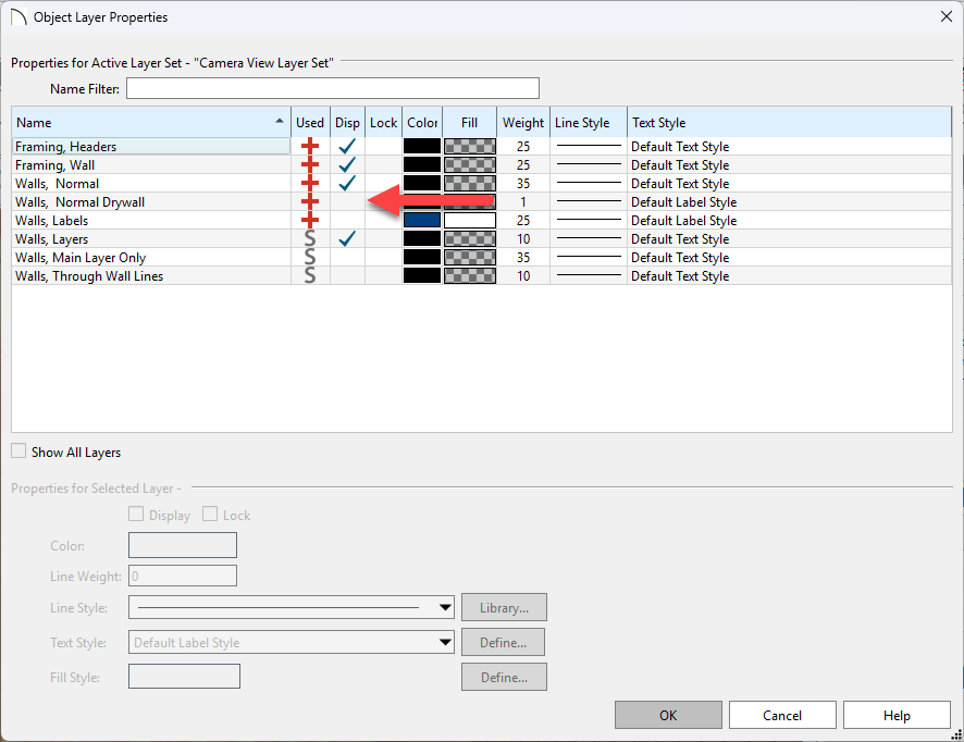

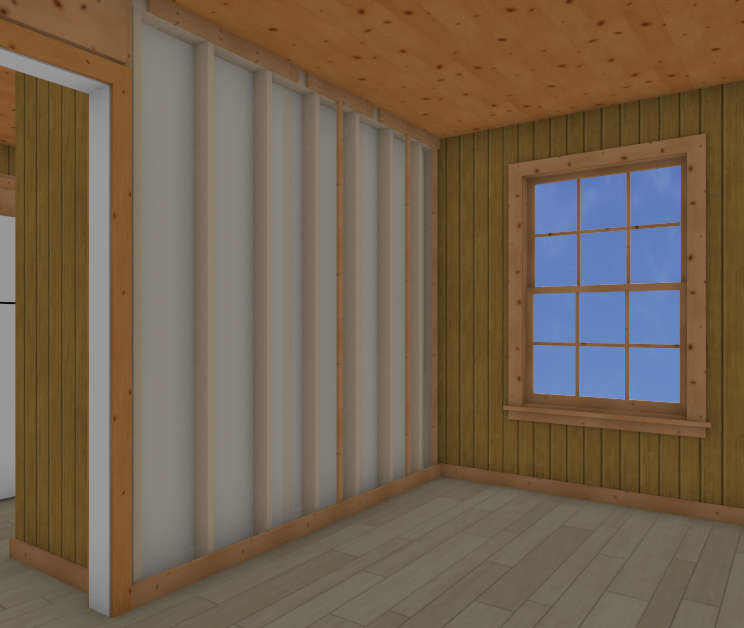

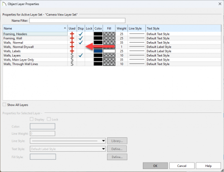

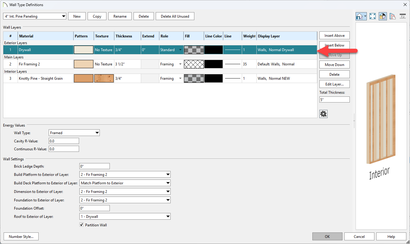

Doug_N Posted September 9 Share Posted September 9 A better approach would be to change the layer for the drywall in the specification box for the wall type. In the wall DBX the drywall layer is set to a newly created layer Turn off the drywall layer, now the framing is exposed And the light reaches the interior cavities of the framing. 1 Link to comment Share on other sites More sharing options...
jtcapa1 Posted Friday at 11:41 PM Author Share Posted Friday at 11:41 PM Thanks guys, The no light was a good new addition. I've notice this as I'm using the DLSS feature. We can zoom around the 3d model and when the camera cuts into objects, they appear blackish. Makes sense now. Link to comment Share on other sites More sharing options...
