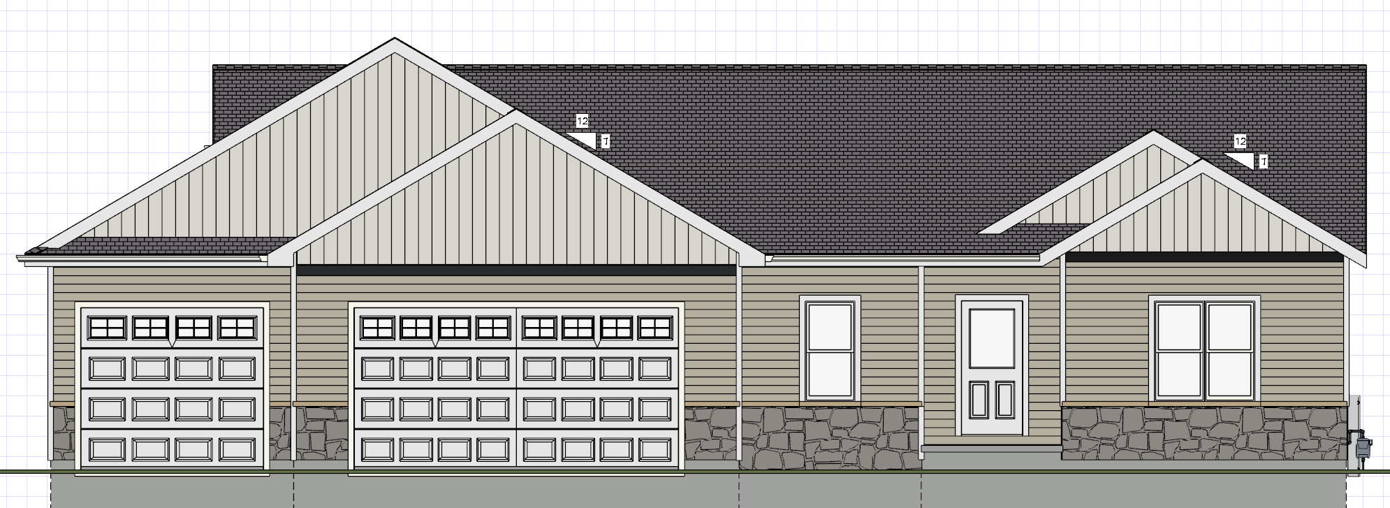

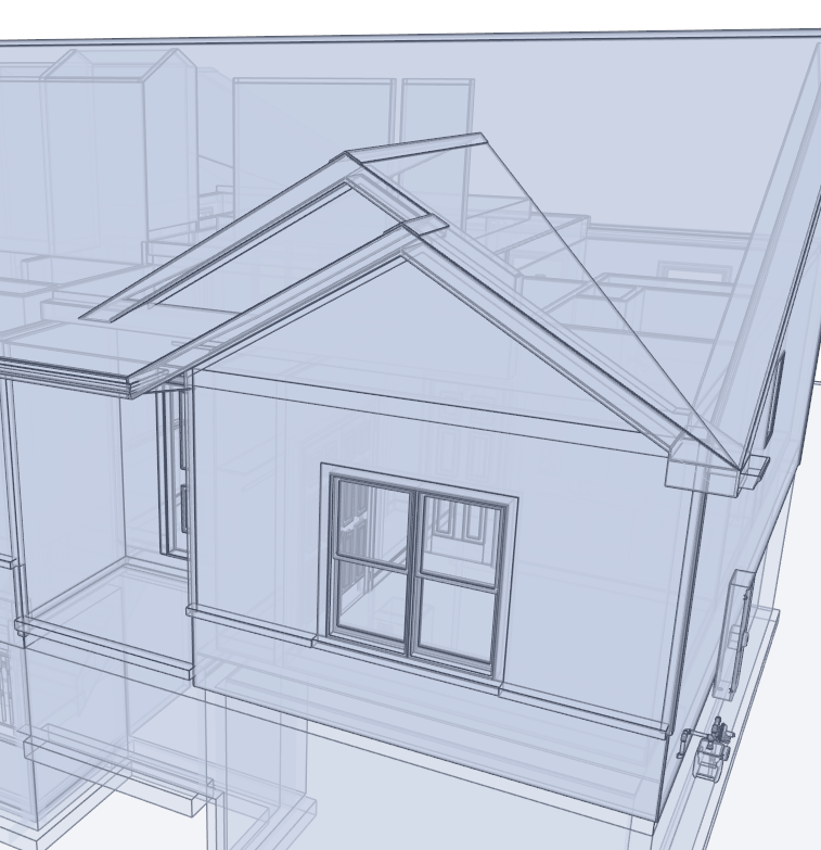

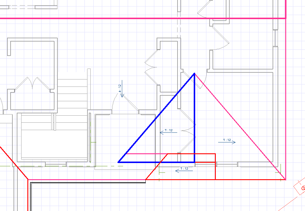

AngKuch2525 Posted Wednesday at 07:54 PM Share Posted Wednesday at 07:54 PM I have Boxed Eaves selected in the roof options, however they are not showing up on the right side gable. See attached screenshots. What do I need to fix to get them to show up? Link to comment Share on other sites More sharing options...

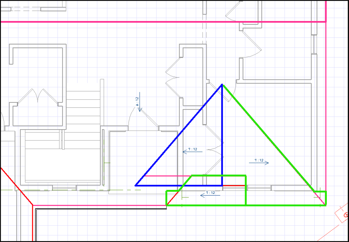

JonathanK Posted Wednesday at 08:07 PM Share Posted Wednesday at 08:07 PM It's because your roof planes come to a point. I know that makes sense, as that's how it would be, but I've always found that I have to make there be a little bit of eave for the boxed eaves to work properly. One of the many mysteries of Chief... I attached an image, and outlined in green how it should look. 1 1 Link to comment Share on other sites More sharing options...

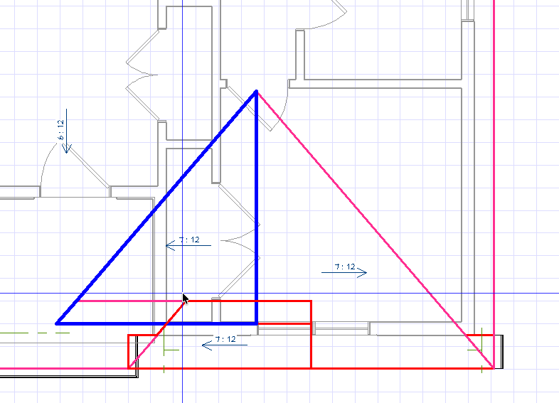

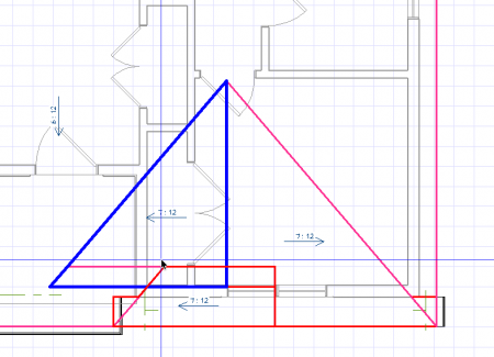

AngKuch2525 Posted Thursday at 01:19 PM Author Share Posted Thursday at 01:19 PM So I notched out the corners like you suggested Jonathan, and it worked on the right side, but not the left side. The other issue is that it's automatically putting a gutter on the notch out that I do not want. Any more suggestions? Link to comment Share on other sites More sharing options...
Solution GeneDavis Posted Thursday at 02:57 PM Solution Share Posted Thursday at 02:57 PM You can control gutter ON and OFF by selecting a roof plane by its eave edge and going to the gutter tab in the spec dialog. For the other side, you'll have to give your entire gable a tiny nudge out to have Chief build a return. Play with it and see. Link to comment Share on other sites More sharing options...
