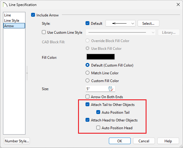

mtldesigns Posted August 17 Share Posted August 17 I know I've suggested in the past, to fix the arrow situation, esp. when the arrow thinks it has to connect to the object your pointing too. It is such a PITB having to constantly adjust arrows because something moved. Until we get this fixed.. is there a way to make it not connect to an object? Link to comment Share on other sites More sharing options...
Solution DBCooper Posted August 17 Solution Share Posted August 17 You can turn it off here: 2 Link to comment Share on other sites More sharing options...
mtldesigns Posted August 17 Author Share Posted August 17 19 hours ago, DBCooper said: You can turn it off here That's what I needed... should have asked years ago. Thanks! Link to comment Share on other sites More sharing options...
