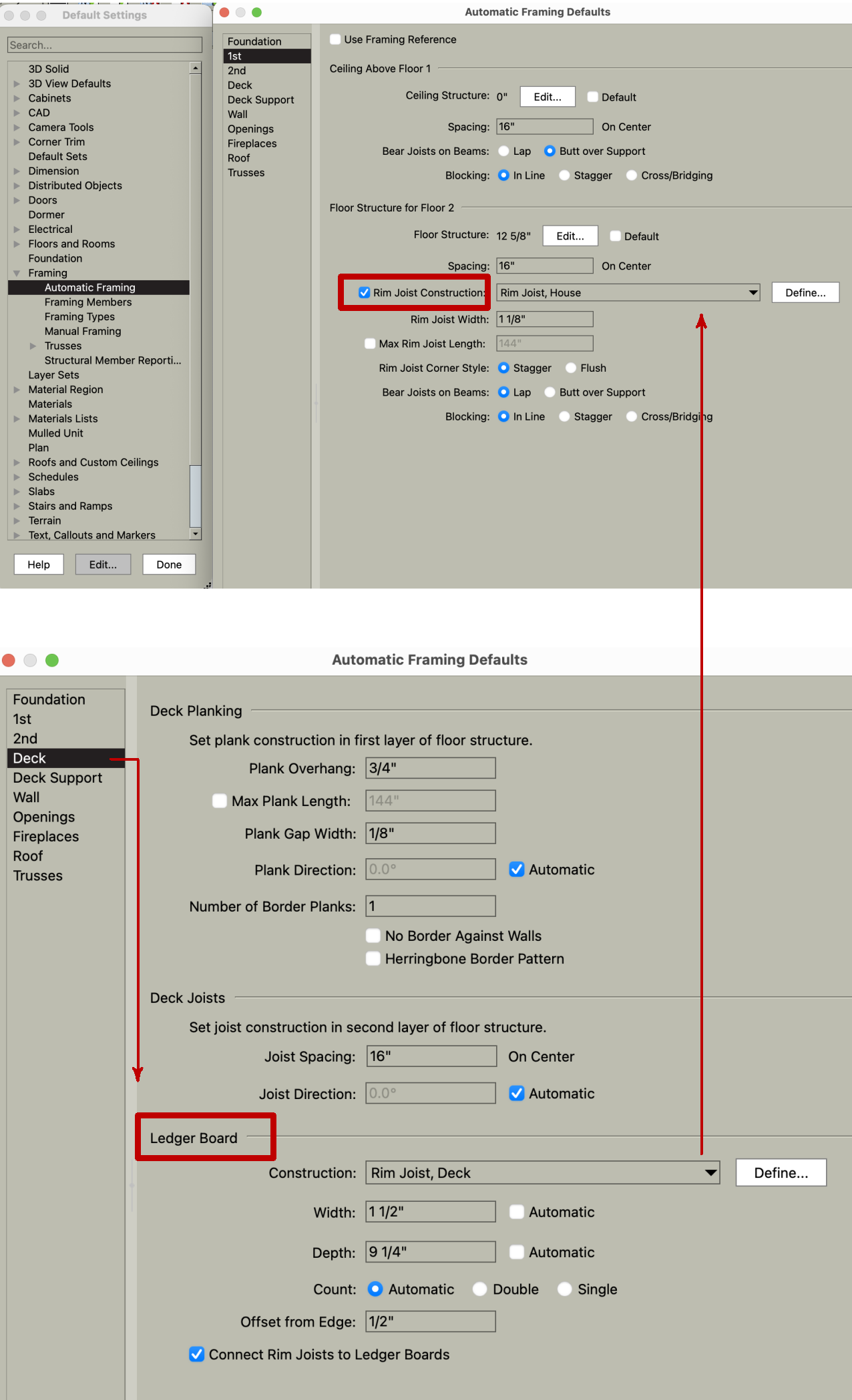

ValleyGuy Posted Thursday at 09:39 PM Share Posted Thursday at 09:39 PM When framing a deck I can't seem to get ledger or rim boards to frame at all, nor can I get the beams to build perpendicular to the joists. Is this a bug? Link to comment Share on other sites More sharing options...

ValleyGuy Posted Thursday at 10:13 PM Author Share Posted Thursday at 10:13 PM I can't get the house rim boards to frame either...... Link to comment Share on other sites More sharing options...

ValleyGuy Posted 4 hours ago Author Share Posted 4 hours ago Framing the both the house and the deck rim boards works fine.... if the box is checked in the Auto Framing Defaults. This also prompts the deck ledger board to frame. However, all of the rim board thickness is still controlled by the Floor Structure default. So if you have two different thicknesses between the house floor rim board and the deck rim boards, be sure to frame one then change the thickness before framing the other. It would be nice if there was a separate deck rim board default section too. Other than the glitch with the Joist Direction Line, and the beam direction issue (both of which Chief is looking into), the deck seems to frame up better than before IMHO. Link to comment Share on other sites More sharing options...
