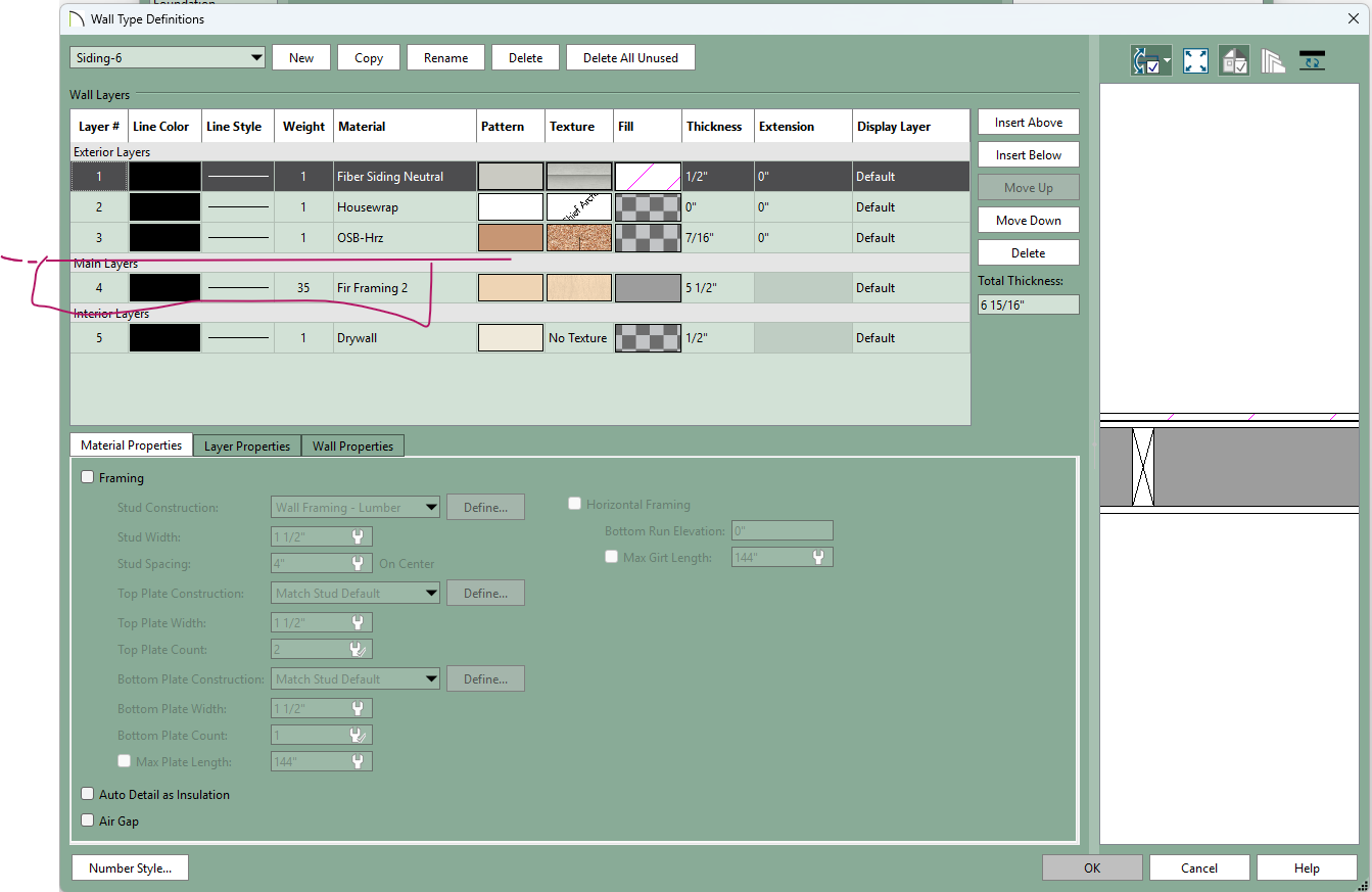

MPDesign Posted August 3 Share Posted August 3 Look at your wall type specification, make sure you have framing in the main layer Link to comment Share on other sites More sharing options...
DBCooper Posted August 3 Share Posted August 3 (edited) Are you automatically building the wall framing or are you manually building it? It's pretty easy to just select a wall and say "build framing for selected object" to build it. If it doesn't actually build any framing, then it is something wrong with your wall. 99% chance that you did something to the wall type when this is the case. Most likely you don't have the main wall layer set to be framing*. If it's not that, then you should probably post your plan. *In Michael's picture above, note how the "framing" checkbox that is below the table is not checked. You need to make sure that it is checked for the wall's "main layer". Edited August 3 by DBCooper Link to comment Share on other sites More sharing options...
MPDesign Posted August 3 Share Posted August 3 I see that I didn't have the framing layer selected in the screen grab. Hence framing not checked. As DB Cooper said make sure it is checked when the line is selected. Link to comment Share on other sites More sharing options...
