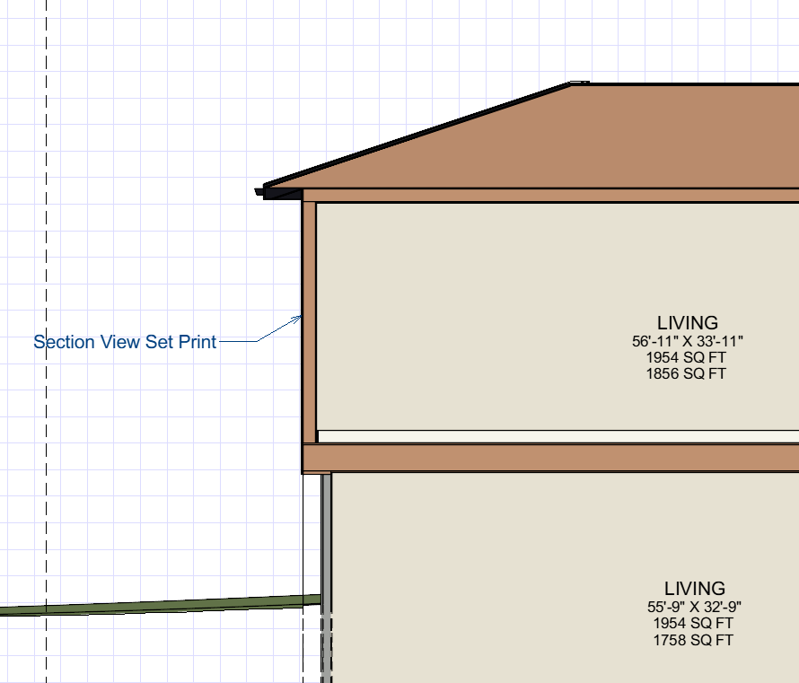

SHCanada2 Posted July 25 Share Posted July 25 hmmm, it looks to show the active layer set: Screen Recording 2026-07-25 164259.mp4 section: section: Link to comment Share on other sites More sharing options...
Renerabbitt Posted July 28 Share Posted July 28 (edited) On 7/25/2026 at 3:41 PM, SHCanada2 said: active layer set: It's just tricking you I to thinking that .. it's been a problem forever, that's just showing you that layer set because you're in that view. When you switch back to another view and look at a value being reported from a macro it will not be that section layer set. Section and elevation layer set conditional checks don't work.. I switched to showing window callouts in section for that reason since I couldn't get my window labels to conditionally change to just schedule number in elevations for this exact reason Edited July 28 by Renerabbitt Link to comment Share on other sites More sharing options...
