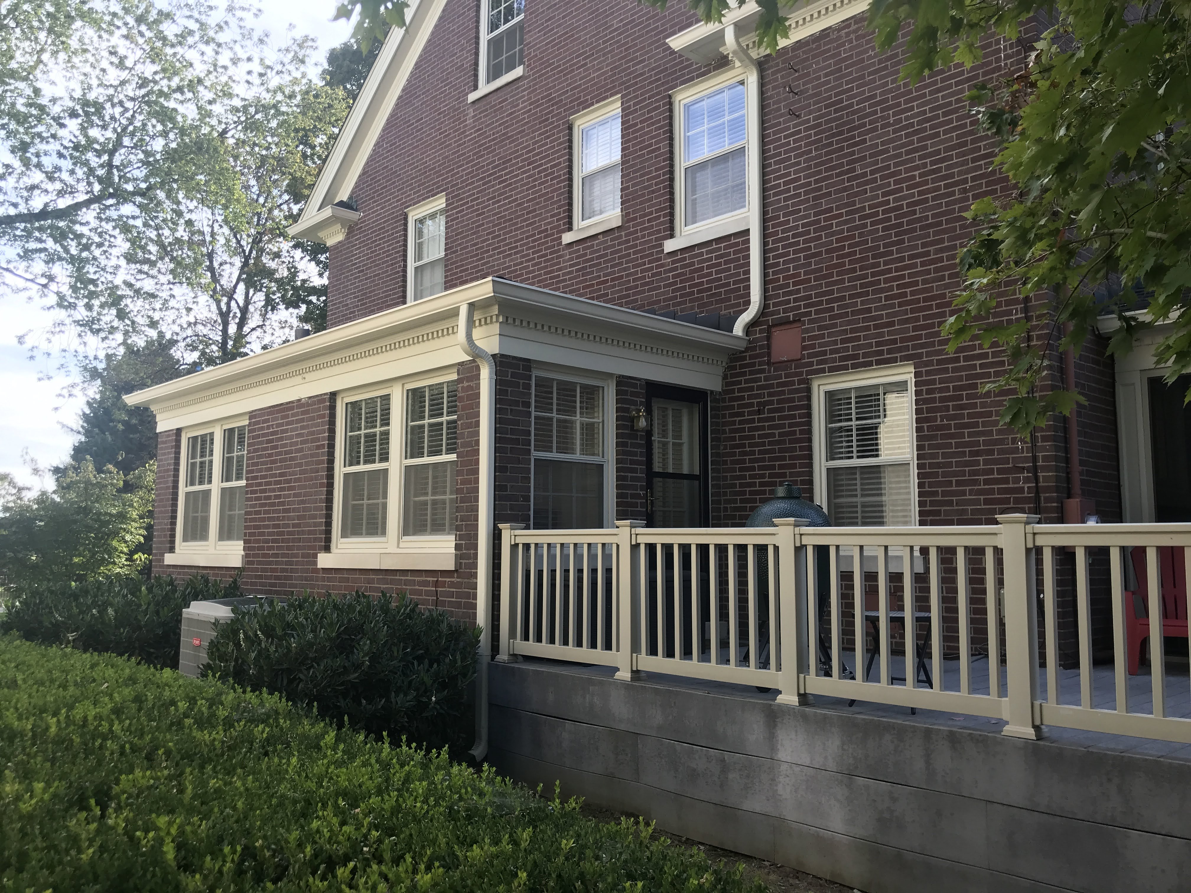

gravattedesign Posted July 7 Share Posted July 7 How can I create a Deck rim joist trim board and add a Skirt down to grade as shown in this photo. I posted a topic previously about trimming out an interior stair opening and received great advice for that issue... but it doesn't seem to work the same way for deck railing wall types. Chief X16 file attached via google Drive if needed https://drive.google.com/file/d/1c2mM_BKsUiTNLGdvs5VJqp5cueQl6vov/view?usp=drive_link Thank you for any advice. Link to comment Share on other sites More sharing options...

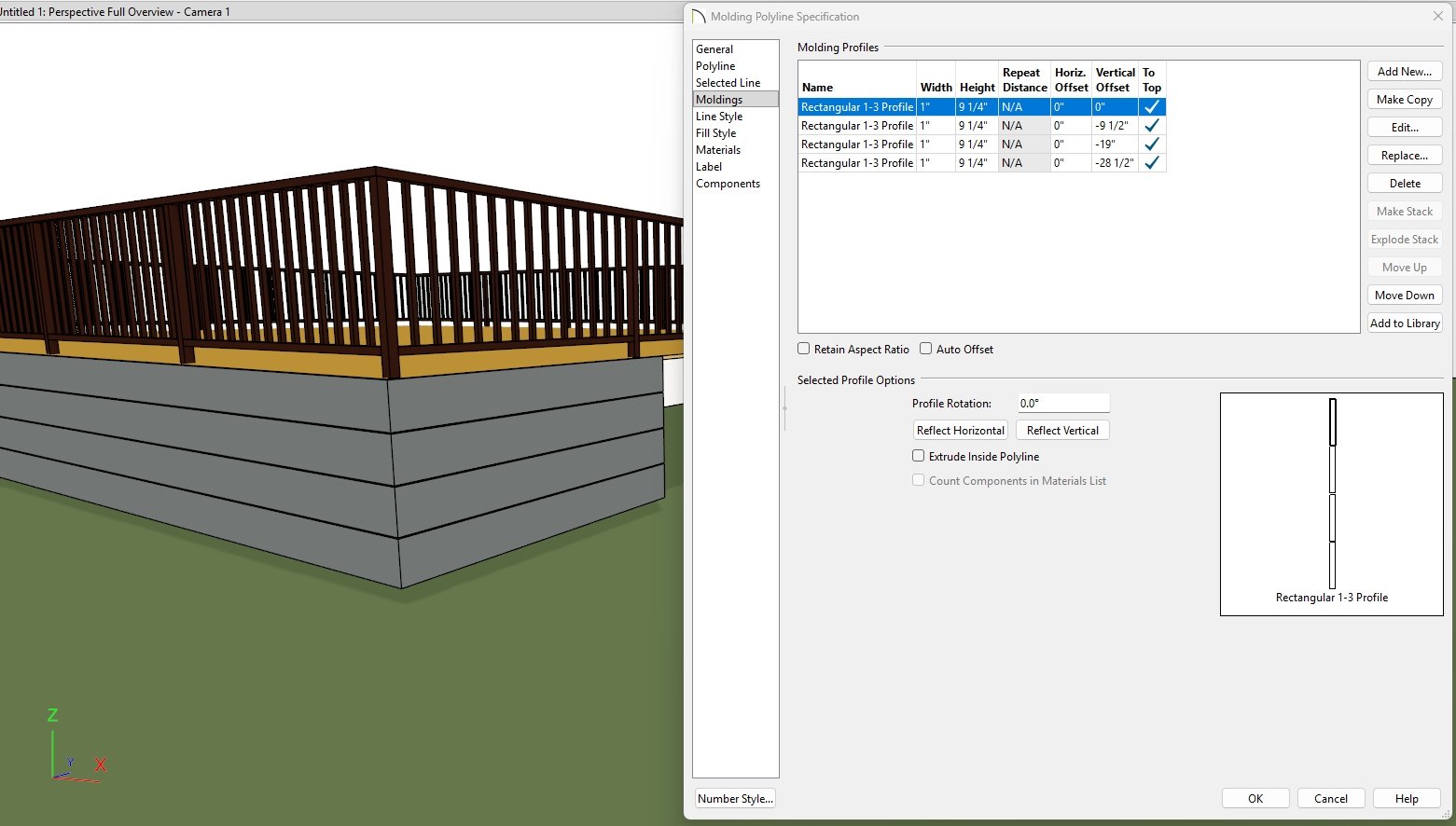

rlackore Posted July 8 Share Posted July 8 One method is to use a molding polyline: 3 3 Link to comment Share on other sites More sharing options...

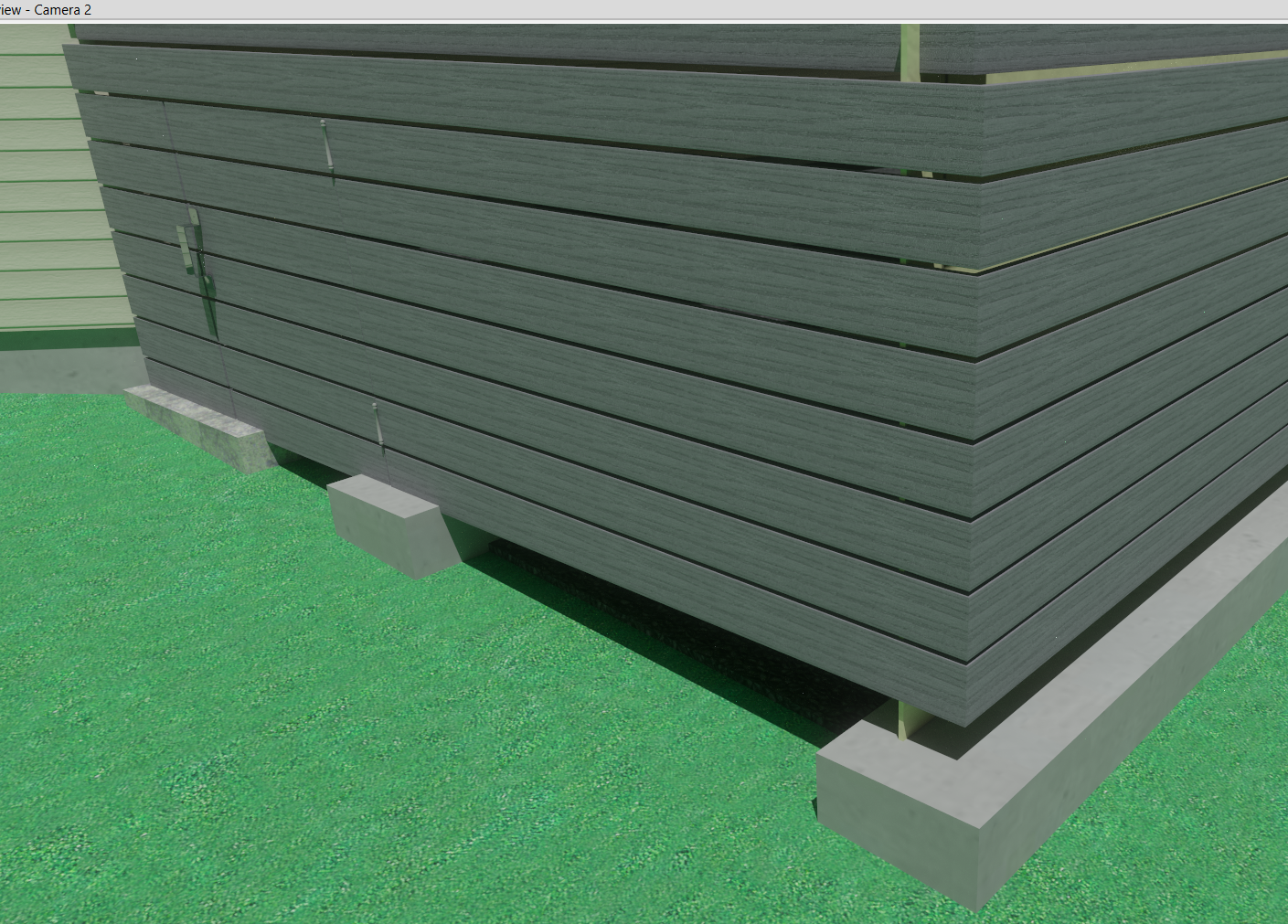

Solution joey_martin Posted July 9 Solution Share Posted July 9 12 hours ago, gravattedesign said: 'Does that mean a half wall type? No. In the framing tools there is a tool to create just general framing members. I use it all the time to create 3/4" deck fascia boards. Link to comment Share on other sites More sharing options...
