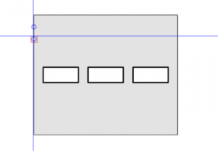

DenisonDrywall Posted Friday at 03:28 PM Share Posted Friday at 03:28 PM I created this cutom overhead door because I can never find one with the windows in the middle that so many large commercial overhead doors have. When I made the symbol, it shows the windows in the door but when I put it into the plan, the windows disappear. What did i do wrong? I recently had made a walk door with a window and had no problems. Link to comment Share on other sites More sharing options...

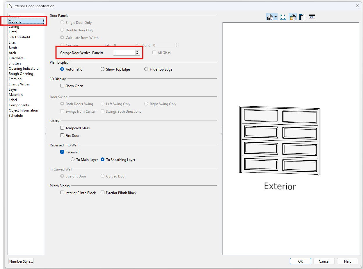

JonathanK Posted Friday at 03:41 PM Share Posted Friday at 03:41 PM (edited) Change the number of panels on your door to be 1. Edited Friday at 03:49 PM by JonathanK Link to comment Share on other sites More sharing options...

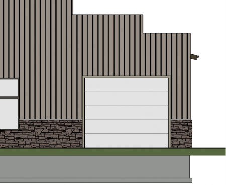

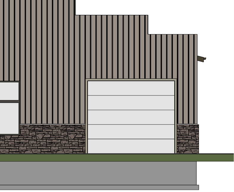

JonathanK Posted Friday at 03:46 PM Share Posted Friday at 03:46 PM (edited) But, if I were you, I would draw the panels individually on your symbol, so that it looks nice in elevation views. Then you can place the windows more accurately, and it would be realistic to how the doors actually are built. If you draw multiple panels on your door symbol, you still set the number of vertical panels to "1" like I mentioned above. I attached a "plan view" screenshot of my OH door plan. I just use this plan to create OH doors when I need a different size, or custom OH door. Edited Friday at 03:49 PM by JonathanK Link to comment Share on other sites More sharing options...

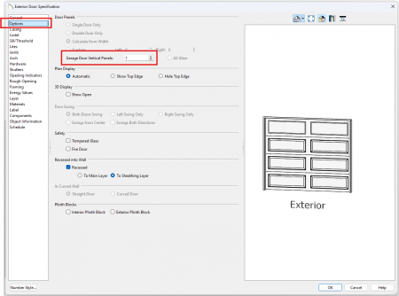

DenisonDrywall Posted Friday at 04:55 PM Author Share Posted Friday at 04:55 PM I did draw different sections but that too does not show up. And it is set to 1 panel. I wish there was a way to have 2 different panels and then I could rearrange them in their location? I don't ever see that option show up. Link to comment Share on other sites More sharing options...

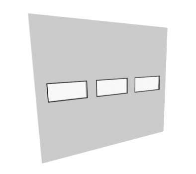

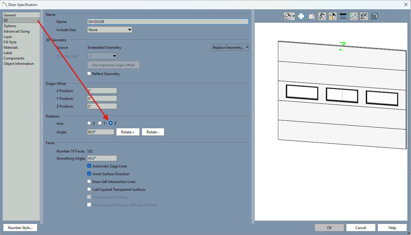

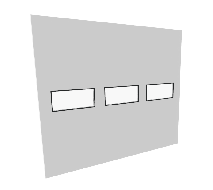

robdyck Posted Friday at 08:58 PM Share Posted Friday at 08:58 PM Hi Jennifer! You probably just need to rotate your symbol. From the Library Browser, find the door and select Open Object. Go to the 3D tab, and rotate the symbol once in the Z axis. Press OK Then, in any view, simply use the replace object tool. 1 Link to comment Share on other sites More sharing options...

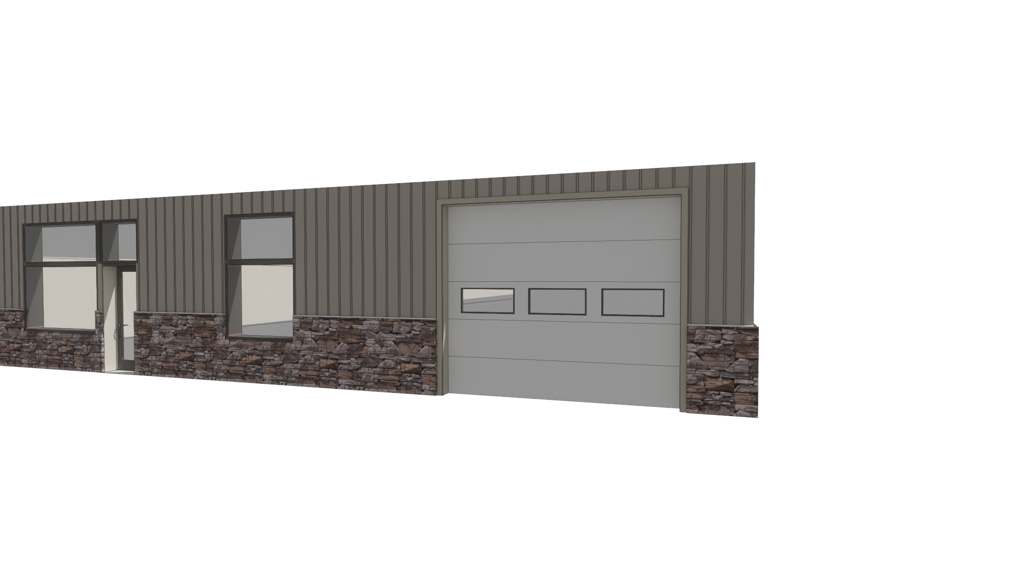

JonathanK Posted Friday at 09:53 PM Share Posted Friday at 09:53 PM Yep, I think Rob is right. Here is the door along with a screenshot of how it looks on the plan. OH Door.calibz 1 Link to comment Share on other sites More sharing options...
DenisonDrywall Posted 17 hours ago Author Share Posted 17 hours ago That was it! It worked! Thanks!!!! Link to comment Share on other sites More sharing options...
