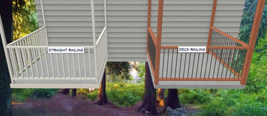

CarrieS Posted May 12 Share Posted May 12 One of the difference between the Deck Railing tool and the Straight Railing tool is the Wall Type in use. Deck Railing Tool uses "Deck Railing/Fence" wall type which does not have any drywall applied. Straight Railing Tool uses "Interior Railing" wall type which is similar setup to the Interior 4 wall with Drywall on both sides. Both of these rooms are specified as Porch: 1 Link to comment Share on other sites More sharing options...
Rich_Winsor Posted May 13 Share Posted May 13 11 hours ago, CarrieS said: Both of these rooms are specified as Porch That's a pretty fancy tree house Carrie. 1 Link to comment Share on other sites More sharing options...
