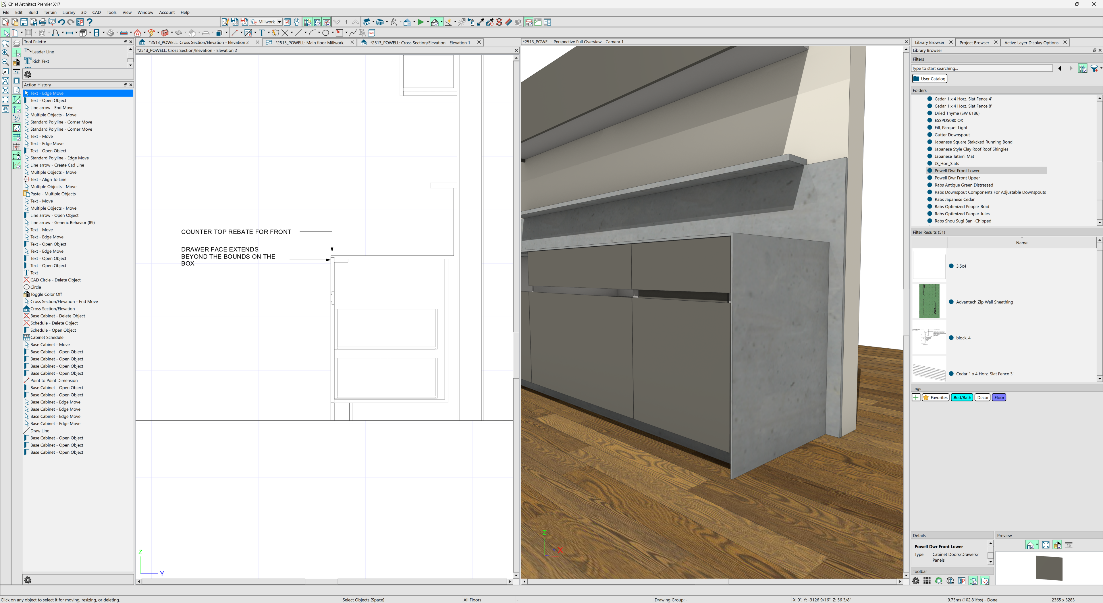

jstac13 Posted May 2 Share Posted May 2 Im struggling with the logic to approach this, It doesn't seem to allow extending native drawer fronts beyond the bounds of the box in z direction The screenshot shows solids for fronts and 1 base cabinet for drawers and another for the carcass. This is pretty messy, hoping to get some help getting this into a contained and duplicable cabinet. thnx J Link to comment Share on other sites More sharing options...

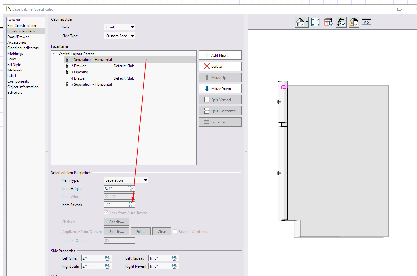

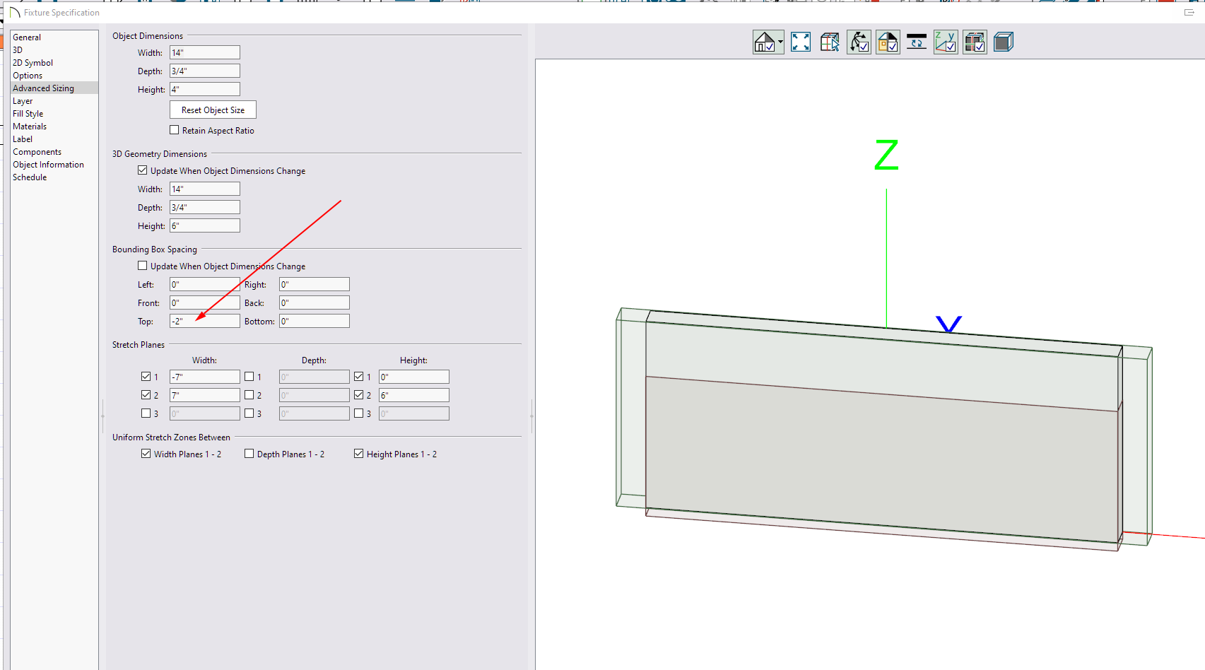

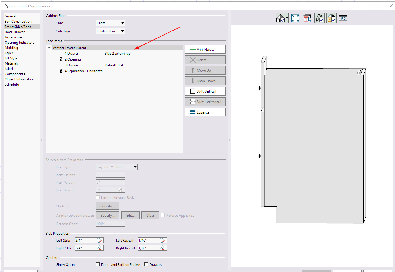

MarkMc Posted May 3 Share Posted May 3 Not exactly clear what you are after but is it any of these- first has constructions set to framed using 3/4" separation. Top separation has item reveal set to -1 makes the drawer head move up. Second the drawer head symbol has the bounding box spacing- top set to -2 which makes the drawerhead extend when no top separation is there. Link to comment Share on other sites More sharing options...
jstac13 Posted May 3 Author Share Posted May 3 Boom, perfect thanks. totally missed that. Link to comment Share on other sites More sharing options...
