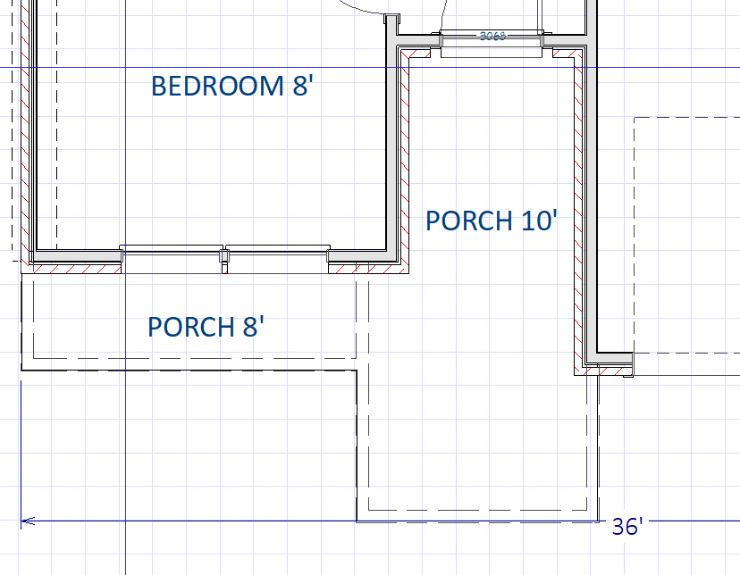

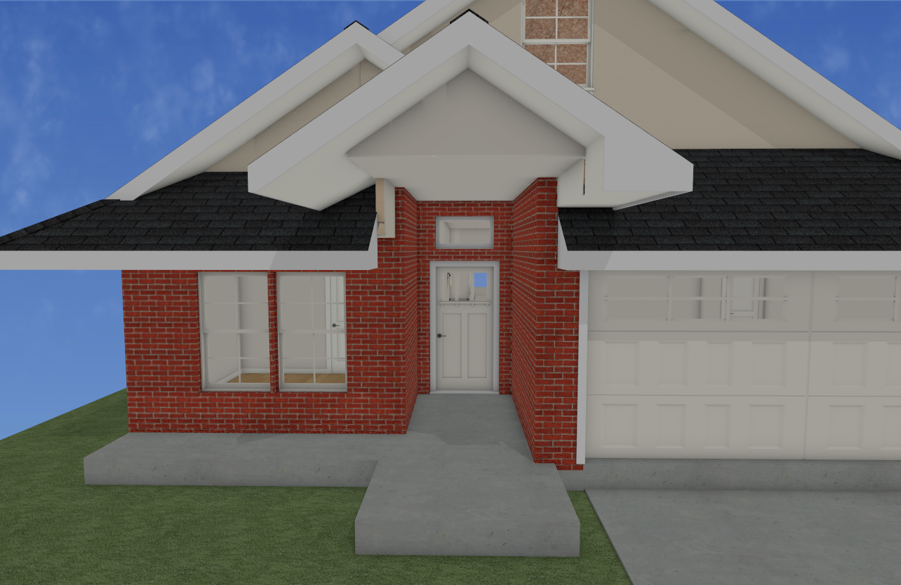

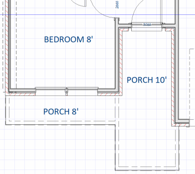

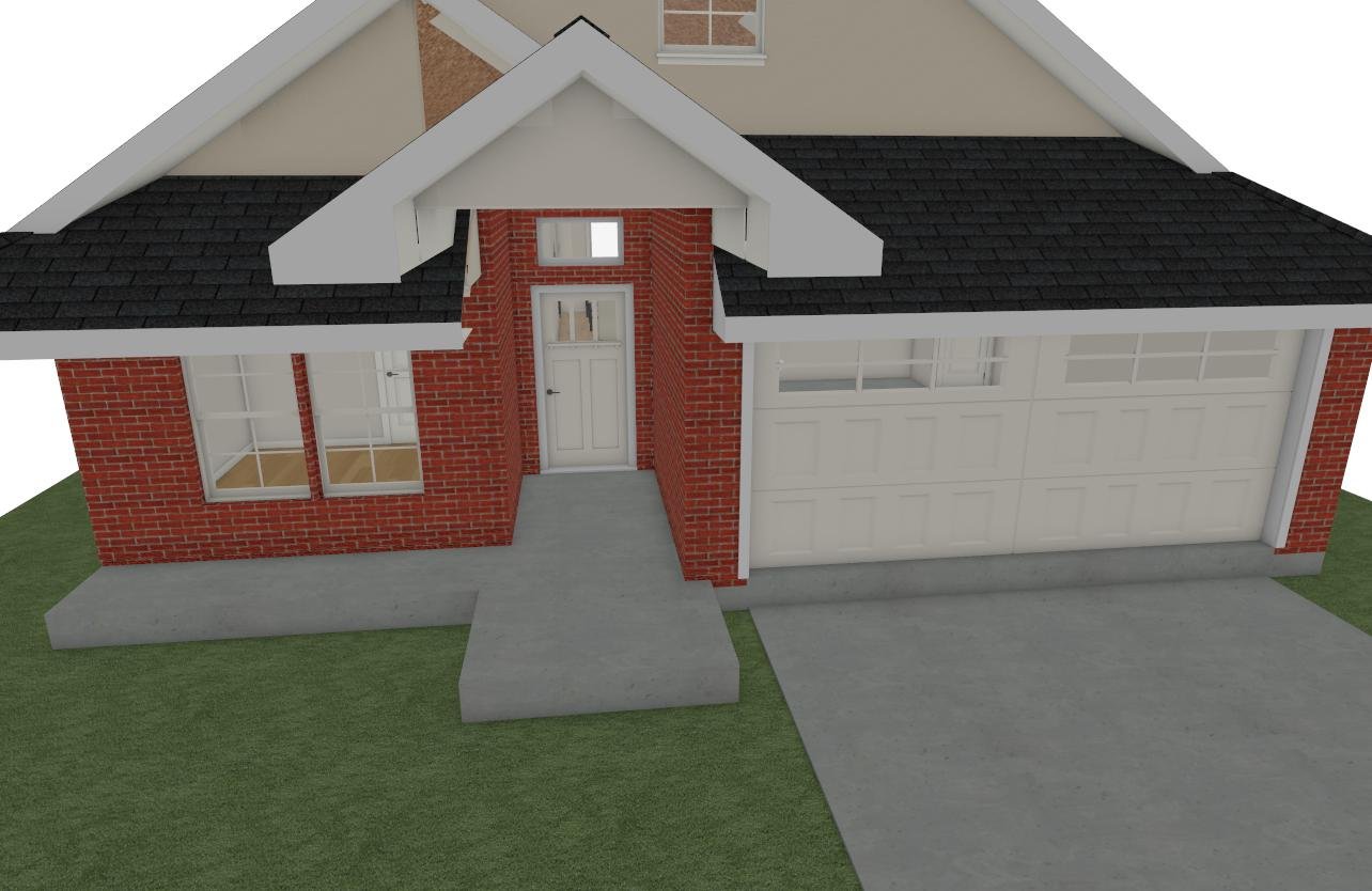

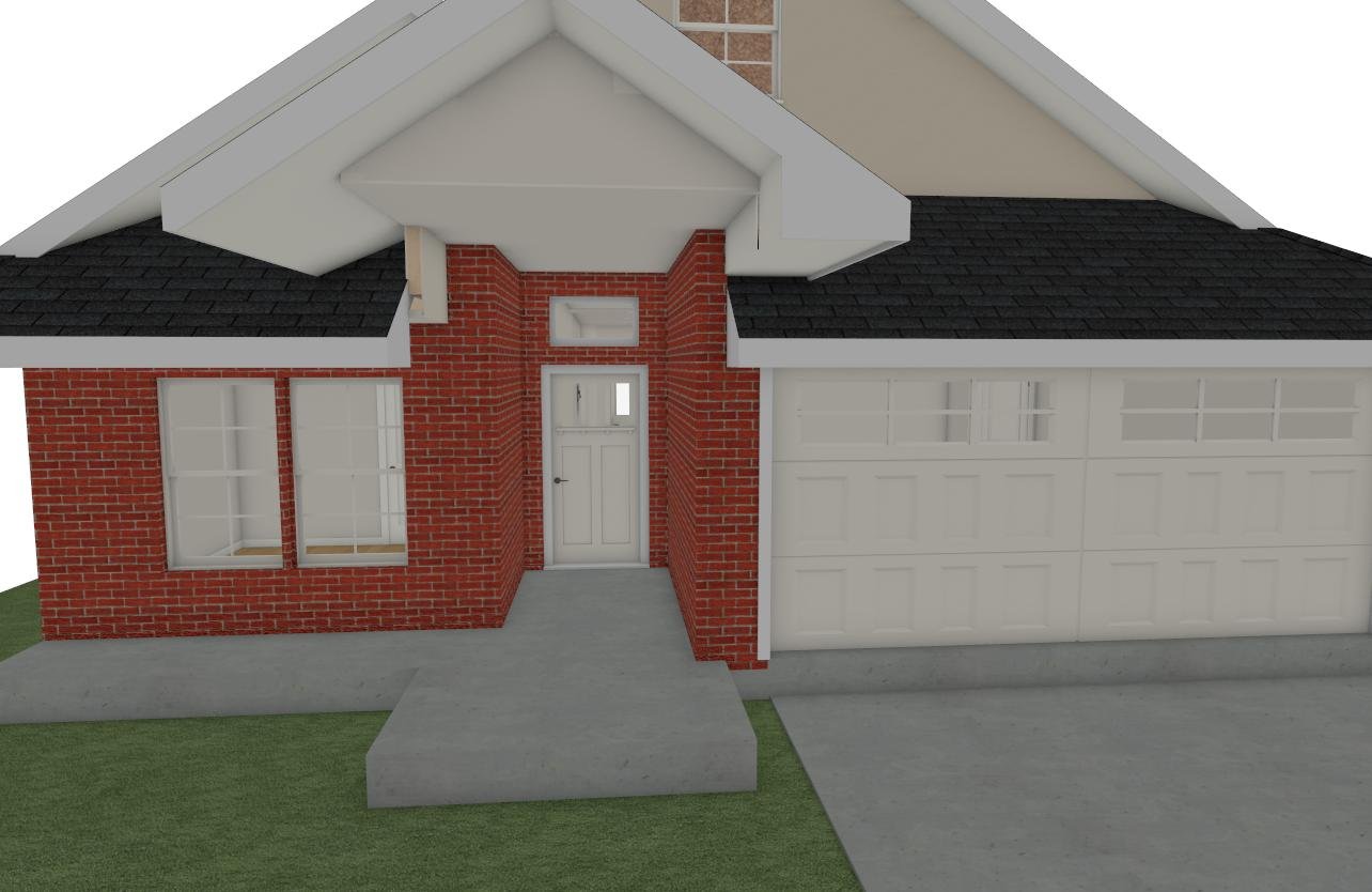

davyjones Posted April 26 Share Posted April 26 I'm having a few issues with the porch. In the 3d view, the edge is showing on the left side. Also the front has a square front on the right and not the left. Also there is a random hole on the right side in front of the garage. For the life of me I can't figure out how to get fix these issues. Link to comment Share on other sites More sharing options...

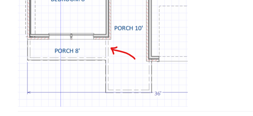

Gawdzira Posted Sunday at 01:56 PM Share Posted Sunday at 01:56 PM (edited) It is caused by the location of this wall. Try moving it towards the 8' porch and that will allow the full height of the 10' section to extend upwards. Edited Sunday at 01:57 PM by Gawdzira Link to comment Share on other sites More sharing options...

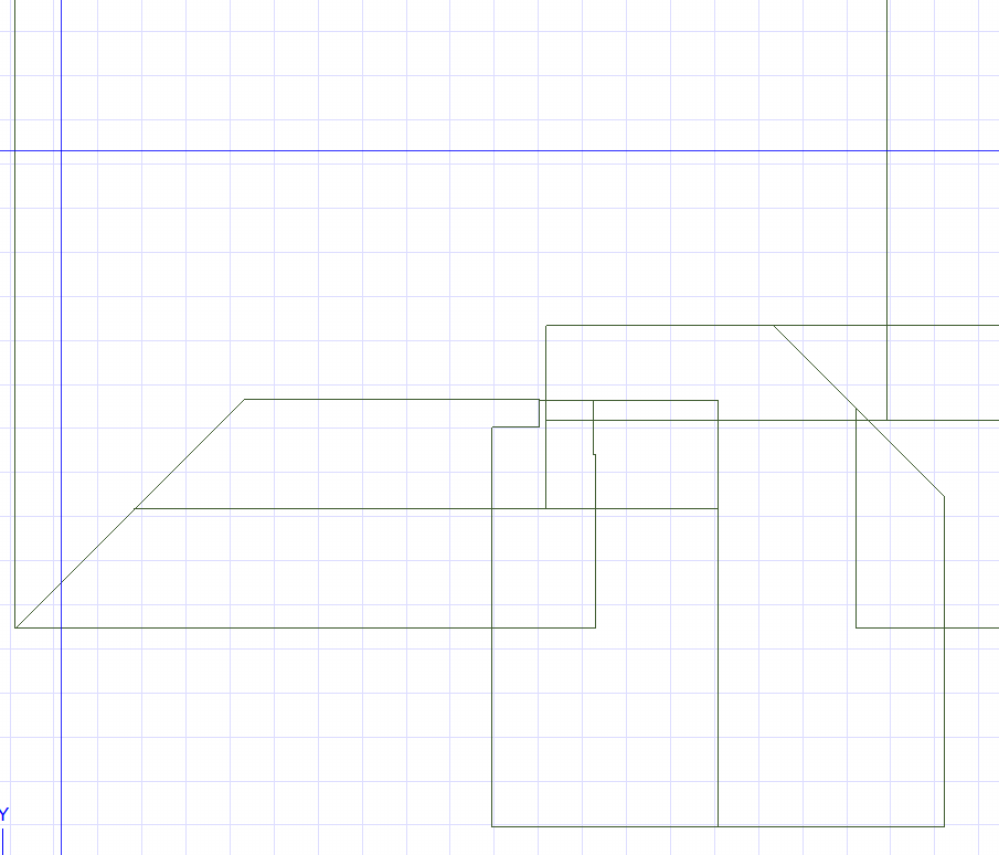

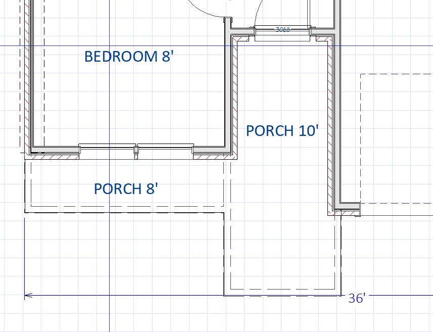

CharlesVolz Posted Sunday at 03:00 PM Share Posted Sunday at 03:00 PM Or (Option 2), cover that wall with this roof plane... Link to comment Share on other sites More sharing options...

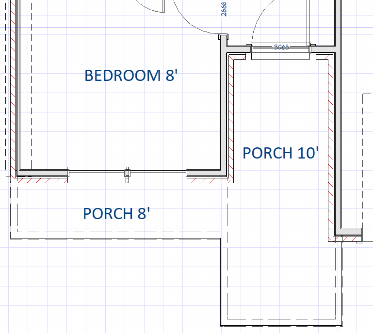

davyjones Posted Sunday at 04:01 PM Author Share Posted Sunday at 04:01 PM 2 hours ago, Gawdzira said: It is caused by the location of this wall. Try moving it towards the 8' porch and that will allow the full height of the 10' section to extend upwards. That doesn't seem to have fixed the issue. I tried moving it a little bit, then a lot. Link to comment Share on other sites More sharing options...

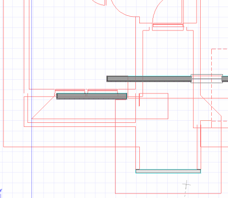

Gawdzira Posted Sunday at 06:44 PM Share Posted Sunday at 06:44 PM Look for an attic wall at that location Link to comment Share on other sites More sharing options...
CharlesVolz Posted Sunday at 08:09 PM Share Posted Sunday at 08:09 PM It looks like you moved the wall AND the roof plane edge. If the roof plane covers the wall, you will not have that problem. This fix may not be how you prefer to fix it. It is just one way. Best, Charles Link to comment Share on other sites More sharing options...

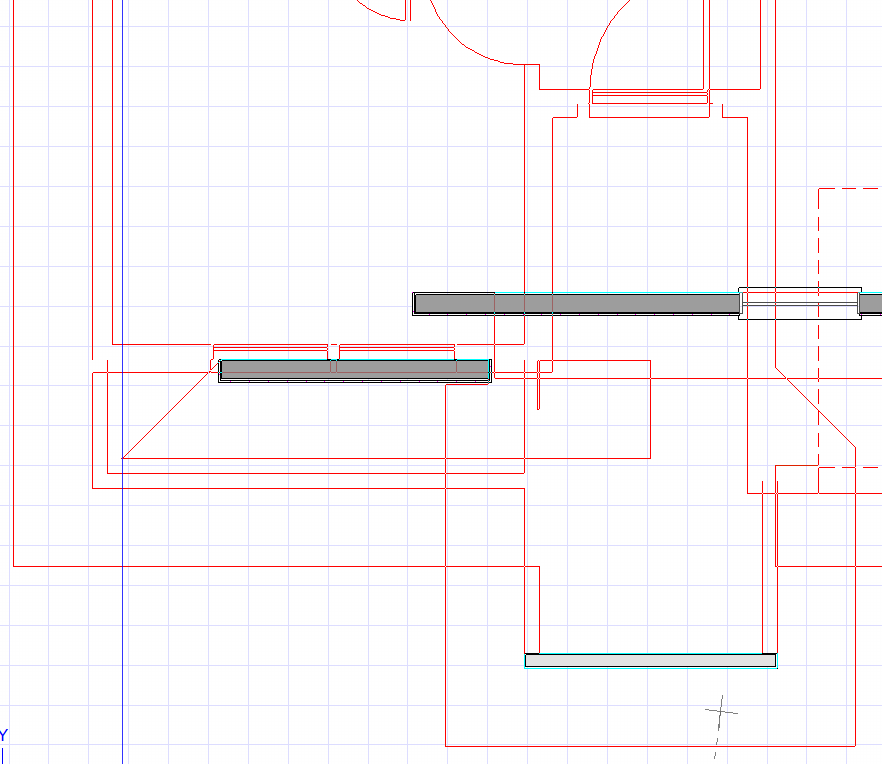

davyjones Posted Sunday at 09:54 PM Author Share Posted Sunday at 09:54 PM 3 hours ago, Gawdzira said: Look for an attic wall at that location I don't see one. 1 hour ago, CharlesVolz said: It looks like you moved the wall AND the roof plane edge. If the roof plane covers the wall, you will not have that problem. This fix may not be how you prefer to fix it. It is just one way. Best, Charles I have been trying many different things. It is getting better, but still not there. Link to comment Share on other sites More sharing options...
Gawdzira Posted Sunday at 10:25 PM Share Posted Sunday at 10:25 PM What floor are you looking on? The attic wall in that location would be on floor 2 Link to comment Share on other sites More sharing options...
davyjones Posted Monday at 04:47 AM Author Share Posted Monday at 04:47 AM 6 hours ago, Gawdzira said: What floor are you looking on? The attic wall in that location would be on floor 2 I am looking on the attic floor (there is no floor 2). Link to comment Share on other sites More sharing options...

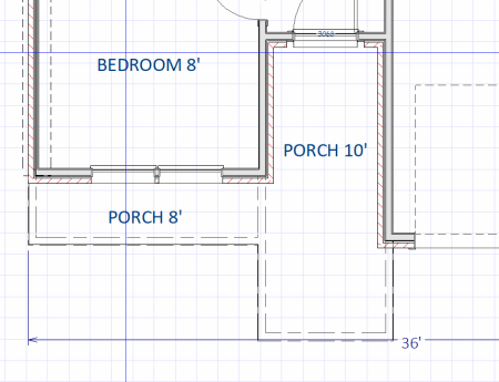

JiAngelo Posted Monday at 10:45 AM Share Posted Monday at 10:45 AM (edited) That invisible wall is 10' tall which means the 8' porch roof is stopping automatically at the wall, butting against it, not through it. Follow @CharlesVolz Option #2 above and extend the roofline to the other side of that wall is the quickest and easiest solution. You can wait and do it last if you still need autoroof turned on to finish up other design details. Edited Monday at 10:50 AM by JiAngelo typos 1 Link to comment Share on other sites More sharing options...
