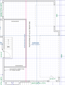

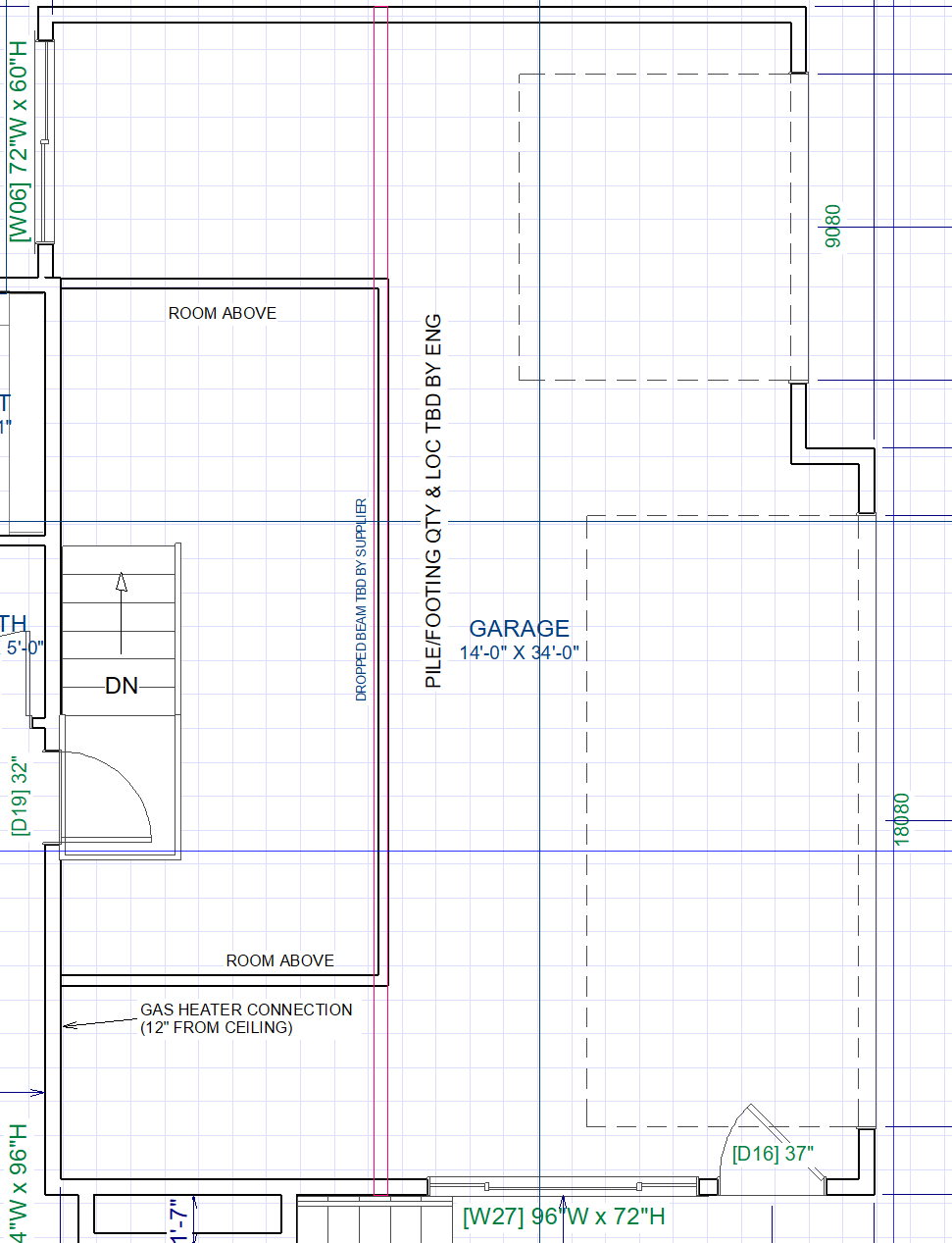

PitMan71 Posted 8 hours ago Share Posted 8 hours ago Anybody else run into an issue where Chief Architect changes multiple room ceiling heights when lowering a garage ceiling to accommodate a bonus room above? I typically design with 10' ceilings throughout. When I add a bonus room over the garage and drop the garage ceiling to 8' or 9', I’ve noticed that random rooms elsewhere in the house will also drop to 8' or 9'. It doesn’t seem consistent as to which rooms are affected. Just trying to confirm whether this is a known behavior or if I’m missing a better workflow for adding a bonus room without impacting other ceiling heights. Appreciate any insight—thanks in advance. Link to comment Share on other sites More sharing options...

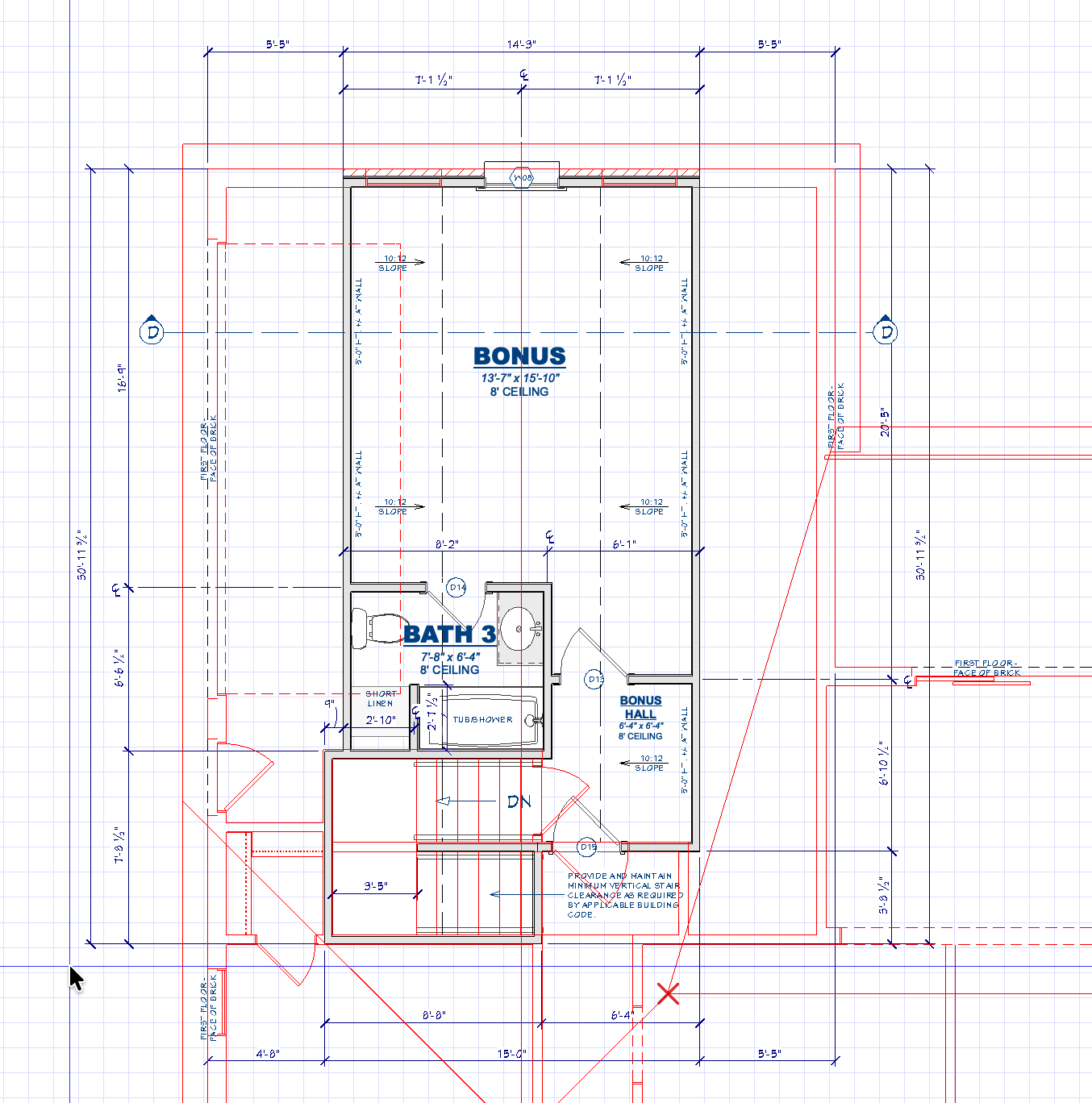

PitMan71 Posted 2 hours ago Author Share Posted 2 hours ago 1 hour ago, Rosco2017 said: You have to be very careful when lowering a ceiling when you have floors above. For example: If you have a room or even part of a room that hangs over the area you lower, it will drag that down as well. The only way around it that I know of is to use invisible walls below the rooms you don't want to change above and then lower your room. Does that make sense? the only room I have in the second floor is the bonus area above the garage. When I lower the garage the allow for more ceiling space in the bonus room somehow other room's ceilings are also lowered. What I am probably going to do is draw a test house and play around with it to see what's happening. I get a lot of my answers that way. 1 Link to comment Share on other sites More sharing options...
SHCanada2 Posted 1 hour ago Share Posted 1 hour ago 6 hours ago, PitMan71 said: Just trying to confirm whether this is a known behavior yes, it happens. as rosco mentions usually because there is another room or the rooms do not line up exactly. For instance for a bonus room on top of part of the garage, you would draw invisible room in the garage that matches the room above 1 Link to comment Share on other sites More sharing options...
