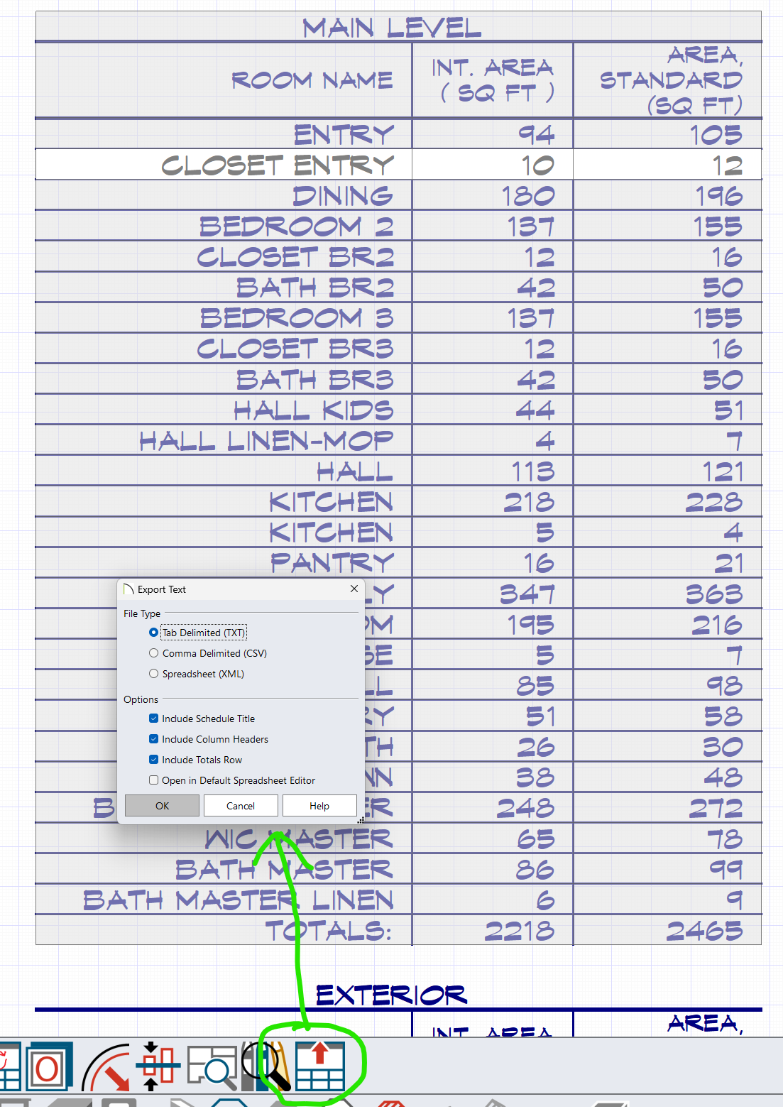

JiAngelo Posted April 4 Share Posted April 4 When you select the table there is an "export text" icon (circled green below) that is also on the right-click menu. selecting the icon opens up options for TXT, CSV and XML exports. For CSV I normally check "open in default spreadsheet editor" and it automatically opens in XLS after export. You can then resave in XLS format or keep it as CSV. When I save it in XLS format, I can add columns to the right that calculate on the data in the imported columns. On subsequent exports to a new CSV filename, I can cut and paste the new imported data over the old imported columns in my XLS format and the calculations will update themselves based on the new data provided. Link to comment Share on other sites More sharing options...

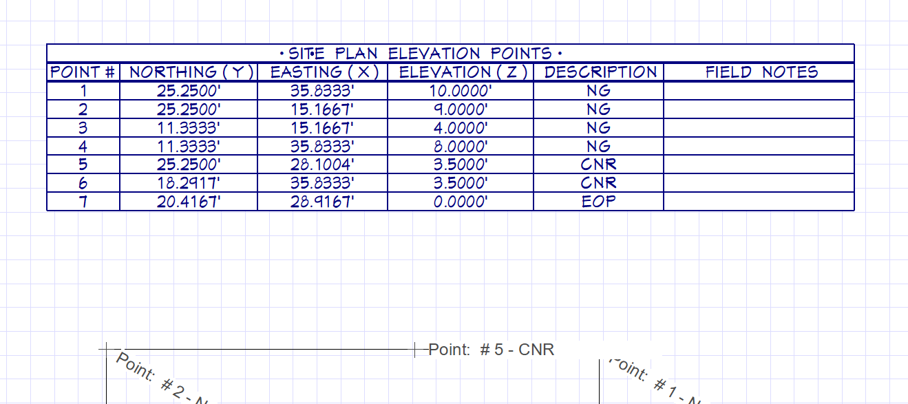

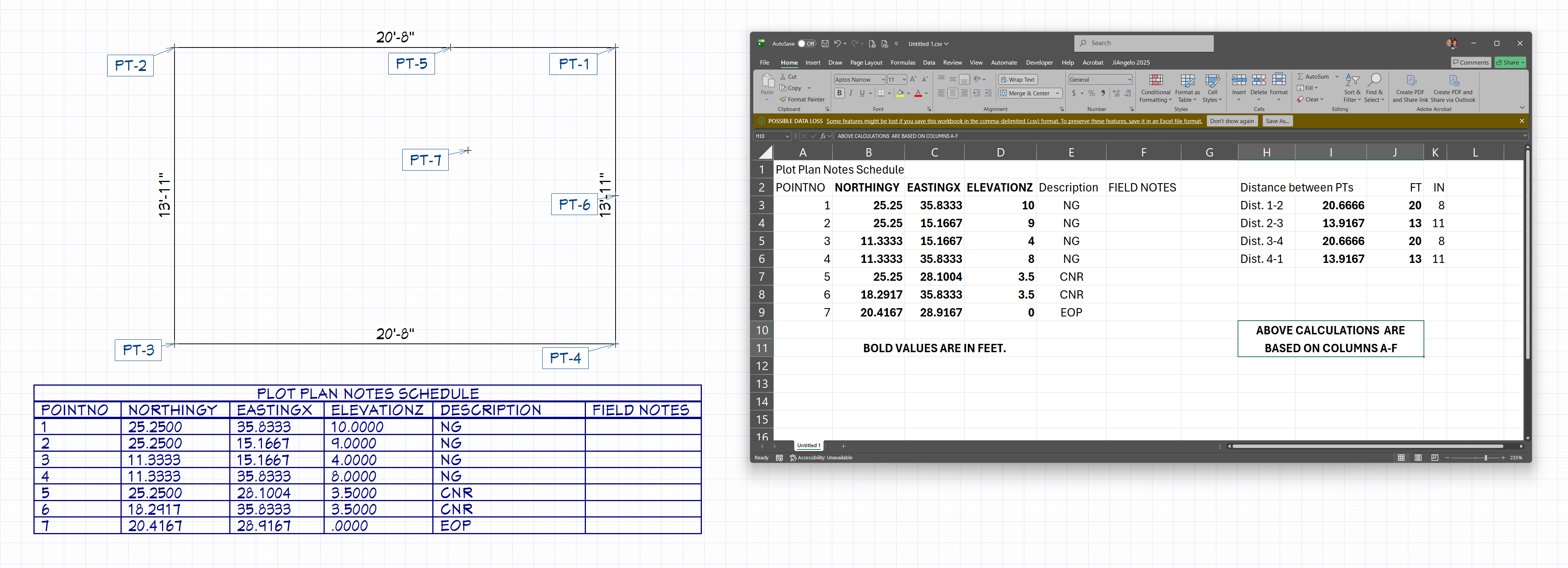

JiAngelo Posted April 4 Share Posted April 4 Would have taken less time if you'd posted your plan. I agree Chief could provide a simpler way to create a CSV table of elevation points. I used a Plot Plan Note, added custom fields to match yours, and added some custom macros that /12 and round(4) decimal places for macro values elevationf, x_position & y_position. The Plan Notes Schedule allows you to specify 4 trailing zeros. Everything is now shown in feet, so I didn't bother to call that out. Each Note has an arrow to read an elevation point's data. Once you have one created and showing the correct values, you can copy & paste/move the note+arrow to the next point and it will auto populate the schedule if you uncheck "group similar objects". They will incrementally number themselves with each copy/paste, then on the schedule you can drag them into the order you want and they will renumber again automatically. (I actually added an extra field to know which was #1, #2, etc. which made it easier to order the POINTNO field. After I exported to CSV, I added some calculations to the right to get perimeter distances between the points 1-4 and doublecheck everything.. If your macro is 10 years old, it probably needs adjusted like @Alaskan_Son indicated above. Link to comment Share on other sites More sharing options...

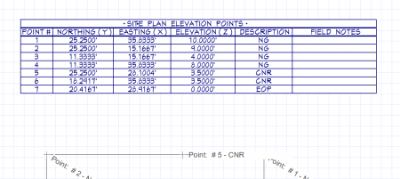

marklcc Posted April 6 Author Share Posted April 6 CHOPSAW made me a elevation point and elevation point schedule 4 years ago that worked great, the elevation point had the point number, x, y, z, description built into it and it propagated to the schedule he made and it would write the data to a file. Link to comment Share on other sites More sharing options...
