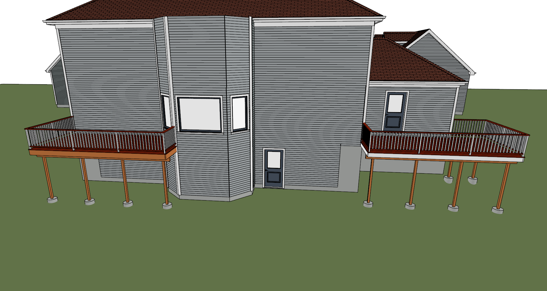

tbuck1db Posted March 19 Share Posted March 19 There seems to be many people who have had this problem. I've tried all of the suggetions in other peoples post and not found whatever it is preventing me from building my deck framing. Can anyone see what I am doing wrong? Thanks, Thomas O'grady As built.zip Link to comment Share on other sites More sharing options...
tbuck1db Posted March 19 Author Share Posted March 19 Current version is X17 Link to comment Share on other sites More sharing options...

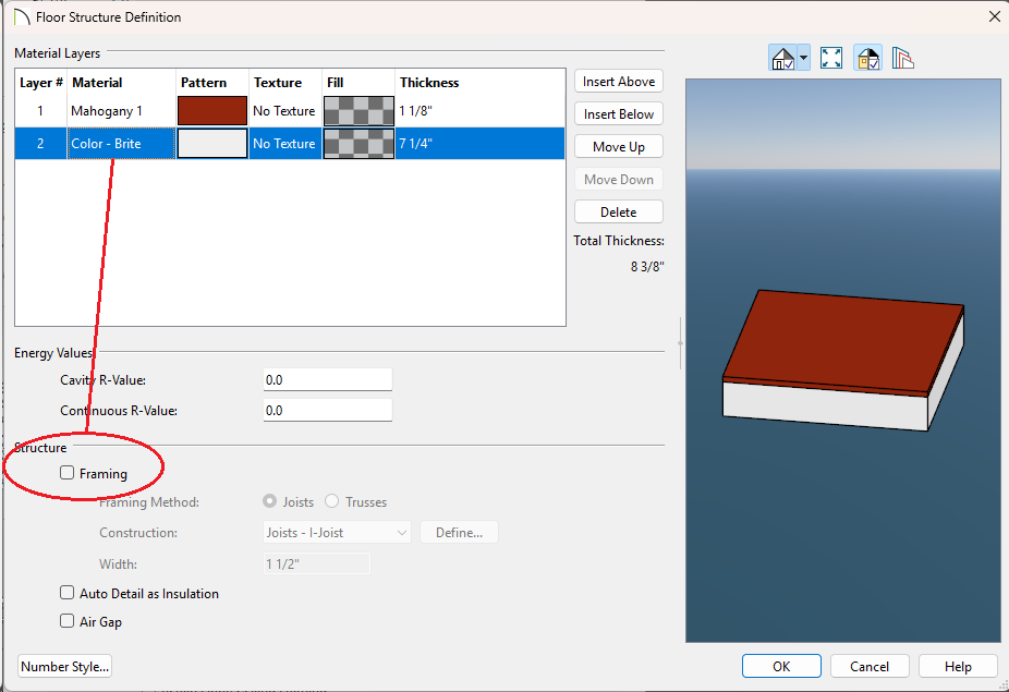

DBCooper Posted March 19 Share Posted March 19 (edited) Your floor structure is setup wrong. Your joists are not set to be framing. Once you set them to be framing, the decks should look better: Edited March 19 by DBCooper 1 Link to comment Share on other sites More sharing options...
tbuck1db Posted March 20 Author Share Posted March 20 Thanks so much! Always some stupid little thing. Link to comment Share on other sites More sharing options...
Doug_N Posted March 20 Share Posted March 20 16 hours ago, DBCooper said: Your floor structure is setup wrong. Your joists are not set to be framing. Once you set them to be framing, the decks should look better: Hey Coop! Wow, I spent a few hours trying to figure that out myself and did not notice that. Well done and to gold stars!!! Link to comment Share on other sites More sharing options...
DBCooper Posted March 20 Share Posted March 20 Just picking low hanging fruit. I see lots of plans with framing problems because a wall, floor, or roof layer was marked as framing that shouldn't be or wasn't marked as framing when it should be. The other common problem with decks is room definition problems. Just make one wall "no room definition" and your framing goes bye-bye. After that, then you can start looking for all of the other weird cases and that can get very time consuming. 1 Link to comment Share on other sites More sharing options...
