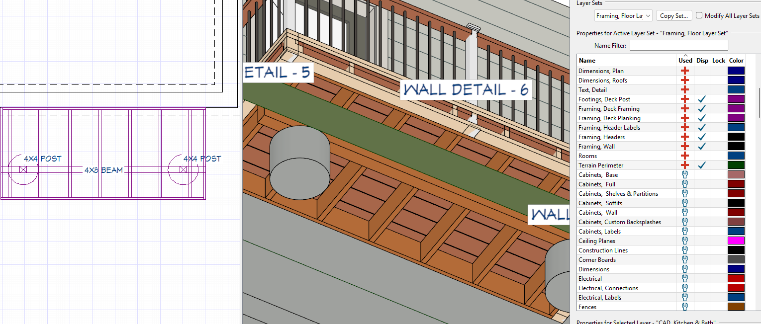

  1. Fresh copy with changes Westford addition.zip
  2. i'VE CHANGED ALL OF THESE THINGS AND STILL CAN'T GET A STRUCTURE TO GENERATE. The settings also keep changing to other things, without me touching them.
  3. "CHECK AUTOMATICALLY REGENERATE DECK FRAMING" IS CHECKED
  4. I've got the layers marked as "framing" so not sue what is preventing my deck framing from generating this time. Westford addition.zip
  5. I'm having trouble getting the deck framing to show. I have the layers of the floor framing both marked as "framing", so it is something else this time.
    1. Maxbuild
      Maxbuild
      Newbie with same issue.  Tried every help video and posting I could find.
      After over an hour found something that may or may not be of use: while framing generated in program was not visible.  Visibilityi is controlled by Active Layer Display Options - perhaps that is the case here?
      They did not show up in 2D.  based on another answer opened up Active Layer Display Options, sorted on Used column, and check every framing option to Show.  then found the deck framing on the floor Zero layer below.  Bottom of the learning curve here...
      Now I have to figure out why the odd 6" high kneewall is there at deck perimeter.
