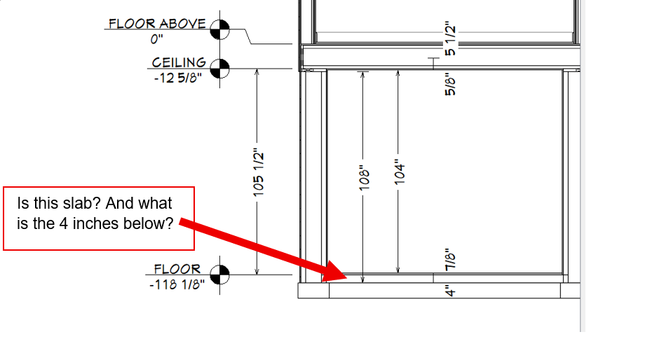

Novaks Posted 17 hours ago Share Posted 17 hours ago When trying to adjust our ceiling heights, the auto display that is given has this element, wondering if that is the 4-inch concrete slab or if the slab is represented by the 4-inch element shown below it. This is on the foundation level in the basement. Link to comment Share on other sites More sharing options...
CharlesVolz Posted 14 hours ago Share Posted 14 hours ago That is the slab (at the tip of your arrow). The 4" is the dimension for that (see the dimension line). Below that is the stem wall footing beyond. Zooming way in may help you. Best, Charles Link to comment Share on other sites More sharing options...
mtldesigns Posted 12 hours ago Share Posted 12 hours ago 4 hours ago, Novaks said: the 4-inch element shown below it. The 7/8" is the total of your floor thickness material (you can see this in the room dbx). for example carpet and padding. The 4" is your slab. Just how Charles described. Link to comment Share on other sites More sharing options...
