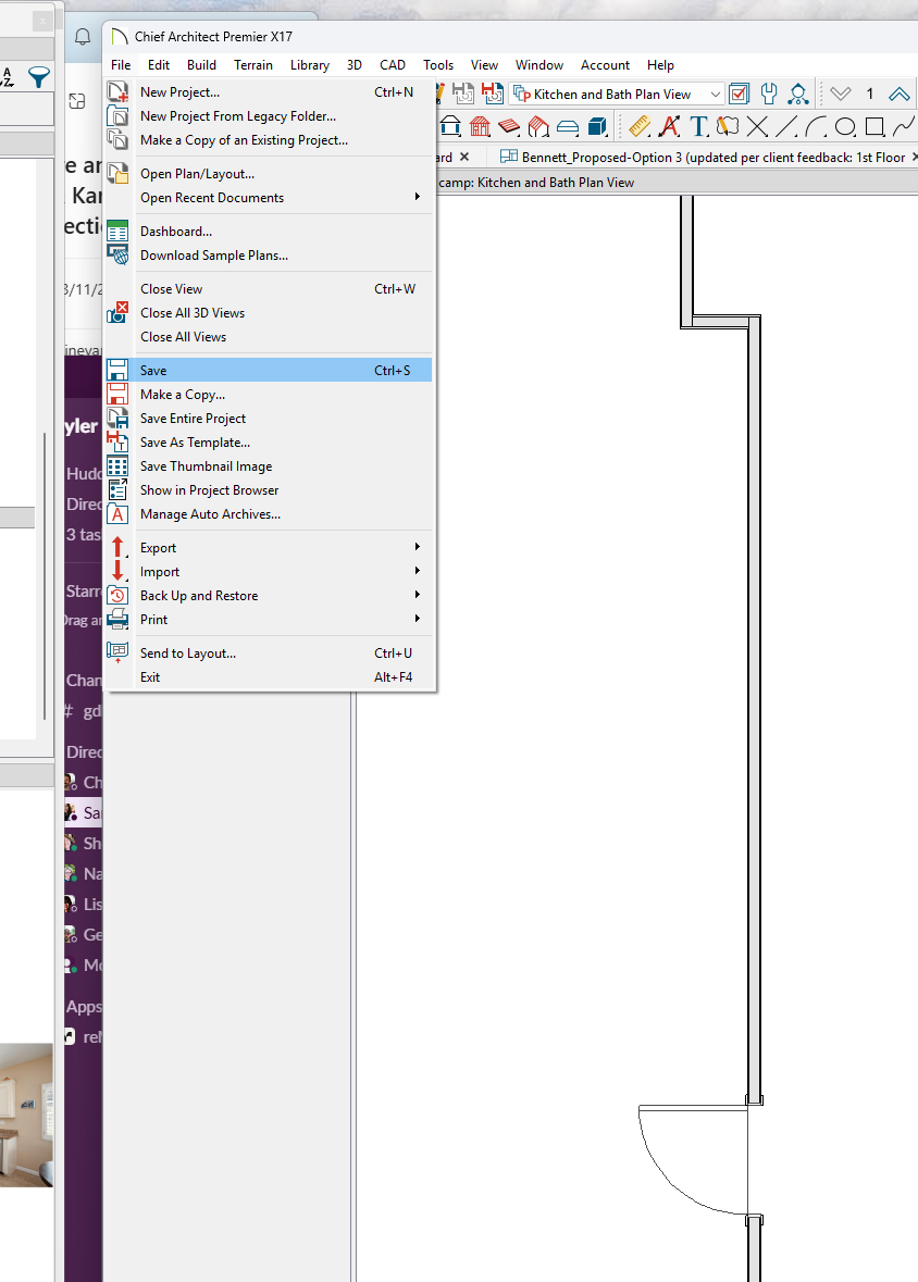

Renerabbitt Posted March 8 Share Posted March 8 See this video: 1 1 Link to comment Share on other sites More sharing options...
