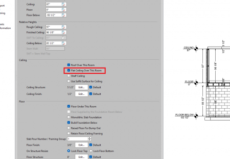

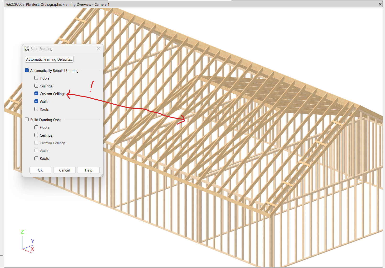

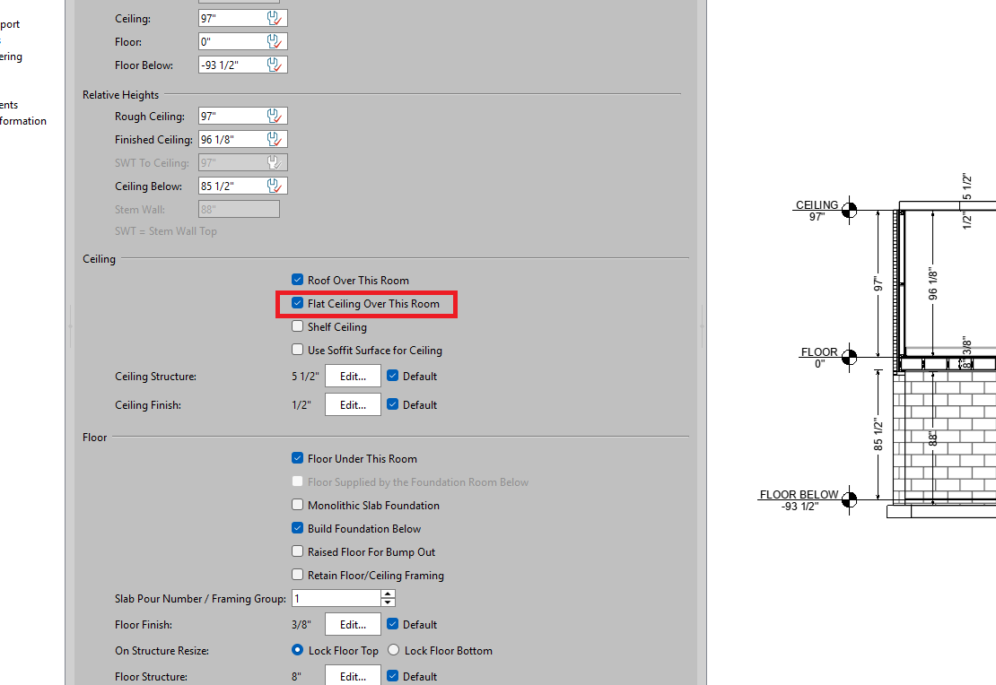

JKEdmo Posted March 7 Share Posted March 7 9 hours ago, A-claycomb said: I am using CA v17 software. I have used chief for 40 years, and this is a new problem. How to get the cathedral ceiling framing to work. I have tried auto roof framing. Will not draw the framing. Please send the information for this. I was able to get the vaulted ceiling framing to build by checking this box: Link to comment Share on other sites More sharing options...
