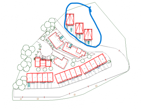

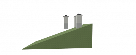

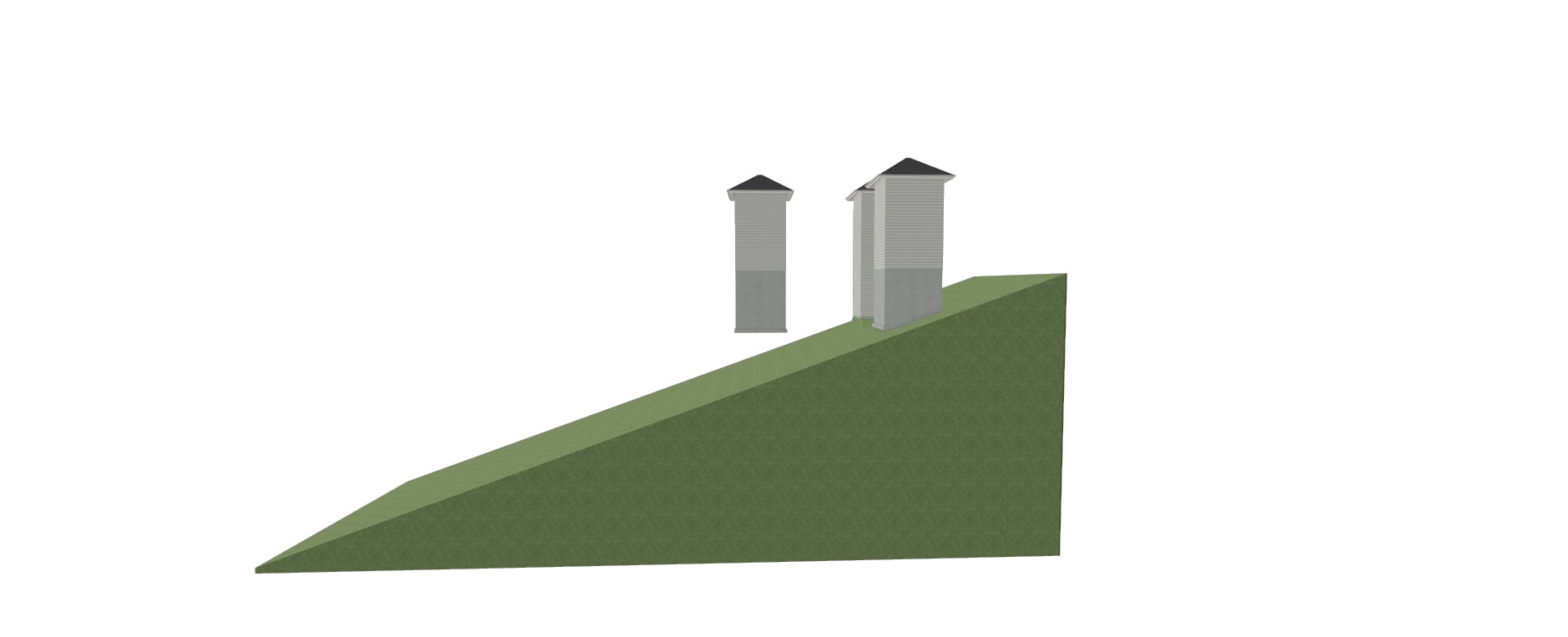

decorators3 Posted February 24 Share Posted February 24 Hi I have three houses that are on a two sided sloped terrain , Not only are they on a sloped terrain they also need to show at three different heights like steps But when I slope the terrain the first house sits right but the next house just floats how do i adjust their heights so they look like steps. Terrains are my nemesis in this project and without DWG contour elevation heights its just a guessing game. The client wants these three houses to sit higher and at the correct angles Ive attached an image marking the houses. I've viewed terrain videos and tried adding valleys hills - terrain regions.. any direction is welcomed Cheers Levina 2 Link to comment Share on other sites More sharing options...

decorators3 Posted February 24 Author Share Posted February 24 12 minutes ago, Rookie65 said: Isn't this the same thing you asked about on 2/11? yes - but i have the site done completed . and all is good ,, I'm just trying to get these three house at different heights and not floating like this sample Link to comment Share on other sites More sharing options...
Rookie65 Posted February 24 Share Posted February 24 And it was suggested to lower the floors to drop them down to align with the terrain. Plus there were other suggestions at the same time. If the terrain drops 40" or whatever, then set floor one to -40 1 Link to comment Share on other sites More sharing options...
decorators3 Posted February 24 Author Share Posted February 24 17 minutes ago, Rookie65 said: And it was suggested to lower the floors to drop them down to align with the terrain. Plus there were other suggestions at the same time. If the terrain drops 40" or whatever, then set floor one to -40 yes I know thanks I was so frustrated that I didn't read properly,, thnks 2 Link to comment Share on other sites More sharing options...
