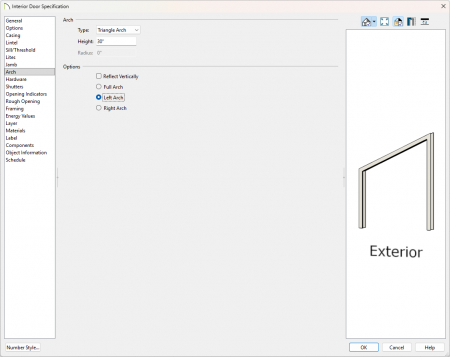

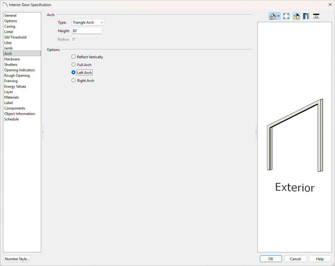

DBCooper Posted January 30 Share Posted January 30 You could also use a "triangle arch" set to either left or right side. Still have to fuss with the arch height to get the right slope though. Not sure why we don't have the shape options for doors though. Might want to send in a feature request for this. Link to comment Share on other sites More sharing options...
