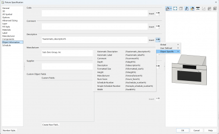

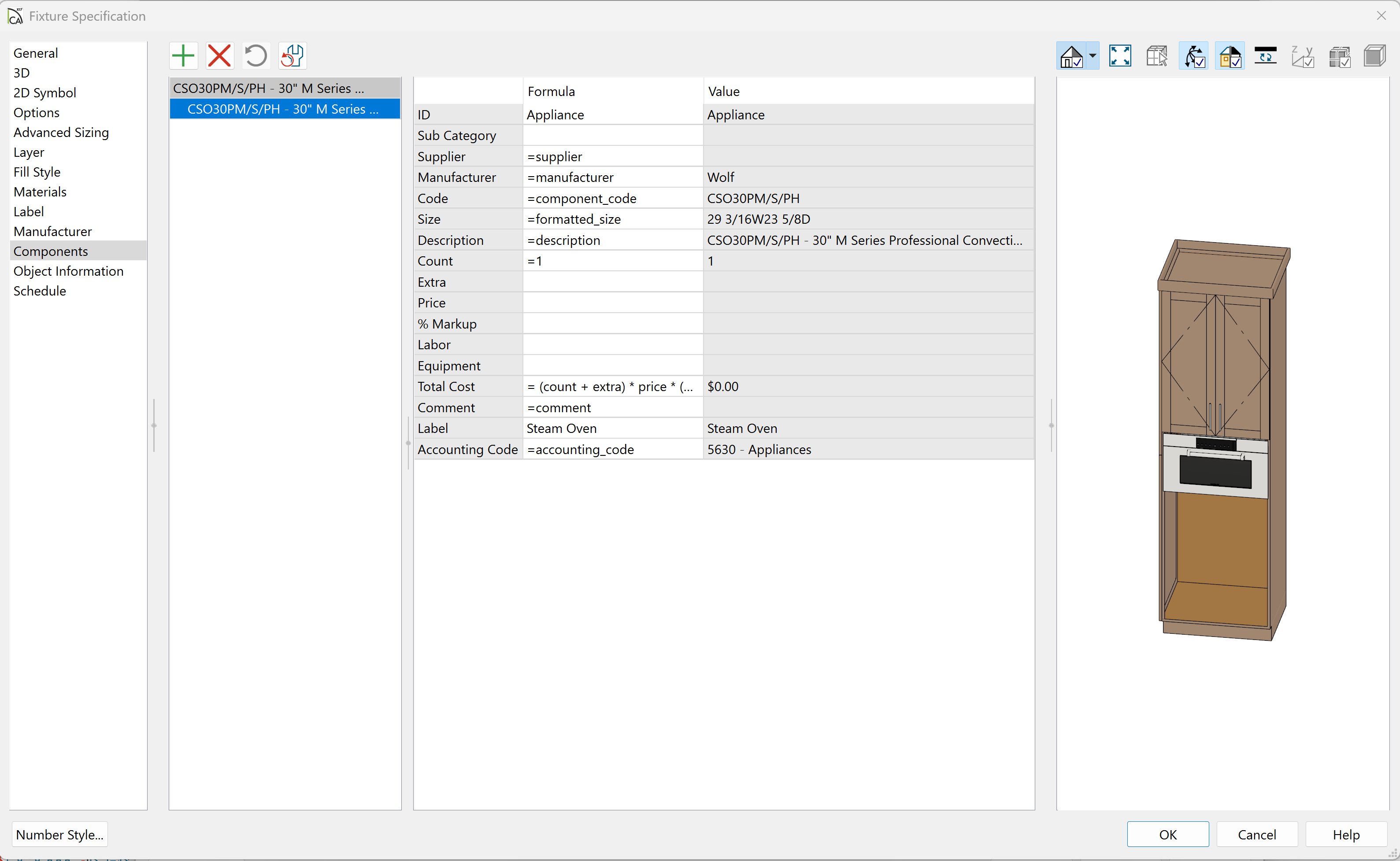

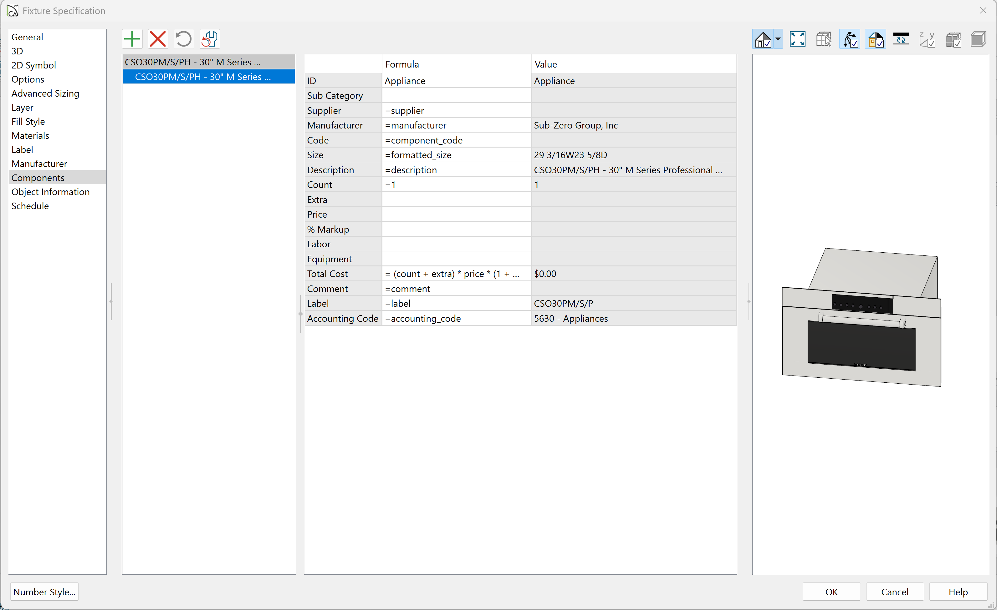

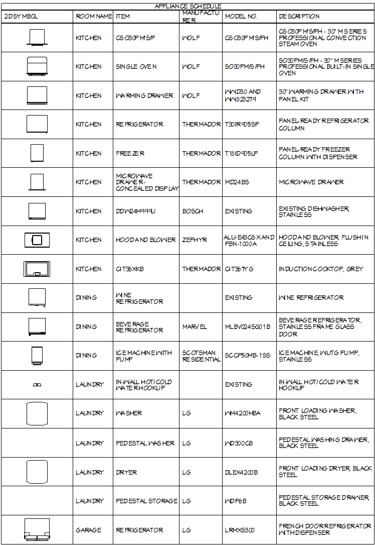

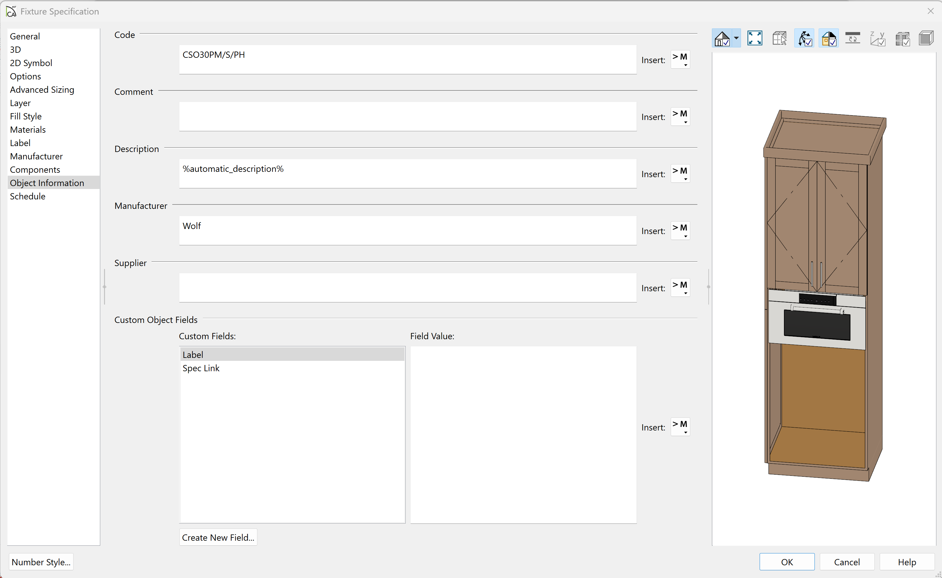

I am trying to change the item description to "Steam Oven" for the first appliance in my schedule.  I have gone into the component mode and object mode and tried changing everything but the Item column will not change.  This is for the Wolf CSO30PM/S/PH Steam Oven.  I also have the same problem with the Bosch dishwasher. I need it to say "Dishwasher" in the Item column.  I don't want to go into the schedule on the plan and put a text box over the Item box because I want to be able to move the schedule around without forgetting to move the text box.  It seems like I should be able to find where the Item data is pulled from.  I even copied the original fixture to my User Library to see if I could get to the source of the Item column but can't find it.

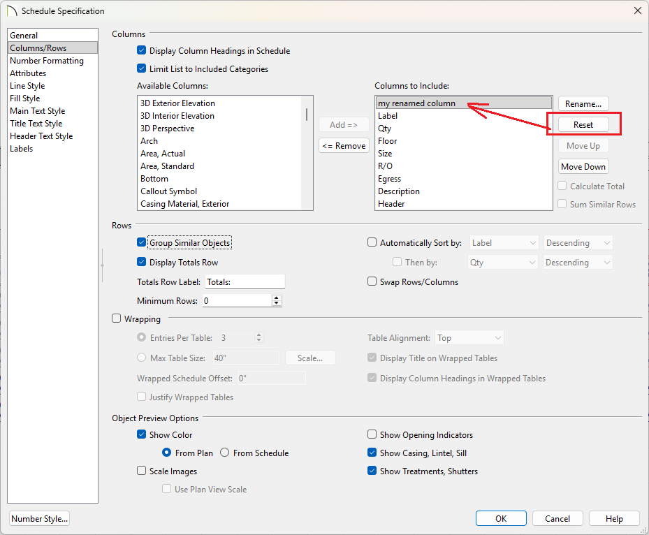

Also FYI you can rename your Column To Include to
%"Label";"Item"%
 so that the schedule prints Item but reminds you that its from the label
