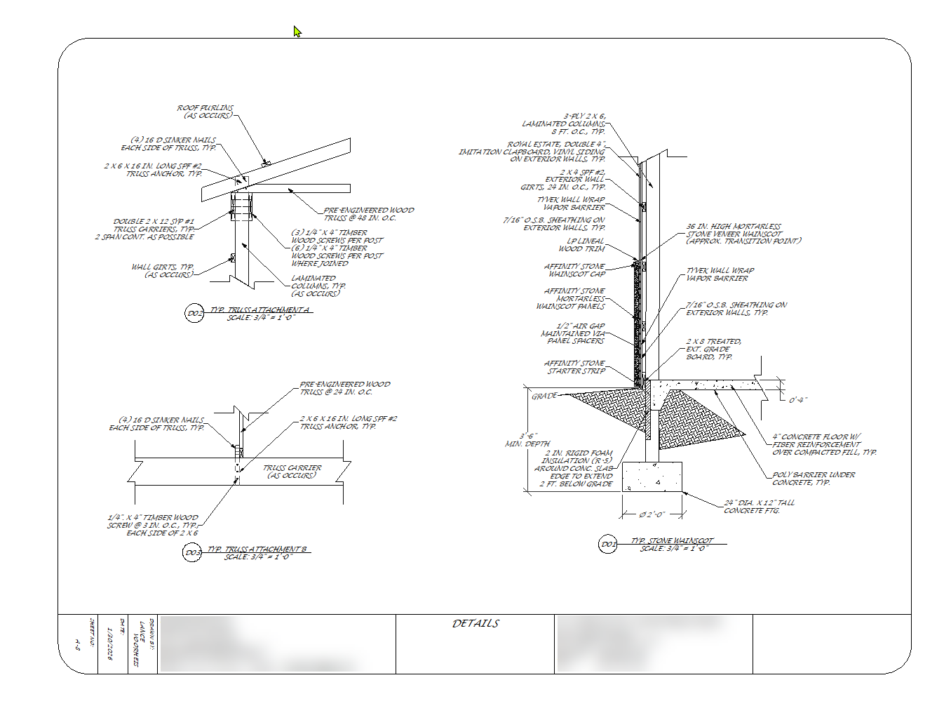

clay1205 Posted January 28 Share Posted January 28 (edited) Hello. I have not posted much but have read alit of your tips. Very helpful, so thank you. Wanted to ask, how do you folks deal with the typical wall sections required for permitting? I used AutoCAD for 20 years before switching to Chief, and I would never think of going back, but I still use it for my wall sections since I have not found a good way to generate a detailed section in Chief. Any suggestions would be greatly appreciated. Using X16 not 12.... Thanks in advance. Edited January 28 by clay1205 Link to comment Share on other sites More sharing options...

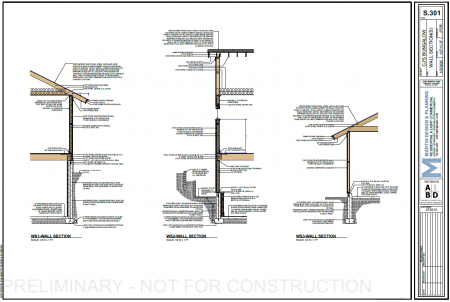

joey_martin Posted January 30 Share Posted January 30 These are live camera views. I cut 12" sections from my model and label them. 1 Link to comment Share on other sites More sharing options...
