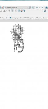

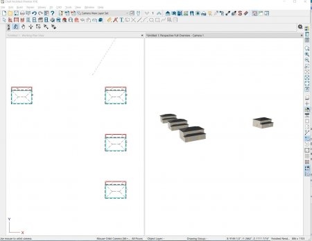

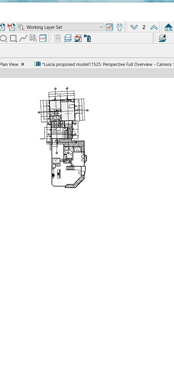

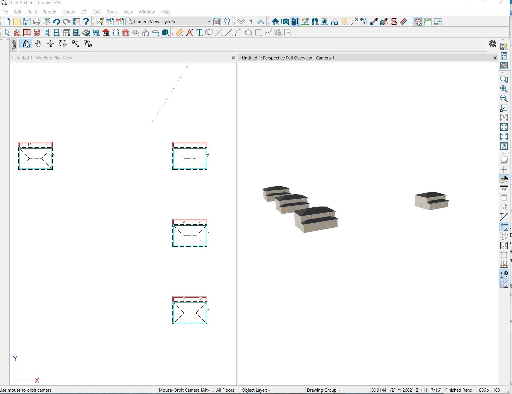

DHerb2014 Posted January 14 Share Posted January 14 Is there a setting that anchors the entire house together from foundation, first/second floors? Attaching the screen shots for your use. When I moved the first floor (marque and move -200' for example), it moves it perfectly. When I select the second floor, it shows the original view but did not move the second floor. Hoping someone has a quick solution to this. Thanks in advance. I can't attach the actual model, as it's 41 MB and too large to send. Link to comment Share on other sites More sharing options...

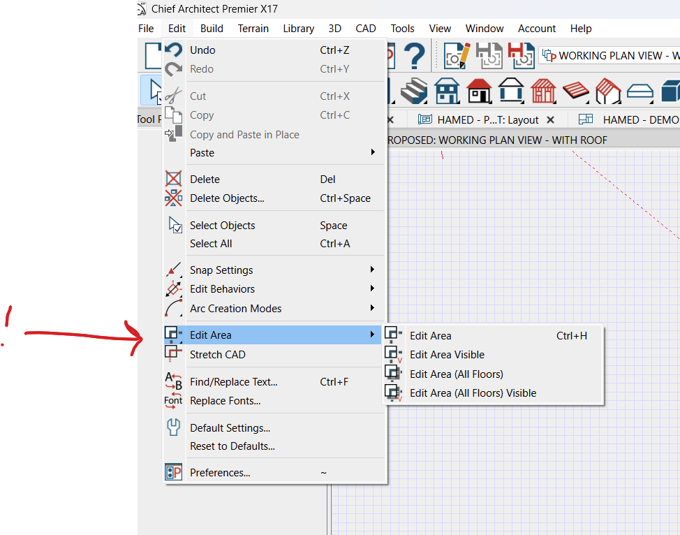

JKEdmo Posted January 14 Share Posted January 14 17 minutes ago, DHerb2014 said: Is there a setting that anchors the entire house together from foundation, first/second floors? Attaching the screen shots for your use. When I moved the first floor (marque and move -200' for example), it moves it perfectly. When I select the second floor, it shows the original view but did not move the second floor. Hoping someone has a quick solution to this. Thanks in advance. I can't attach the actual model, as it's 41 MB and too large to send. I think you're looking for the Edit Area tools. Read up on this in the Help section. The tool is very useful. - Jim 1 Link to comment Share on other sites More sharing options...

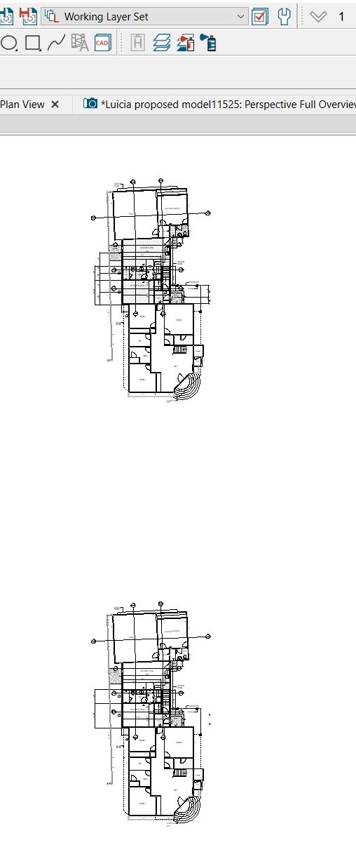

DHerb2014 Posted January 15 Author Share Posted January 15 Many, many thanks for your comment! It worked. Solution is: 1. Marque select entire floor plan you wish to move 2. Select Edit (from top task bar) and select "Edit Area / Edit Area (All Floors) 3. Marque select floor plan again and hit Hot Key "T" for Transform/Replicate and select Copy,Move, then select the X or Y coordinates where you wish to locate it 4. Click OK and all floors are moved together. Double check by selecting the next floor above or below to make sure everything has moved Chief Users are awesome! Link to comment Share on other sites More sharing options...
Chrisb222 Posted January 15 Share Posted January 15 10 hours ago, DHerb2014 said: Many, many thanks for your comment! It worked. Solution is: 1. Marque select entire floor plan you wish to move 2. Select Edit (from top task bar) and select "Edit Area / Edit Area (All Floors) 3. Marque select floor plan again and hit Hot Key "T" for Transform/Replicate and select Copy,Move, then select the X or Y coordinates where you wish to locate it 4. Click OK and all floors are moved together. Double check by selecting the next floor above or below to make sure everything has moved You can skip step 1. Link to comment Share on other sites More sharing options...
Renerabbitt Posted January 15 Share Posted January 15 17 hours ago, DHerb2014 said: 1. Marque select entire floor plan you wish to move 2. Select Edit (from top task bar) and select "Edit Area / Edit Area (All Floors) 3. Marque select floor plan again and hit Hot Key "T" for Transform/Replicate and select Copy,Move, then select the X or Y coordinates where you wish to locate it 4. Click OK and all floors are moved together. Double check by selecting the next floor above or below to make sure everything has moved Edit/Edit Area (All Floors) Draw A Marquee around all elements you intend to move Either use transform replicate or start dragging the center handle of your marquee and hit tab to enter coordinates Link to comment Share on other sites More sharing options...
