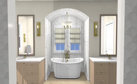

blueriver Posted December 17, 2025 Share Posted December 17, 2025 Hi! Can someone offer advice on possibly picture settings? When taking a picture with the full camera and then saving it - the saved image is very condensed left to right. The picture that saves is not the same as what's on my screen - everything looks very squished. Help! Lauren running x14 THANK YOU IN ADVANCE! Link to comment Share on other sites More sharing options...

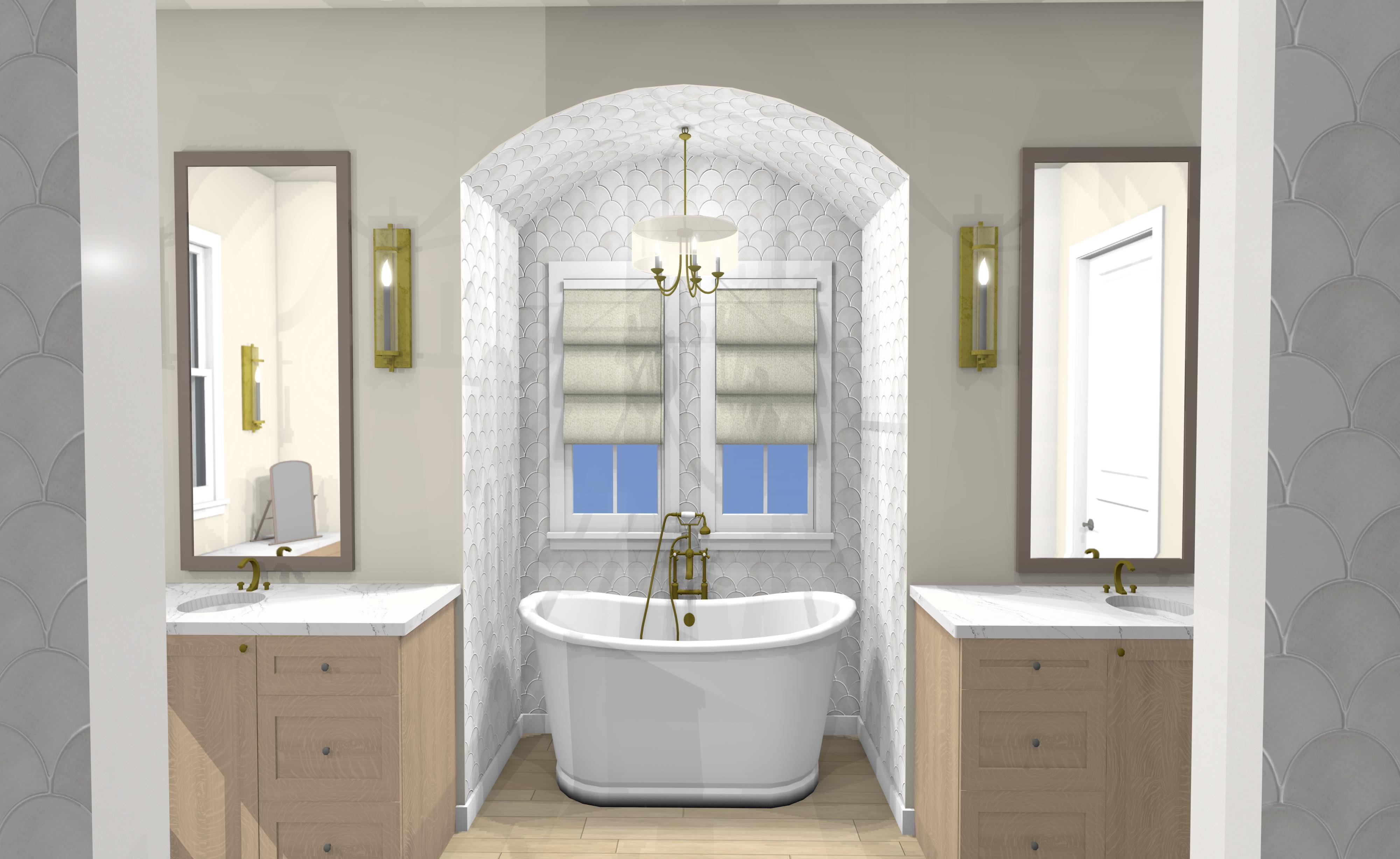

blueriver Posted December 18, 2025 Author Share Posted December 18, 2025 Like this bathtub picture - this bathtub is 6foot, but my picture makes it look like it's only 4 feet! Any ideas what i have going on here? Link to comment Share on other sites More sharing options...
DBCooper Posted December 18, 2025 Share Posted December 18, 2025 (edited) Are you using the "export picture" tool? Do you have "retain aspect ratio" checked? I think if you don't have retain aspect ratio, and you turn off "use active window size", you can accidently squish or stretch the picture. If you need the image to be a different aspect ratio, then either set your window size first or edit the picture in a photoshop type program to crop it after exporting it. Edited December 18, 2025 by DBCooper Link to comment Share on other sites More sharing options...
Joe_Carrick Posted December 19, 2025 Share Posted December 19, 2025 I would use the Window Snipping Tool to create the picture. 1 1 Link to comment Share on other sites More sharing options...
