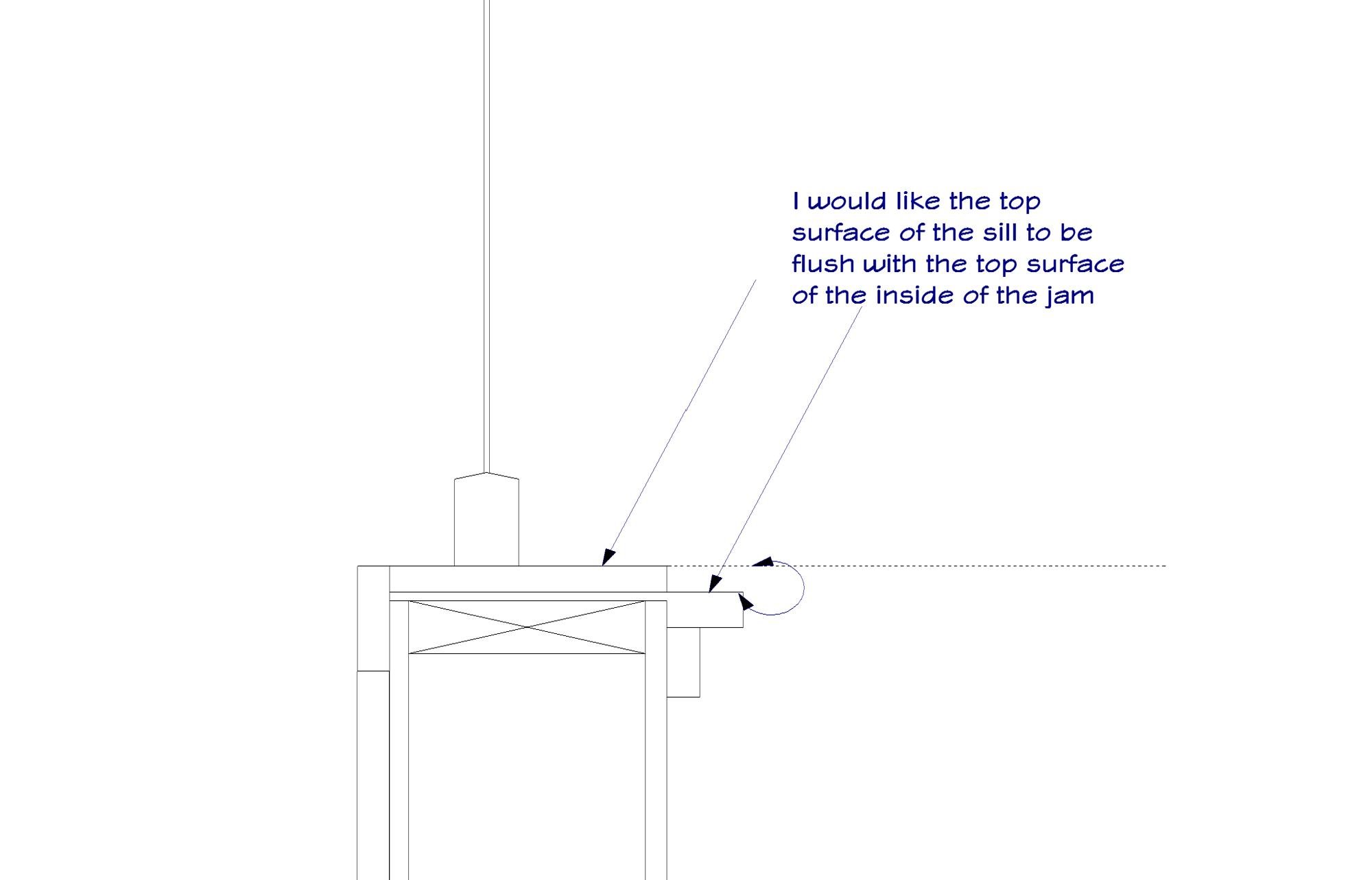

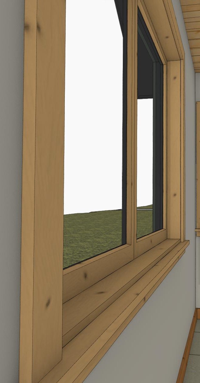

MN_JohnH Posted December 9 Share Posted December 9 I am wondering if there is a way to raise up the window sill on the interior? We like to make the top of the window sill flush with the top of the inside of the bottom jamb so it becomes all one level, without that step shown here. Link to comment Share on other sites More sharing options...
GaryOhmer Posted December 9 Share Posted December 9 To make it look right window size excludes frame, I assume your including the frame 1 Link to comment Share on other sites More sharing options...
MN_JohnH Posted December 9 Author Share Posted December 9 8 minutes ago, GaryOhmer said: To make it look right window size excludes frame, I assume your including the frame Wow, yes that works. Seems a bit silly but OK. I just have to go through and change all my window sizes so the ROs are right. But at least I know it can be done for the future. Thanks! Link to comment Share on other sites More sharing options...
