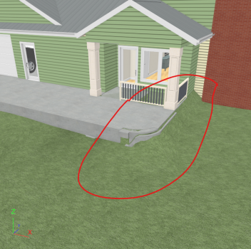

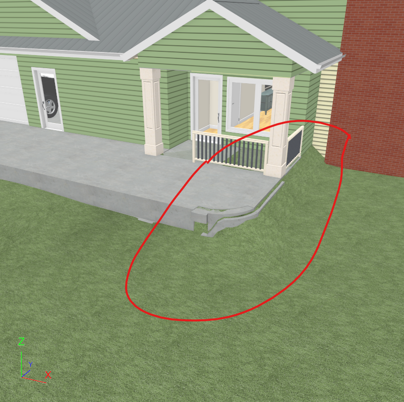

DenisonDrywall Posted November 20, 2025 Share Posted November 20, 2025 Why does it keep giving me a hill here when all the elevations lines to the right of the porch are set to the same of -1'9"? If I move the elevation line right up next to the porch and elevation region, it makes it worse. I don't understand as to why its putting in extra contour lines everywhere. Thanks, Jennifer 225-0292 Olson, Steve - opt 1C.zip Link to comment Share on other sites More sharing options...
Mark3D Posted November 20, 2025 Share Posted November 20, 2025 Try this file you need to keep elevation data seperate not touching or overlapping its not perfect but get you moving in the right direction 225-0292 Olson, Steve - opt 1C mark edit.zip Link to comment Share on other sites More sharing options...

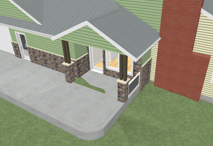

DenisonDrywall Posted November 20, 2025 Author Share Posted November 20, 2025 Thank you so much! Now if i can only figure out why its putting grass in the porch. but that's minor compared to what i was fighting. So the elevation lines can't touch each other? Link to comment Share on other sites More sharing options...
DBCooper Posted November 20, 2025 Share Posted November 20, 2025 Chief doesn't cutout terrain for porches and decks. You can add a manual terrain hole or use the "make terrain hole around building" tool and then edit the shape to go around the porch. Link to comment Share on other sites More sharing options...
Chief_Trent Posted November 21, 2025 Share Posted November 21, 2025 2 hours ago, DenisonDrywall said: So the elevation lines can't touch each other? If you have overlapping elevation lines, you're telling the program "make the height at this spot both the height of line 1 and the height of line 2." If those heights are different, Chief has to figure out how to make one location have two different heights, which isn't physically possible, and causes some issues. Link to comment Share on other sites More sharing options...
