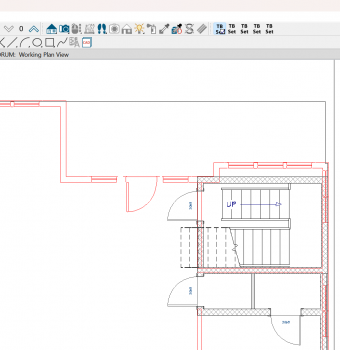

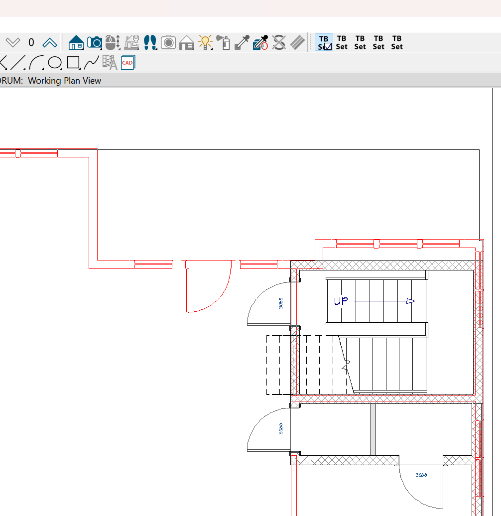

Evolution Posted November 20 Share Posted November 20 I always seem to have trouble with stairs. I start on the ground floor drawing a U-shape stair clockwise, or at the tope counter clockwise but no matter what, the landing is never located properly, and even when I select make it fit or reach the floor it just doesn't seem to work for me. Help please point me in the right direction. Yes, I watched the stair video on the Bachelor View project and THOUGHT I was following the directions, but I can't get the stairs to even come close to building correctly. Cut to the chase I need help and the video didn't provide it or I didn't understand exactly the correct use of the stair tools. The snips are of the stair starting from the lowest floor "U-shaped" clockwise. COASTAL RESIDENCE FOR CECIL and HELEN WILLIAMS for CHIEF TALK FORUM.zip Link to comment Share on other sites More sharing options...

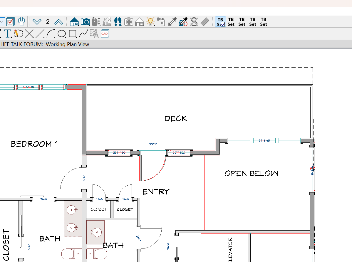

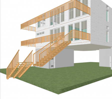

Evolution Posted November 20 Author Share Posted November 20 UPDATE: i can't even get the stair tool to work for the deck's? Another thing, I have the decks designated as Decks, but the platform is missing. If I change them back to a room a floor appears for each. Again, what am I missing from a tool standpoint to show the deck platform? Link to comment Share on other sites More sharing options...
GaryOhmer Posted November 20 Share Posted November 20 rebuild the deck framing Link to comment Share on other sites More sharing options...
DBCooper Posted November 20 Share Posted November 20 (edited) You turned off "auto adjust height" for your landing and set the height to -72". This means the landing height is now fixed in space at that height. Once you do this the stair sections above and below the landing will operate somewhat independently from each other. Your stairs above the landing are too long and overlapping your floor platform. You should be able to pull this stair back to the edge of floor platform and they should work ok. Your stairs below the landing will either need more steps to go from the floor to the landing or they will need to have much larger riser heights. Not a lot of room between the door and the start of the stair either. Not sure if you actually have enough space in that room to build a stair that will go up 12' and still meet code. Edited November 20 by DBCooper 1 Link to comment Share on other sites More sharing options...
Solution DBCooper Posted November 20 Solution Share Posted November 20 (edited) Rebuilding the deck framing will only rebuild the planks because your deck joists are set to 0" thickness. Edited November 20 by DBCooper 1 Link to comment Share on other sites More sharing options...
