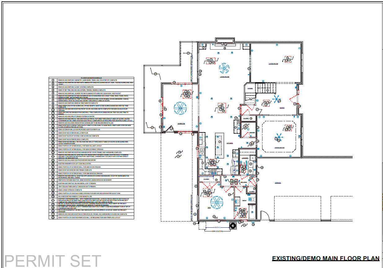

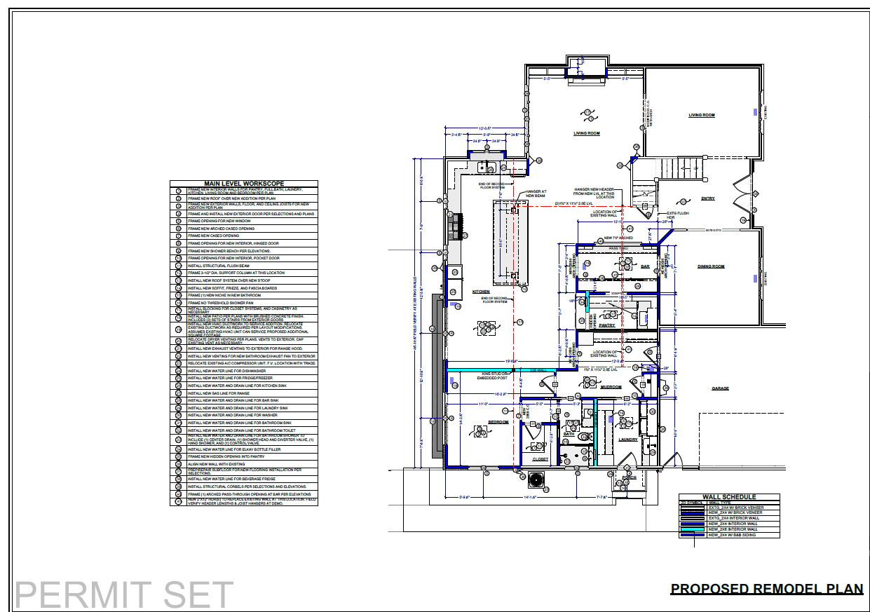

Ringos Posted October 21, 2025 Share Posted October 21, 2025 Trying to stay up-to-date on best practices. Chief makes a video of a process but then I don't ever see an update for years. I am wondering if there is any new developments in the chief program that makes this better? I've been using this as-built to demo to new construction method https://www.chiefarchitect.com/videos/watch/9867/remodel-process.html Which is creating the as-built, then duplicating that and continuing to develop the demo and new construction, then overlaying the as-built on the remodel. What has been the best for others? 1 Link to comment Share on other sites More sharing options...

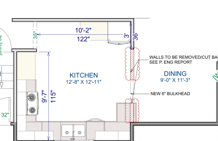

SHCanada2 Posted October 22, 2025 Share Posted October 22, 2025 for complicated ones, that is what I do. For just removing a wall, I hatch a polyline over the wall and note it as being removed Link to comment Share on other sites More sharing options...
Ringos Posted October 22, 2025 Author Share Posted October 22, 2025 SHCanada. When you hatch over a wall, it is not removed, right? So it still shows up on elevations and renderings? Link to comment Share on other sites More sharing options...
Renerabbitt Posted October 22, 2025 Share Posted October 22, 2025 I find that I very rarely need a separate as-built file from a demo file, the two can be one in the same for most JAH across the country Link to comment Share on other sites More sharing options...
Ringos Posted October 22, 2025 Author Share Posted October 22, 2025 Renerabbitt So how do you do it? Link to comment Share on other sites More sharing options...
SHCanada2 Posted October 22, 2025 Share Posted October 22, 2025 (edited) 2 hours ago, Ringos said: SHCanada. When you hatch over a wall, it is not removed, right? So it still shows up on elevations and renderings? I remove the wall or portion thereof if I am going to render(sometimes it is just a wall in a closet or bathroom or in a hall, which may not get rendered, so the wall does not need actually be removed), and just leave the hatched polyline on the plan view. I dont do as built renders, only proposed. Below is walls cut back, and pline left in its place, as there were renders showing the dining from the kitchen Edited October 22, 2025 by SHCanada2 Link to comment Share on other sites More sharing options...
Ringos Posted October 22, 2025 Author Share Posted October 22, 2025 Shcanada. Thank you. Are you just using cad box with hatching then instead of the wall hatch tool? Link to comment Share on other sites More sharing options...
SHCanada2 Posted October 22, 2025 Share Posted October 22, 2025 2 minutes ago, Ringos said: Are you just using cad box with hatching then instead of the wall hatch tool? exactly. I pick which one to use depending on it it matters if there is still a "wall" there or not. For the wall hatching tool, if you want only part of the wall, you have to break up the wall, just as aa FYI Link to comment Share on other sites More sharing options...
Ringos Posted October 22, 2025 Author Share Posted October 22, 2025 I liked the ease of using the wall hatching tool, but I don't see there is a way to leave the hatching and remove the wall. Super helpful, thank you. Link to comment Share on other sites More sharing options...
joey_martin Posted October 23, 2025 Share Posted October 23, 2025 Draw your existing plan, Save As to create your proposed plan, once you have everything designed and client approved, go back and make your existing plan the EXTG/DEMO Plan. 1 Link to comment Share on other sites More sharing options...
SHCanada2 Posted October 23, 2025 Share Posted October 23, 2025 4 hours ago, Ringos said: I liked the ease of using the wall hatching tool, but I don't see there is a way to leave the hatching and remove the wall. never tried that Link to comment Share on other sites More sharing options...
Ringos Posted October 23, 2025 Author Share Posted October 23, 2025 Thanks Joey. Then there must be a way to reference both of them in layout? Link to comment Share on other sites More sharing options...
joey_martin Posted October 23, 2025 Share Posted October 23, 2025 2 minutes ago, Ringos said: Thanks Joey. Then there must be a way to reference both of them in layout? Yep. No limit to the number of plan files in your layouts. Link to comment Share on other sites More sharing options...
