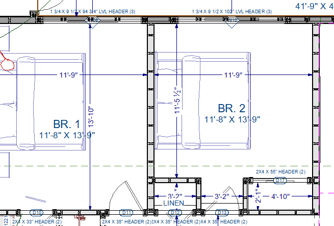

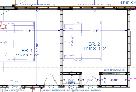

I'm dimensioning wall frame elevations for a job that will be panelized.  Take a look at this segment of the plan.  The two walls I'll discuss here are the 2x6 ones that are on both sides of bedroom 2.

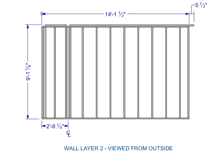

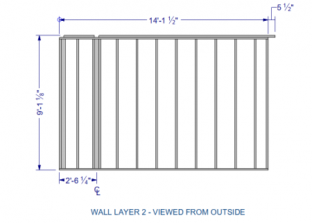

Here is the left one.  All walls have a "front" side, even interior walls like these, and the framing view that comes up when selected, is the view from the front.  For this one, I can use the end to end dimensioning tool.

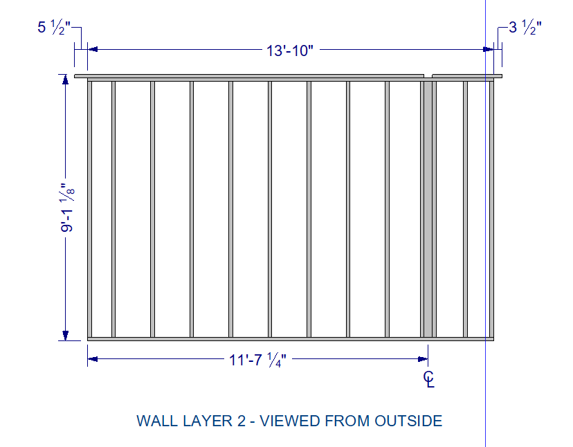

Here is the right one.  Again, this wall is viewed from its "outside."  End to end dimensioning won't work on this one, so I used point to point.
So, why this behavior, end to end only working on some elevations, but not others?

Hi Gene, did you confirm that both  views were using the same set of defaults? Perhaps one view had a default set where the end-to-end locate settings don't pickup framing or cad...
