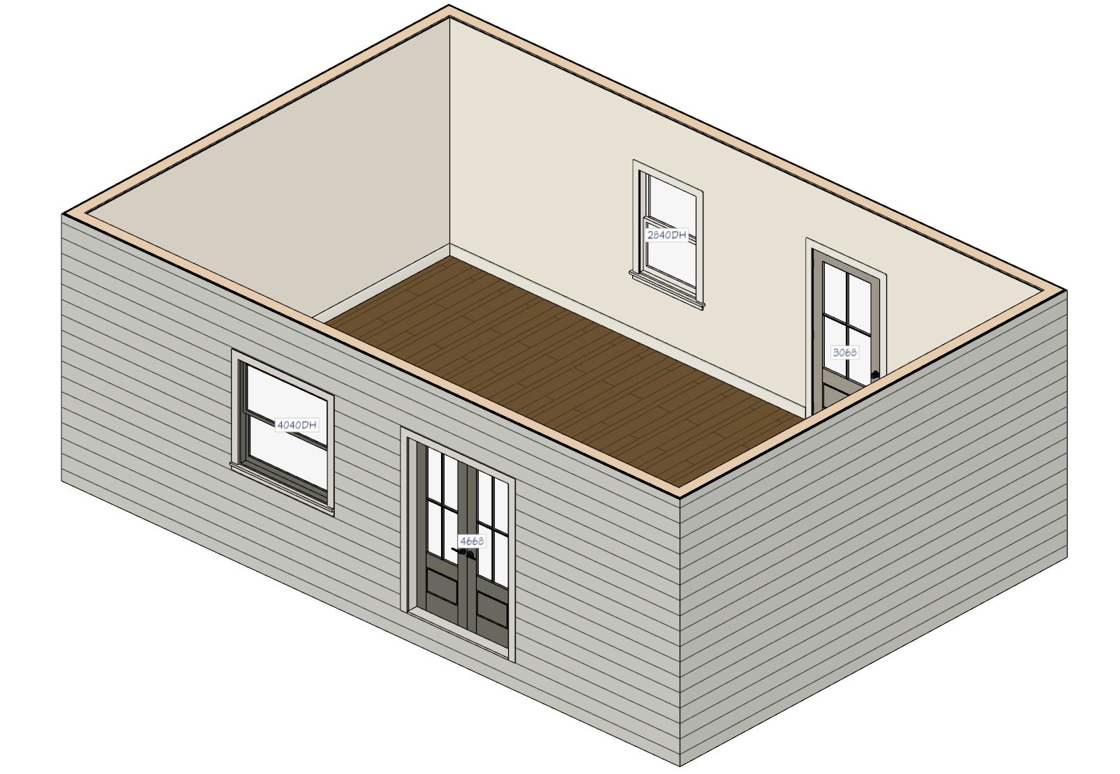

Renerabbitt Posted October 17 Share Posted October 17 This image shows where the label is but no information is populating Link to comment Share on other sites More sharing options...

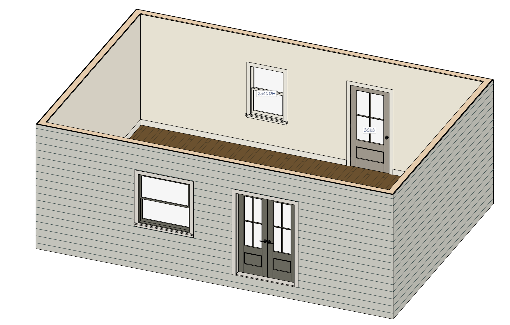

DBCooper Posted October 17 Share Posted October 17 I am guessing that you are using a cross section slider. As far as I can tell, any labels outside of the cutting plane will also get cut out. Could also be a problem with what side of the wall you are looking at. I have noticed that window and door labels will only show up on one side of a wall by default. Haven't played around with it enough yet to see if there is a way to control this though. Link to comment Share on other sites More sharing options...
Renerabbitt Posted October 17 Author Share Posted October 17 (edited) 9 minutes ago, DBCooper said: I am guessing that you are using a cross section slider. As far as I can tell, any labels outside of the cutting plane will also get cut out. Could also be a problem with what side of the wall you are looking at. I have noticed that window and door labels will only show up on one side of a wall by default. Haven't played around with it enough yet to see if there is a way to control this though. even when I turn it off they dont show. if you switch to text labels do they show for you? im in orthographic with standard view with line over. Its only on windows. doors show correctly Edited October 17 by Renerabbitt Link to comment Share on other sites More sharing options...
DBCooper Posted October 17 Share Posted October 17 Seems to be a bit flaky to me. I was noticing that they changed depending on my camera angle. I was able to get better results by going to the label page and checking "show in this view" to force them on. Not sure if they work different depending on the render technique though. Link to comment Share on other sites More sharing options...
robdyck Posted October 18 Share Posted October 18 I can confirm that (on my system as well) the appearance of labels in 3d views, specifically windows and doors, is not working properly...not even close. Link to comment Share on other sites More sharing options...
