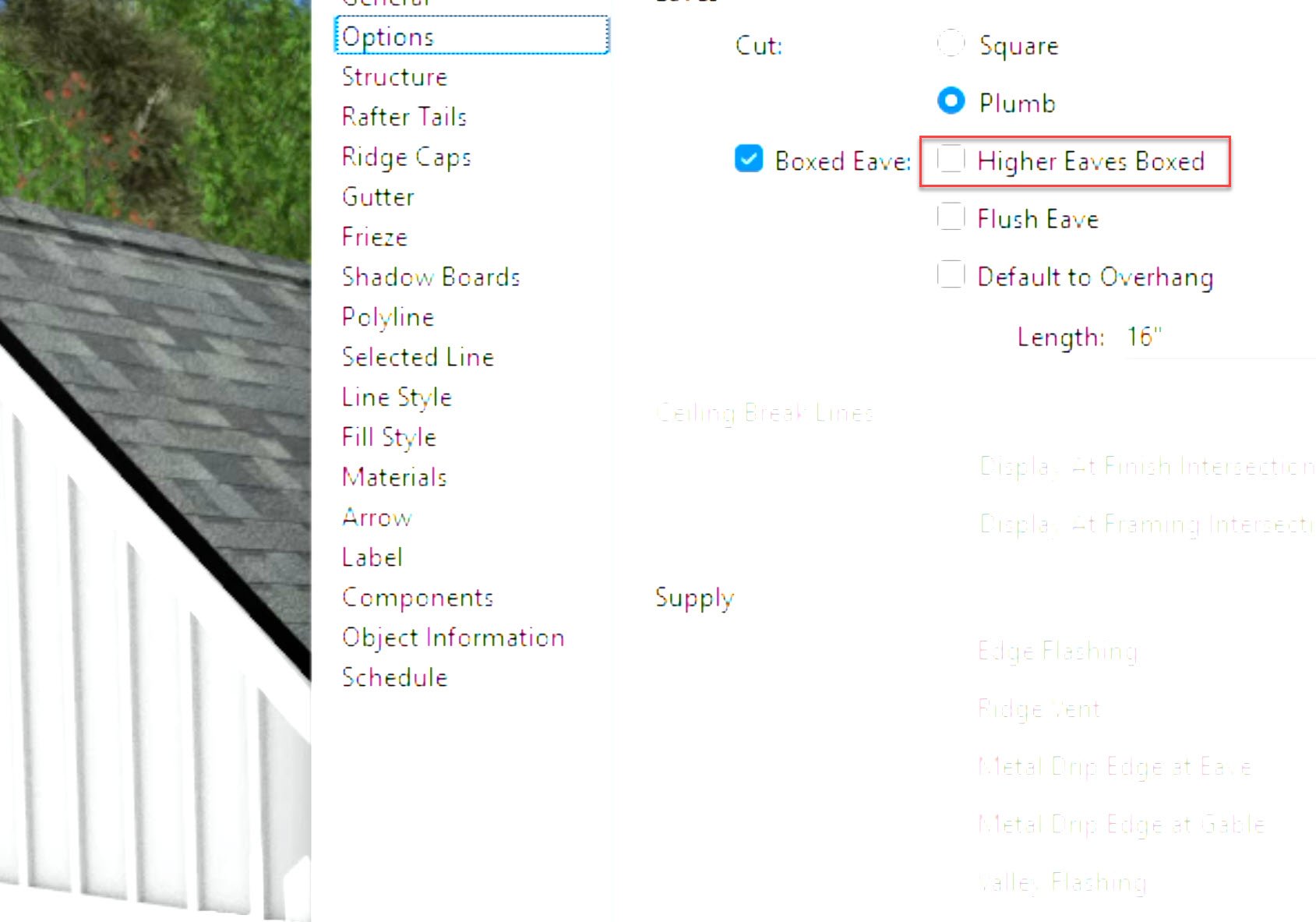

mtldesigns Posted September 26, 2025 Share Posted September 26, 2025 (edited) Latest project is to add 20' to the rear of this existing shotgun style house for a master bedroom. In the video I highlight the existing roof and the new.. when I grab the section of the new to pull down for a little awning over the slider, the eave on the existing and new change, even though the settings do not. Not finding a way to put the eave back to what their supposed to be. Any ideas? Should this little awning be its own roof pane? Recording 2025-09-25 215433.mp4 Edited September 26, 2025 by mtldesigns Link to comment Share on other sites More sharing options...

Solution JiAngelo Posted September 26, 2025 Solution Share Posted September 26, 2025 Check "Higher Eaves Boxed" in your roof dialog and that will fix your issue. Your extension becomes the lowest eave on that side of the building. 1 Link to comment Share on other sites More sharing options...

mtldesigns Posted September 26, 2025 Author Share Posted September 26, 2025 11 hours ago, JiAngelo said: Check "Higher Eaves Boxed" in your roof dialog and that will fix your issue Thanks, that worked. Curious though on why both roof planes changes that eave when I only modified one? This is something I will note, since the I won't be doing that lower eave after all. It was tough for me to give you the "solution" John, since I am from the state to the north.. but live in FL. (don't tell my fam) Go Blue. 18 hours ago, mthd97 said: Been to Tampa and there about in 99. Nice place It is nice, daughter lives there now. I'd love to visit Australia but the worlds most deadliest anything (animals on land and the sea) are down that way. I'm too far north for boa's. 2 Link to comment Share on other sites More sharing options...
