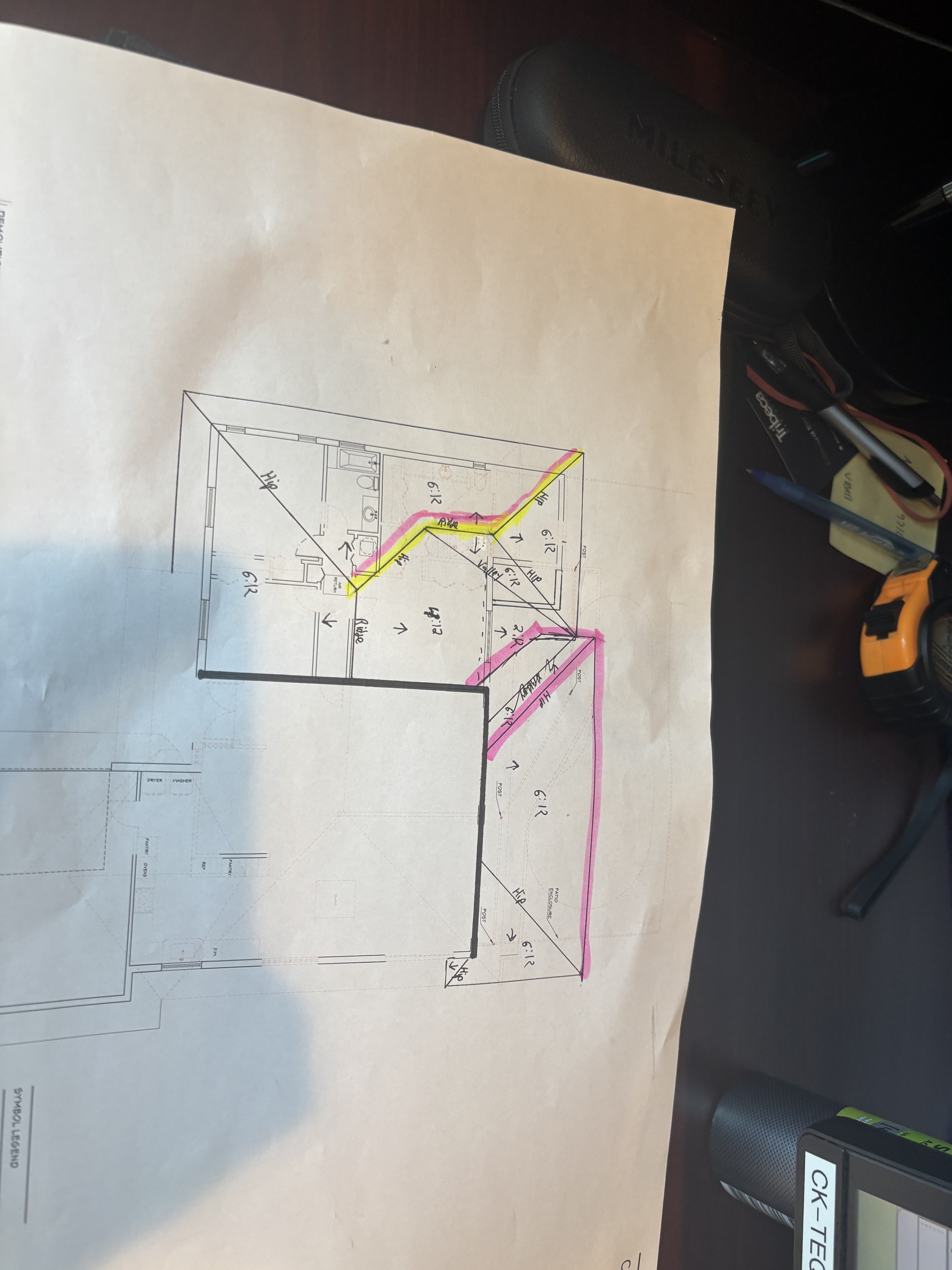

Celtic101 Posted September 8, 2025 Share Posted September 8, 2025 I am in need of some assistance drawing this roof (see attached) I am unable to get this correct. I also am a new user Link to comment Share on other sites More sharing options...

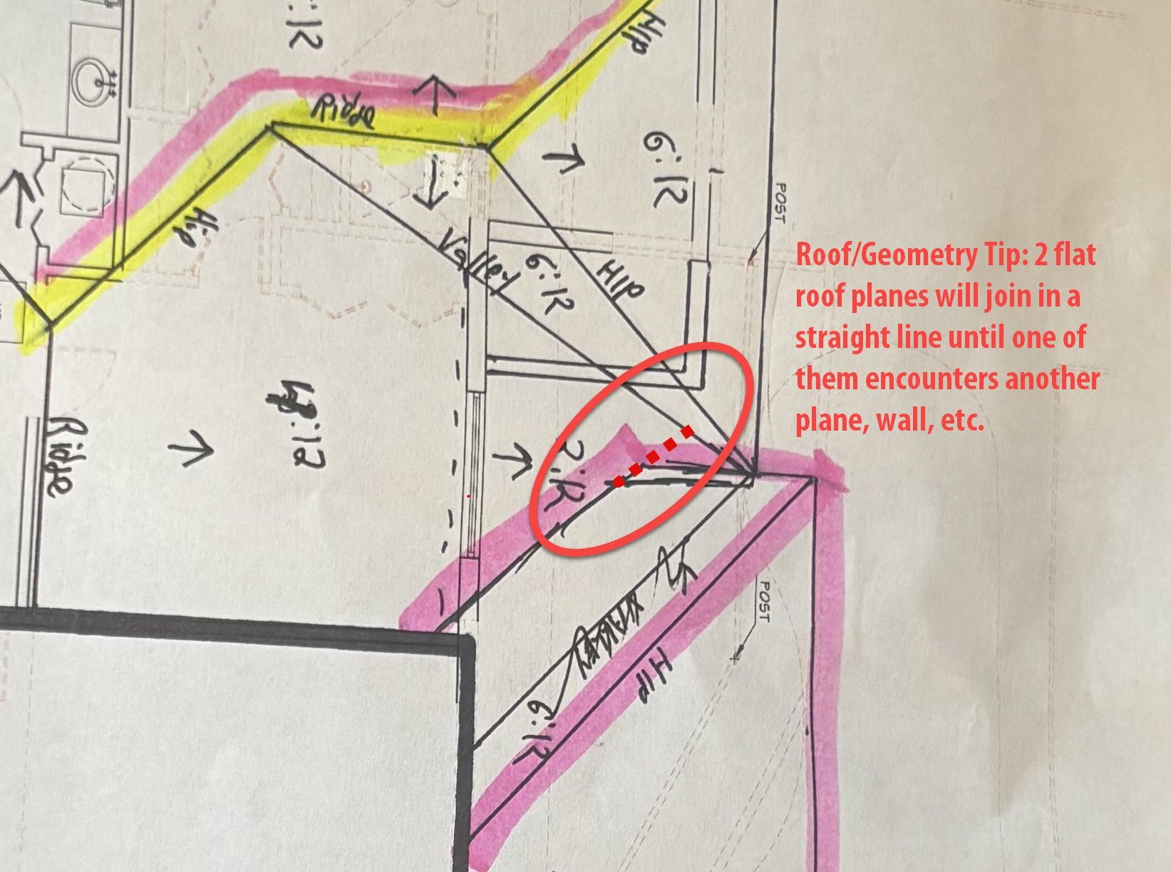

mthd97 Posted September 9, 2025 Share Posted September 9, 2025 Hi @Celtic101, you have a valley meeting directly into a hip corner. That is not common practice because there is not enough room for the valley gutter to be installed. It would be advisable to push that small hip end out enough so the valley gutter fits in correctly. Next you would need to show the heights of those two roof sections that have drawn. Elevations would help. You may consider making it into one combined roof if they are at the same height level too ? It is up to the designer to know how to build a roof correctly, if not then employ a professional to help do that for you. Then look at modeling it in Chief Architect. Link to comment Share on other sites More sharing options...

mthd97 Posted September 10, 2025 Share Posted September 10, 2025 (edited) 12 hours ago, Celtic101 said: @mthd97so you are saying that the design is impossible if not next to impossible to create in chief? No not at all becuase it has nothing to do with the software but the layout of the roof design itself. Those two roofs should only join at a common gutter that is able to accommodate the water flow area of both roofs, if they are at the same gutter level of course. So first adjust the roof layout accordingly is what I am saying so that it all works. If you can’t figure it out on your own then please ask a roof builder. We are not obligated to support roof construction theory here but on how to use the software to construct a 3D model of the roof that is actually workable in practice and complies to building regulations. Edit: Need to consider how much space you have left to adjust the roof layout appropriately. The height level of both roofs. Then the precipitation loads applicable in your region. By no means impossible to achieve with a bit of tweaking here and there. Then after that we can show you how to build a realistic roof layout in 3D with Chief Architect. Enjoy the process ! Edited September 10, 2025 by mthd97 1 Link to comment Share on other sites More sharing options...
