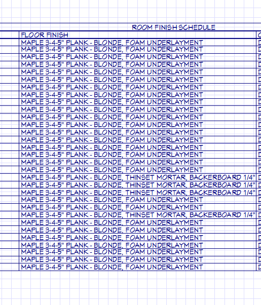

winterdd Posted August 18, 2025 Share Posted August 18, 2025 Hey Guys, how can I rename this on my schedule to something more simple? Link to comment Share on other sites More sharing options...
HetrickDesign Posted August 18, 2025 Share Posted August 18, 2025 (edited) What I do is create my own material, rename it and save it to my library. Then use that material. Edited August 18, 2025 by HetrickDesign 1 2 Link to comment Share on other sites More sharing options...

winterdd Posted August 19, 2025 Author Share Posted August 19, 2025 12 hours ago, HetrickDesign said: What I do is create my own material, rename it and save it to my library. Then use that material. What are the steps on that? I already tried and had no luck. Link to comment Share on other sites More sharing options...
GeneDavis Posted August 19, 2025 Share Posted August 19, 2025 3D > Materials > Plan Materials, select the floor finish you want to rename, copy it to make a new material, call it whatever you want, maybe ROB 3-4-5, and then change the rooms to have the new shorter-name flooring, which will look the same as the one you copied. 1 Link to comment Share on other sites More sharing options...
winterdd Posted August 19, 2025 Author Share Posted August 19, 2025 6 minutes ago, GeneDavis said: 3D > Materials > Plan Materials, select the floor finish you want to rename, copy it to make a new material, call it whatever you want, maybe ROB 3-4-5, and then change the rooms to have the new shorter-name flooring, which will look the same as the one you copied. Thanks Gene......I was way off. Funny thing is I was able to go into the room dbx and change the molding names easily. 1 Link to comment Share on other sites More sharing options...
