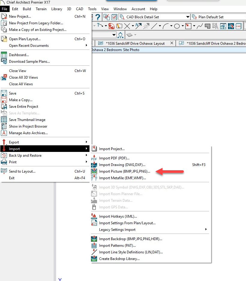

GeneDavis Posted August 4, 2025 Share Posted August 4, 2025 Before 17 I sent any pics or screencaps I wanted to use, to my project folder created by me. It was easy to email images to clients, and easy to import pics to layout. I cannot see how to import the pics in the project to layout. What is the secret? Link to comment Share on other sites More sharing options...
Doug_N Posted August 5, 2025 Share Posted August 5, 2025 Gene, Same as before but the location of the source file is outside of the CA project manager. This means that there needs to be a file system separate from CA that stores images, cad files etc for insertion. I think CA needs to move this into the project manager, and if there is a way now, I don't know it. Link to comment Share on other sites More sharing options...

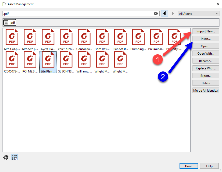

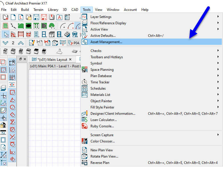

ComputerMaster86 Posted August 5, 2025 Share Posted August 5, 2025 Currently if you are using "Managed Mode" Chief Architect will not let you import PDF files, images, DWG's, etc. into your plan or layout file that are stored within a project. I have complained about this on the forum and requested that chief allow us to import things that are stored in our projects. If you import the item into the "Asset Manager" first, you can insert from the "Asset Manager" into a plan or layout file. Link to comment Share on other sites More sharing options...
