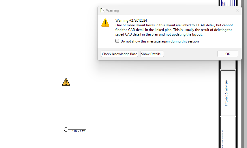

Ed_Orum Posted July 21, 2025 Share Posted July 21, 2025 I have created a layout file which I want to use as a template for future layouts. When I open this layout file, I get a "Warning # 272012024 One or more layout boxes in this layout are linked to a Cad detail, but cannot find the CAD detail in the linked plan." How do I find which is the missing CAD detail in the layout? Thanks, Lane Link to comment Share on other sites More sharing options...
robdyck Posted July 21, 2025 Share Posted July 21, 2025 Open the layout box and review the Linked View. That should point you in the right direction to either relink the view or remove that layout box from your layout page. You can also copy the missing cad detail to the linked plan and then relink that layout box. 1 Link to comment Share on other sites More sharing options...
rlackore Posted July 22, 2025 Share Posted July 22, 2025 That warning doesn't help you find the specific Layout Box that contains the missing detail that is throwing the error. Remember to turn "on" the Layout Box Borders layer, then page through the Layout to find any "empty" layout boxes. Link to comment Share on other sites More sharing options...
CarrieS Posted July 22, 2025 Share Posted July 22, 2025 Layout boxes that have missing references should show a caution triangle. So you should just have to page through your layout looking for the triangle. Once you find the layout box you can delete it or relink it to what you need it to point to. 1 1 Link to comment Share on other sites More sharing options...
