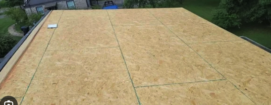

PitMan71 Posted April 17, 2025 Share Posted April 17, 2025 Is there a way to have chief display or generate roof decking pattern? Ultimately I would like to see a layout with quantity. I have done some searching on this and I am not finding anything. Thanks Link to comment Share on other sites More sharing options...
VHampton Posted April 17, 2025 Share Posted April 17, 2025 Not sure if your question is regarding a visual for the structure or the finished deck area. If for the structure... use a grid pattern w/ an offset. Set the size to 48" x 96". This is typically how roof sheathing (decking) is laid out. In a grid pattern. If on the other hand this is for illustrating deck boards... 3-1/2" wide hatch can be used or 5/4 x 4 ....or 5-1/2" wide hatch for 5/4 x 6. Apologies if this response is stating the obvious. One only needs to make a poly-line in order to create the skin to represent the roof surface. That poly-line can be given a label which indicates the precise surface area. 1 Link to comment Share on other sites More sharing options...
para-CAD Posted April 18, 2025 Share Posted April 18, 2025 So far as I can tell you can create a schedule to show the square footage of each roof plane and then divide that by 32 to get number of sheets. It would be a cool feature if that was built in to the material master list and you could add a value of 15% for waste 1 Link to comment Share on other sites More sharing options...
PitMan71 Posted April 18, 2025 Author Share Posted April 18, 2025 15 hours ago, VHampton said: If for the structure... use a grid pattern w/ an offset. Set the size to 48" x 96". This is typically how roof sheathing (decking) is laid out. In a grid pattern. Yes.... I was referring to plywood decking on the roof and subfloor. I would like to see a plywood decking layout with a quantity. Common takeoff methods are to calculate the roof area and divide by 32.... it would great though is the program actually placed the plywood on the roof in a way that could be displayed showing takeoff quantity is accurate with whole pieces and cut pieces. Sounds like it may be a good enhancement request. Link to comment Share on other sites More sharing options...
Chrisb222 Posted April 18, 2025 Share Posted April 18, 2025 2 hours ago, PitMan71 said: it would great though is the program actually placed the plywood on the roof in a way that could be displayed Not sure exactly what you're after, but if it's just a visual of the plywood in 3D and you can calculate the qty another way, that's easily doable: Change your OSB material to have an offset grid, then in a 3D view use the Delete Surface tool (3D > Delete Surface) to temporarily remove the surface material (which doesn't truly delete it, it regenerates automatically). 1 Link to comment Share on other sites More sharing options...
