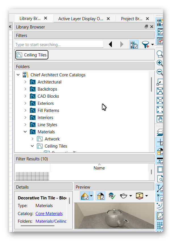

CADustin Posted July 2, 2024 Share Posted July 2, 2024 I just added a stamped tin folder to core in X16 in the last update. I know you said you were on X13, but it's there waiting for you if you ever make the jump to X16+. One thing you can also try is just adding a normal map of any pattern you want onto a tin metal material. Just poking around on Google, you can find some decent looking stuff and apply it to a metal material in Chief, See image. Link to comment Share on other sites More sharing options...
francyt Posted October 22, 2025 Share Posted October 22, 2025 I have 16. How can I access this? Link to comment Share on other sites More sharing options...
Mark3D Posted October 22, 2025 Share Posted October 22, 2025 Its in your library Link to comment Share on other sites More sharing options...
CADustin Posted October 22, 2025 Share Posted October 22, 2025 Yep yep, should just be in your core materials folder. Let me know if you don't have access to it and we'll get it figured out. Link to comment Share on other sites More sharing options...
