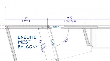

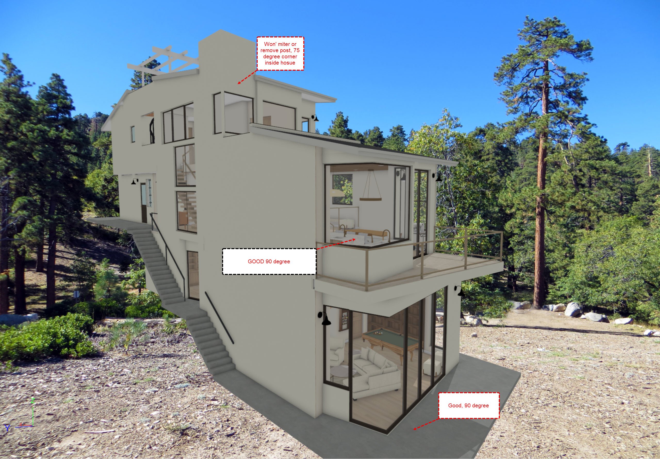

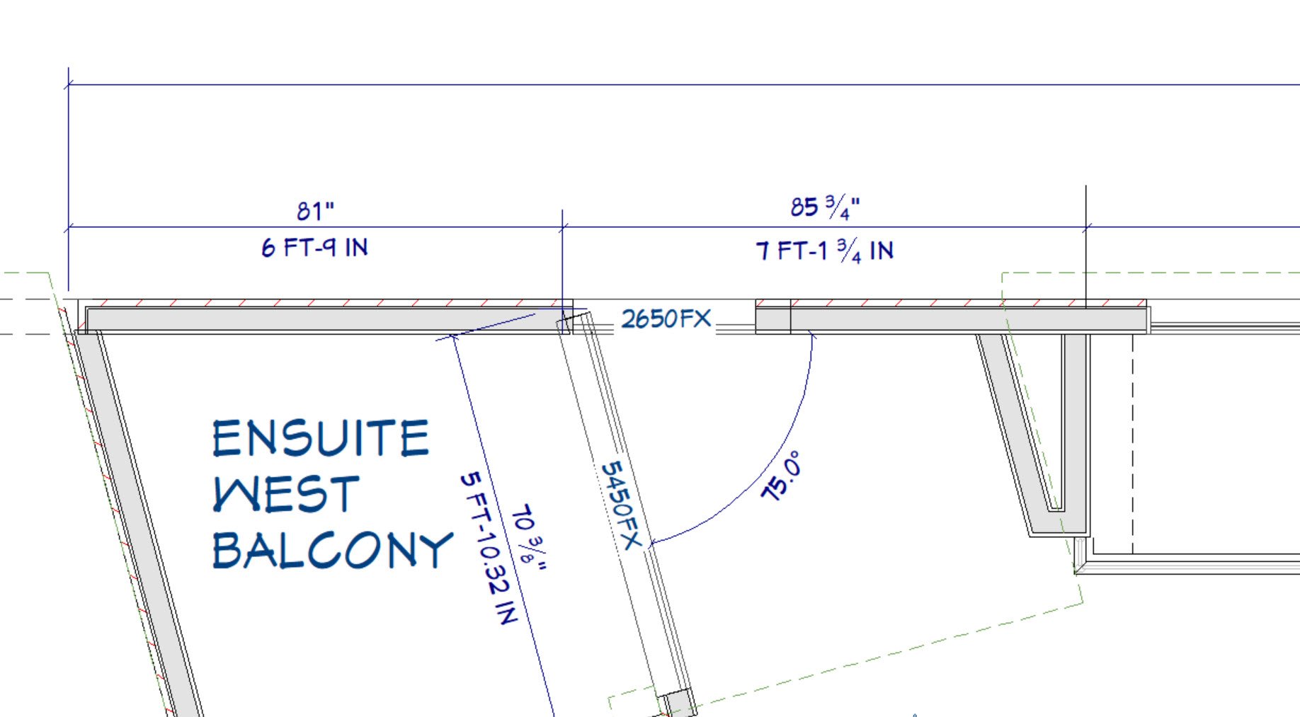

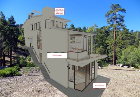

raltd9245 Posted April 5, 2023 Share Posted April 5, 2023 I'm having trouble making a butt joint corner window . I get a post don't want it. HELP!!! Link to comment Share on other sites More sharing options...
GeneDavis Posted April 5, 2023 Share Posted April 5, 2023 Drag its edge way in there. Don't be shy. You're the boss. Then call the engineer and tell her what you did. 1 Link to comment Share on other sites More sharing options...
VHampton Posted April 5, 2023 Share Posted April 5, 2023 Click on the windows. Go to frame. Uncheck corner post. Do this on both windows. It will disappear. I make many of these, and understand your frustration. Make sure that each window has been pushed far to the corner of the structure. You can do this in plan or in 3D. 1 Link to comment Share on other sites More sharing options...

JacobB Posted April 5, 2023 Share Posted April 5, 2023 If you're using X15, you should be able to change the default window setting to use a miter join or use the object painter to transfer that setting. Note that both windows must be a window type that can miter for the miter to be applied (Fixed, Pass-through, any Casement, Single Hung, and Single Awning). Edit: this is not a dynamic default so changing the setting in the default window will only apply to windows that you create after changing the setting. 1 hour ago, VHampton said: Uncheck corner post. Do this on both windows. In X15 it's now two radio buttons. 37 minutes ago, raltd9245 said: Chief nevedr seems to make it easy. I jusyt do not think like they do!!! There some significant changes to this setting between X14 and X15 and it should be a little easier. I have some more improvements on my list for future versions, but we'll see when I get to them. X14 This option is only enabled if the window you have selected is corner joined and is a type that can corner join. This option is disabled if multiple windows are selected, except for the case where two windows are selected and they are corner joined to each other. It is also a hard setting, meaning this setting forces a corner post or miter join. This also means that this setting can change when the window type changes. X15 This option is enabled whenever you have a window that is corner joined and is a type that can corner join. This options is also enabled for the default window when it is a type that can miter, and when multiple windows are selected and any of them would have this option enabled. It is also a soft setting, meaning that it is applied only when the situation allows a miter join. This setting can also be transferred between windows using the object painter and the style palette. 1 Link to comment Share on other sites More sharing options...

mthd97 Posted April 6, 2023 Share Posted April 6, 2023 Cheers Val For the master Chiefer above. I like diagrams to make it easier for me. JB is referring to this article. Please see the diagrams and notes in this official link below. https://www.chiefarchitect.com/support/article/KB-00673/creating-corner-windows.html All good. Link to comment Share on other sites More sharing options...
