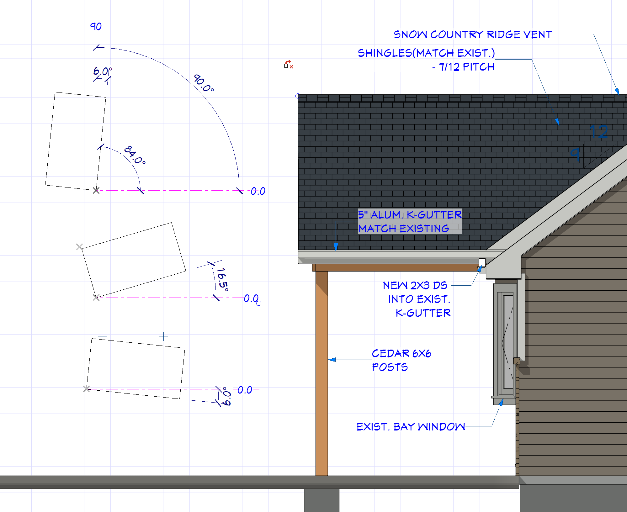

Chopsaw Posted April 6, 2022 Share Posted April 6, 2022 There is the "Rotate/Resize About Current Point" tool As well as a setting in "Transform/Replicate Object" that both use the "Current Point" that work great depending on the accuracy required. Are you sure you were using the "current" point ? That is about the only deficiency of those tools since you can't be actively using points for other things. The other option is to center your grain bin on 0,0 and rotate about that, which is possibly the way you made the bin in the first place. Link to comment Share on other sites More sharing options...

Chopsaw Posted April 6, 2022 Share Posted April 6, 2022 Link to comment Share on other sites More sharing options...
Solution glennw Posted April 6, 2022 Solution Share Posted April 6, 2022 Quote Placed a point marker in the centre of the structure Use a Place Point (a pink X) not a Point Marker (a black +) to rotate about. And make sure it is the current point. 1 Link to comment Share on other sites More sharing options...
madcowscarnival Posted April 6, 2022 Author Share Posted April 6, 2022 Excellent Glenn, the "place point" was my problem. Also, Chopsaw, thanks for the info on the transform/replicate box, that's something I don't know that I've used before. Link to comment Share on other sites More sharing options...
